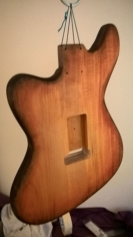

Thanks for the tip wazkelly, the colour guide in your EX-5 diary was what helped me decide on the CG/OS burst. It's a great reference. I am hesitant to use more OS. To hazard a guess, I mixed about 1 part OS to at least 10 parts MB. It's a bit hard to see with my crappy phone, but there was some bare maple on the heel after the first coat. I went over it with the second coat just to see the colour difference - and it is quite orange. I don't think I'd want any more than that.

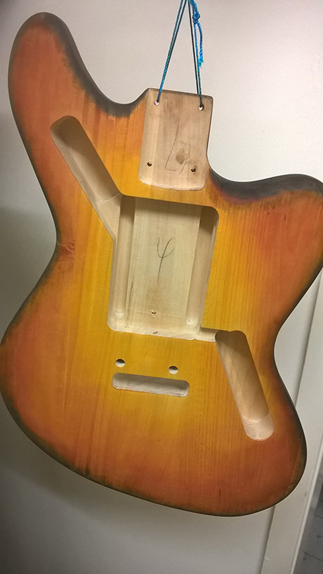

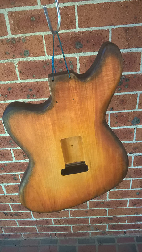

Second stain coat has gone on.
Attachment 7536 Attachment 7537

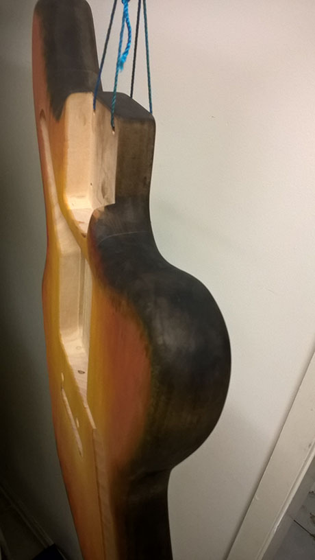

For the second coat I lightly sanded back the black edges, then started with the black. I let it dry a bit before hitting it with the orange. Unfortunately the areas that didn't take the black stain the first time around, still didn't take the second coat of stain. Still, I'm pretty happy with how it's looking.
I was thinking of painting the black edges but I'm worried it's not going to blend with what's already there - and I do like the burnt look. The other option I was thinking of was to go over the patchy black areas with the Outback Sunset to continue the burn motif. Something for next weekend.
Hey mate, I just used rattle can black (if you are clearing it make sure the paints will be compatible)
I just sprayed it directly on the sides and the overspray worked itself out to a nice consistent gradient.
