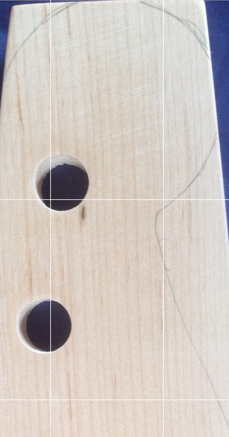

Attachment 5771Now to cut out the head shape.
looks good Tadeo, have you got a photo of the whole headstock ?
make sure you cut at least 1-2mm on the WASTE side of the line, then files and sandpaper you should get the final shape nice, smooth and rounded

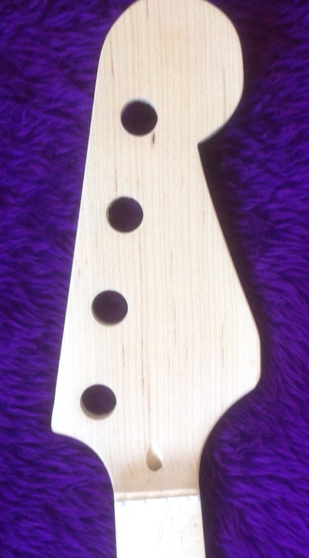

Attachment 6112Dad has shaped the head also.
Looking great!
