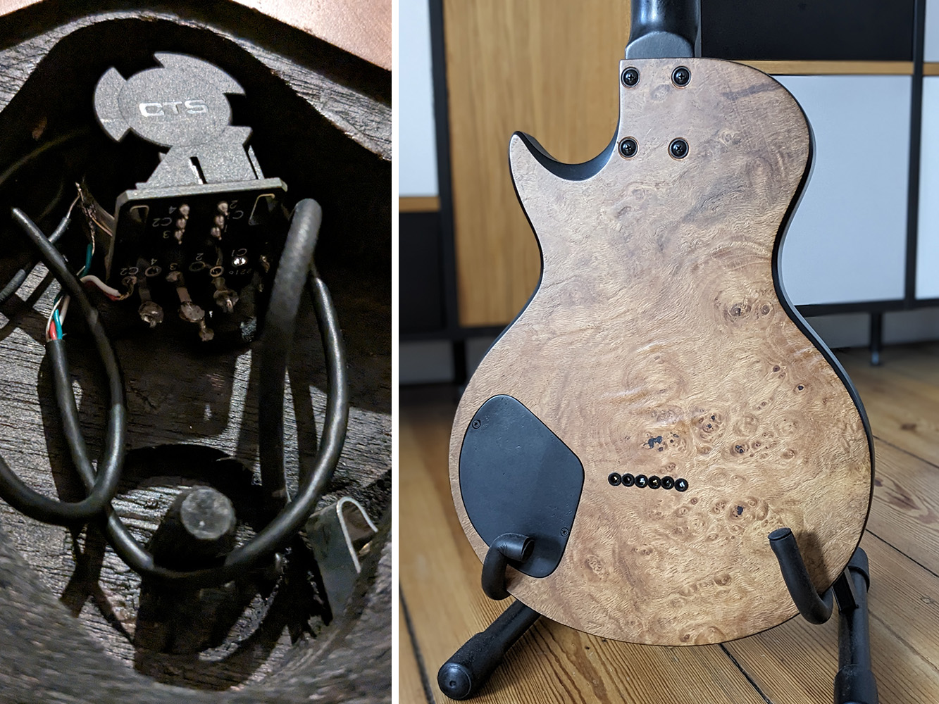

I tried out to put some shim into the neckpocket. Have to find some thinner ones, for those are a bit too thick (1.5mm) But it gives a nice result by little effort. In my case something about 1mm could be fine I think. But of course have to test it.
Attachment 44565
Now I am also deciding which bridge to take. I like the one with the golden string riders, it corresponds the woodcolor. But the whole black one is finer and more elegant.
For it will be a string through, maybe the one with gold is better for the string angle, or does this not matter? I also question myself what is the right distance for the stringthrough holes after the bridge? Actually main thing is that it is not too short (cause of angle), but it could easyly be 3 to 5cm I suppose, is there something else to take into account?
Attachment 44566
