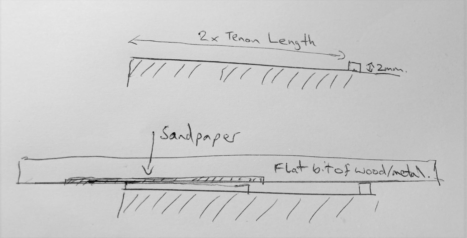

You could make a basic jig up like drawn below.
Attachment 42159
If you want a shim that is 1mm high on one end, then stick a 2mm high block on some wood double the length of the shim away from the edge (block is always 2x the required shim end height).
Use double sided tape to stick the basic shim to the wood so it touches the edge of the wood.
Use double sided tape to stick some sandpaper on another bit of flat wood, so that you can run it back and forth and sand the shim down, but don't put the sandpaper on all the length as you don't want to sand the 2mm block down as well!
Sand away, and when the sandpaper reaches the end of the bottom block of wood, you're done.
This is going to leave a very thin and fragile shim, so you may want to make it one layer of veneer thicker throughout. In this case stick a layer of veneer on or under the 2mm block, and stop sanding when there is just one layer of veneer left at the end of the bottom block. Marking the wood you want to sand away is recommended, to help stop over-sanding.
