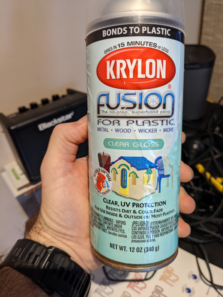

I used this:
Attachment 41539
I believe this is it - https://www.caswellplating.com.au/st...r-uv-protector

The White Knight Squirts are a acrylic enamel paint, you definitely don't want to put polyurethane over that.Quote:
I've got some cans of Squirts black and some polyurethane that I'm hoping to use, but so far on other projects they're not playing nicely, so I might go down this path yet.
The Squirts do state they bond to plastic, so it would probably be no different than the SCA acrylic enamel I used. However, if you want to clear over it, just make sure it's also an acrylic enamel - like the Squirts Clear or White Knight "Crystal Clear".
I try to use the same brand of base & top coat as much as possible in an effort to eliminate incompatibility problems. Still not always a guarantee, IME.
I ordered a can of Krylon black and a couple of cans of clear coat. I've got another little job I'm working on where the problems with using different types is biting me on the rear, so my test with this stuff will be sorting that little drama out.
You might have a bit of overkill with a couple of cans of clear. After doing the clear coats on my job, the can feels almost full. I went through way more white than I did clears.
