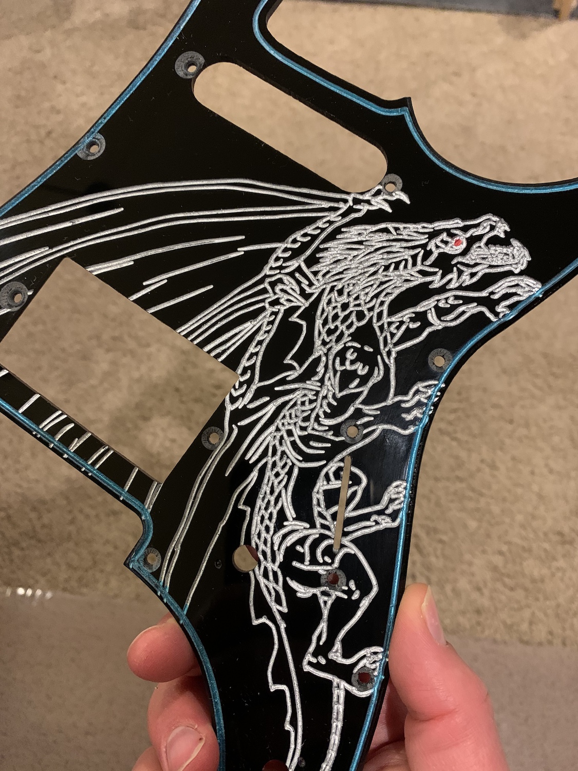

I gave the scratch guard another go, engraving into the front of black acrylic this time. What I found is that yes, it did make the dragon much much bolder and more visible. I like the original better though. The bolder lines came at the expense of sloppier lines, with the rougher edges inside the cuts even more visible. It lost the depth that the backside cut had where the whole cut could be seen through the clear acrylic.
What did work with this attempt is plastic polish - to do the painting on it, I simply carved the dragon, spray painted the whole thing silver, and then used plastic polish and some elbow grease to get the paint back off the uncarved surface. It took about 15 minutes all told to polish it back off.
Attachment 38776

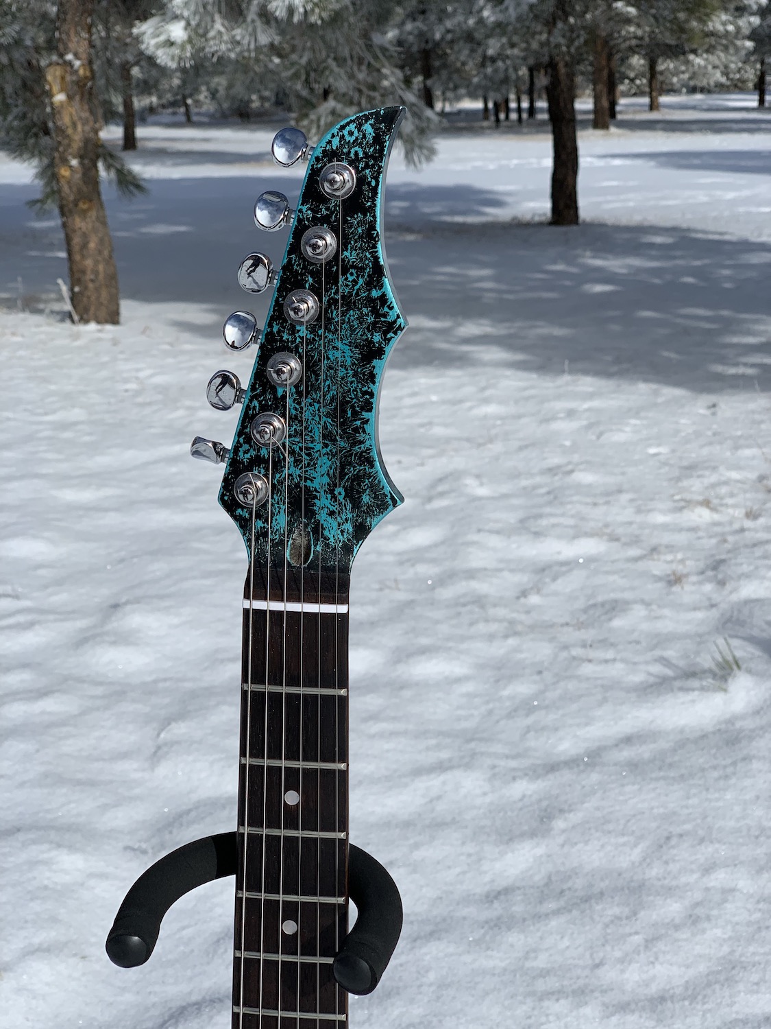

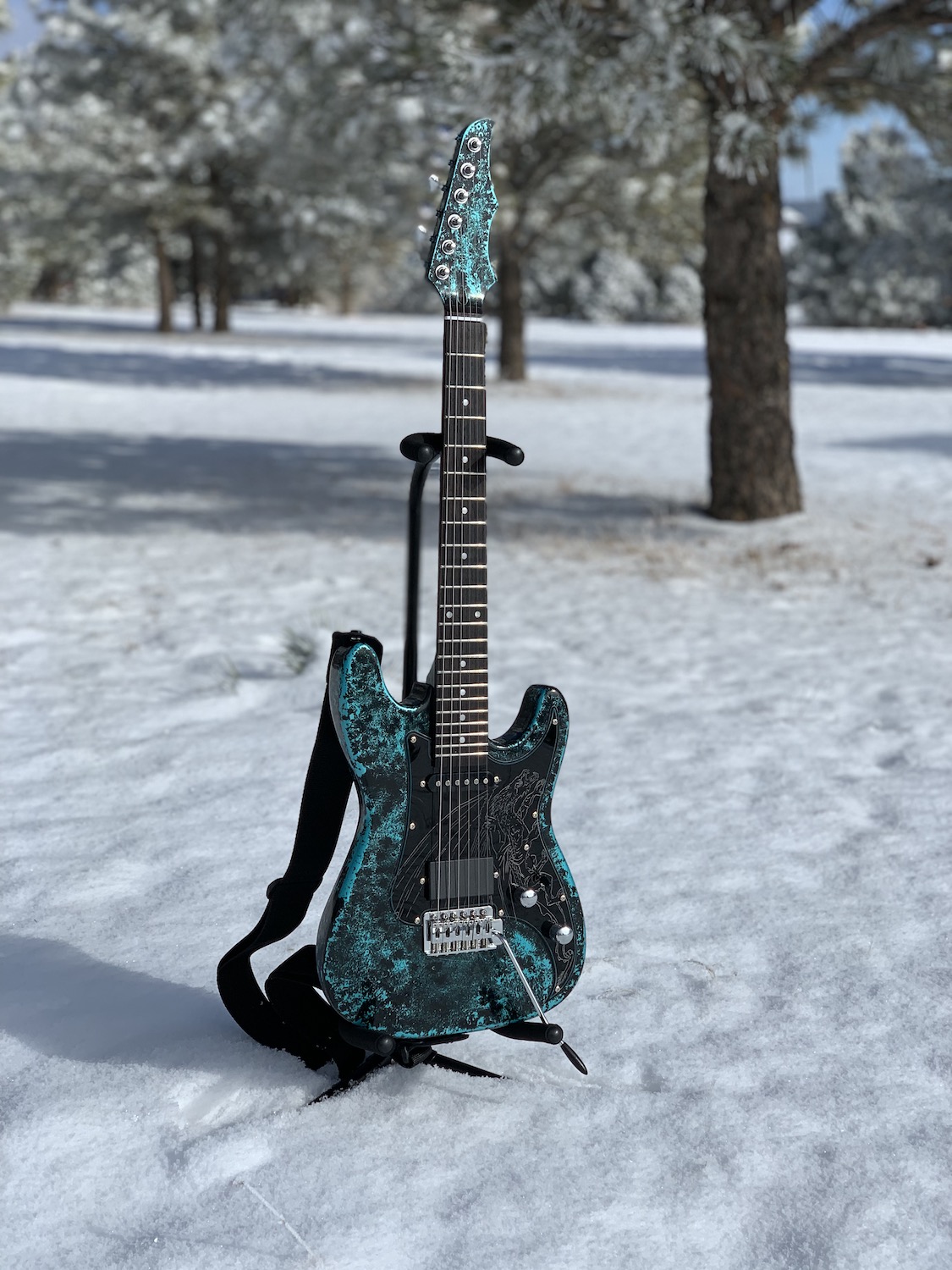

I got out in the snow yesterday morning and got a few glamour shots of it...
Attachment 38777
Attachment 38778
Attachment 38779

Soooooo, you're not in Australia then...
That pickguard still works, even with the bolder lines. Good work!
