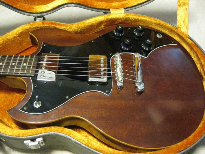

btw this is what the yamaha SG-50 looks like, note the position of the selector switch.

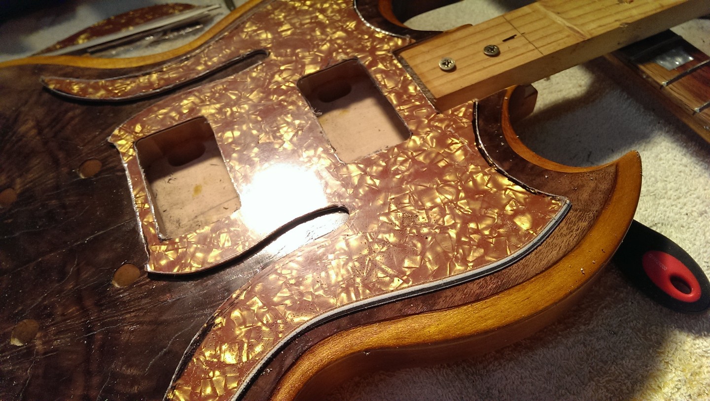

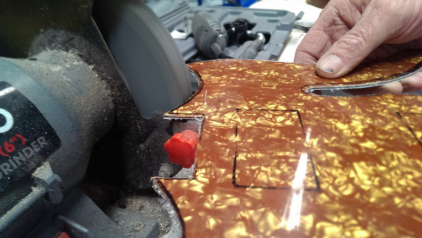

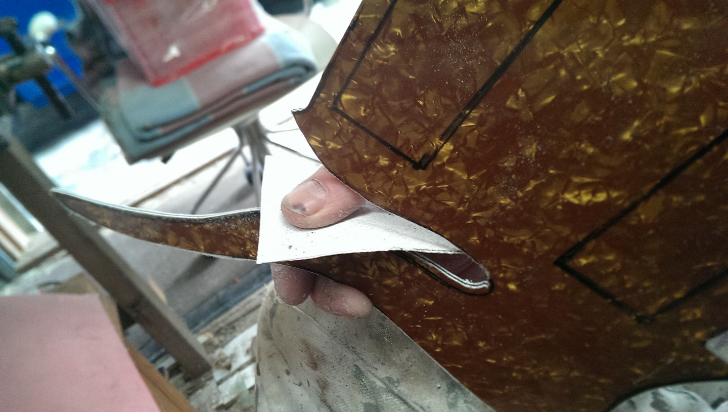

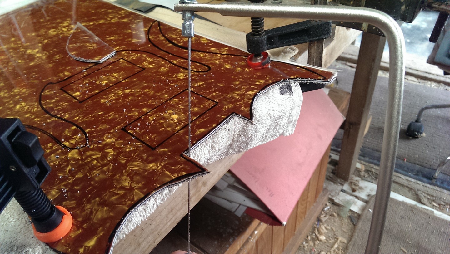

Now ive decided on my pickguard design, time to start cutting it out. I roughly cut out the shape with a coping saw...
Then used my bench grinder to refine it, then used sandpaper to smooth it out. I cut out the pickup holes with a dremmel and used it where the curves were too small for sandpaper.
Attachment 15207 Attachment 15208 Attachment 15209

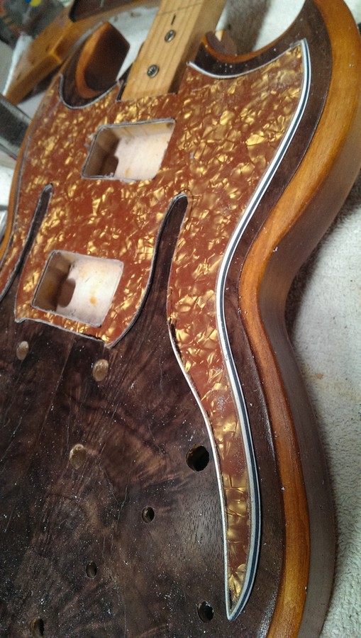

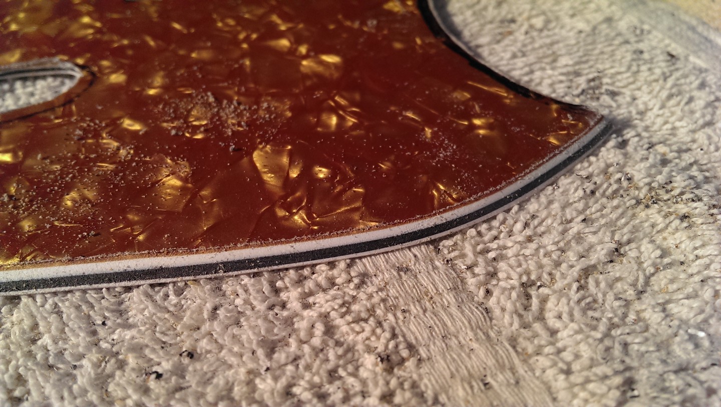

I then used a power sander to start putting an angle on the edges of the pickguard.
Attachment 15210 Attachment 15211
One side nearly finished and what it looks like on the body..
Attachment 15212 Attachment 15213

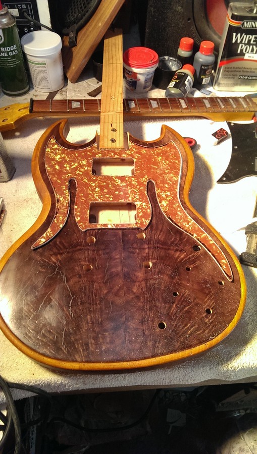

Looking at an earlier picture, you've got a control knob going in the big hole next to the thin wing of pickguard. It doesn't look like you've got quite enough clearance for the knob to be almost flat against the veneer. so it's going to have to stand proud (and maybe look odd compared to the other knob. Have you thought about this?
That larger hole is for the switch which I thought Nitro was relocating. Pickguard looks great by the way Nitro
On a previous pic he had a knob positioned there, but his pickguard mark-out was slightly smaller.
