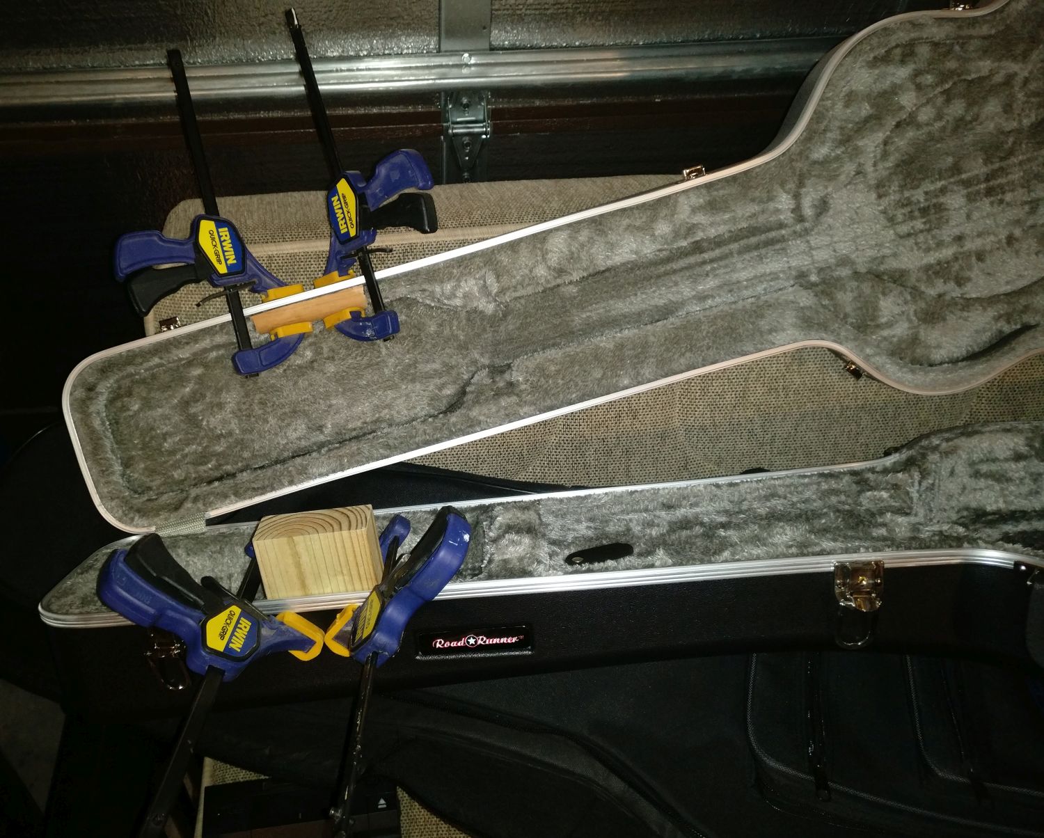

I finally reconciled myself to the fact that no one makes a case like the Jack Casady...just a tad longer. So I would need to mod a case. The one I decided to mod is a Road Runner RMMBA17 acoustic bass case. It had two issues. One is that the headstock area was a little too small for the E-string elephant ear. On the good side there was a good amount of space between the top of the headstock and the top of the case. In a well-fitting case, nothing touches the headstock with the case closed. The heastock would probably fit if I could remove some of the polystyrene-like foam next to the tuner. The solution turned out to be easier than that. When compressed, this foam stayed compressed. So, I clamped it overnight and got a good indentation around the E-tuning peg.
Attachment 33604 Attachment 33605
May not look like it in the pic, but the E-tuner does not touch the padding on the inside of the case.
Other changes to follow...

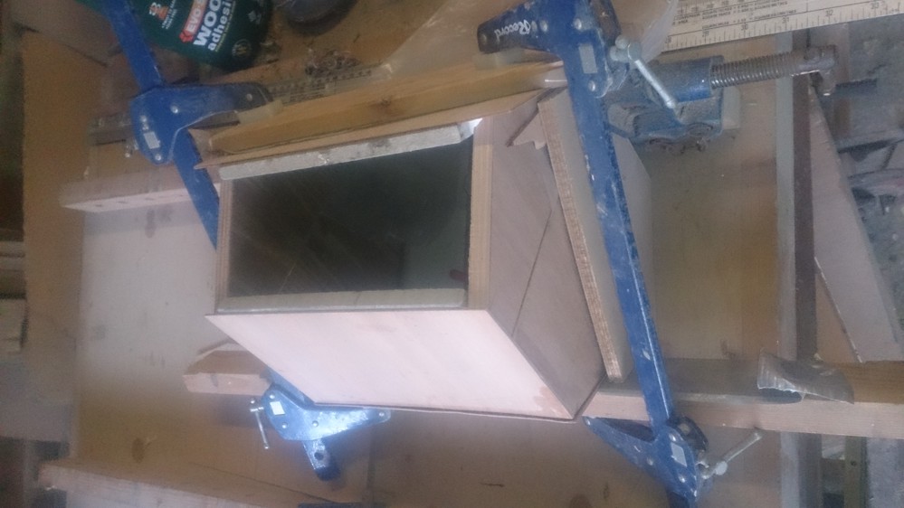

I've built a few instrument cases this last coupla years. Also modified the internals of a couple of guitar cases. The one for my Ibanez acoustic that's doubling for my ESB got a load of extra padding in the bottom because it was far too deep for the Ibanez. I would have liked to make it shallower, but when I considered the job I decided it was too hard. Happily there was enough soft padding that the ESB doesn't rattle about either, so once I'd modded the guitar to fit the case I didn't have to mod the case again.
I reckon guitar cases really are kinda boring and unsatisfying, and spraying up furry fabric with aerosol impact adhesive is messy and irritating. Also the glue and stuff is expensive and it seems like a lot of money for no saving. The only one that was kinda interesting was a case for my concertina... But also a pain in a different way because six sided... But the thing that really puts me off guitar cases are they are so damn big.
Attachment 33620
