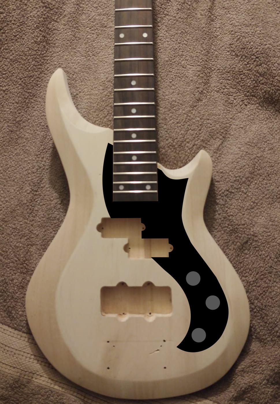

The other thing I'm tossing up between is whether I add a pickguard or not. A lot of traditional F style basses do have pickguards and I also like the look of the PRS S2 Standard and S2 Vela which both have pickguards. I've done a mock up of what I'm thinking. It also I think makes the curves look more balanced on the treble side.
What do you think? With or without pickguard.....

The body has a veneer on the front and back which is a lighter colour to the core wood. So I'm thinking I need to do a solid colour. This was the intention from the beginning. Do a rattle can finish with a bit of pearl or metallic sheen to it. If I was to do that I could even cover over the back cavity with some ply wood and route from the front instead, using the pickguard as the control cover.

Will also depend on the colour of the pickguard. I have a large piece of 3 ply purple pearl (white, black, white) which would probably look good on a solid black guitar. For a lighter coloured finish I like just plain black possibly 3 ply with a single white line.
I like the pick guard too.
It adds movement to the lines.
It looks a bit like a Phantom of the Opera mask. 🤔
