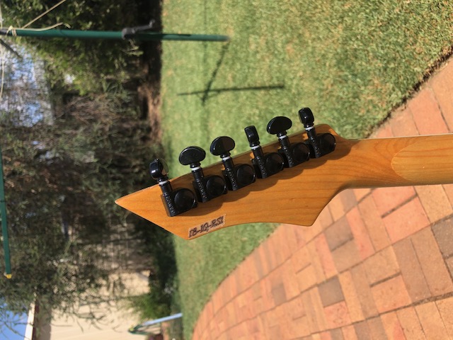

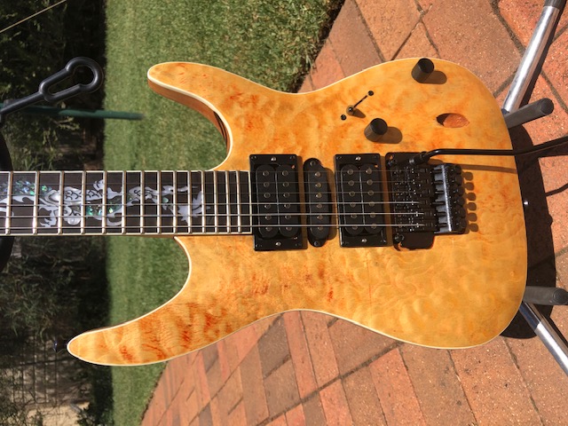

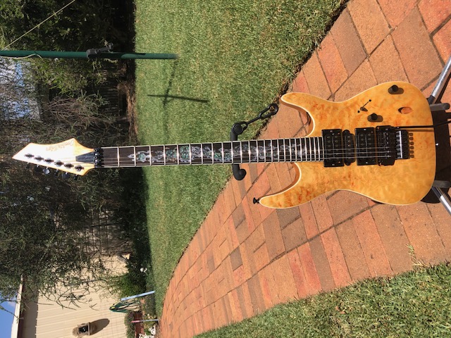

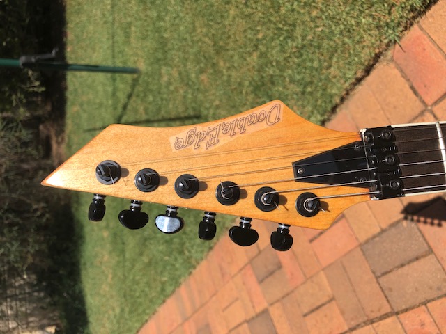

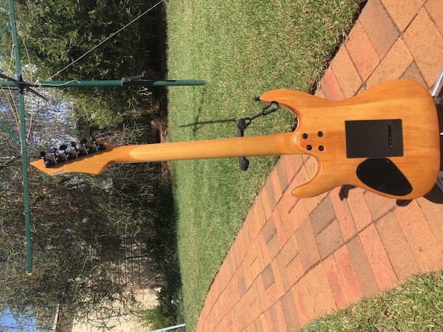

Finally finished
Except for the hassles with the Dingotone it came together quite well
Attachment 29487
Attachment 29488
Attachment 29489
Attachment 29490
Attachment 29491
Great work, well done!
I like it a lot. Not as dramatic as the original intended colour but beautiful all the same. Well done!
Sent from my SM-J120ZN using Tapatalk
Looks great! Sucks that the Dingotone was a pain in the arse to work with, but you've done well to keep that veneer intact and get a beautiful end result. I actually really dig the strawberry blonde look.

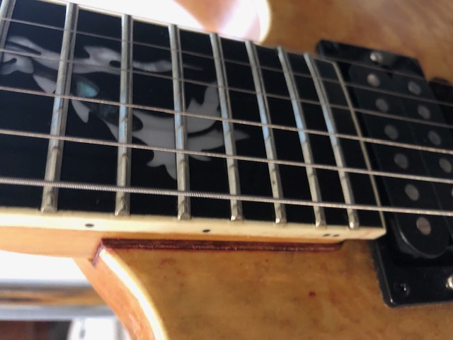

Well it's back together & happy with the end result
Strings are running parallel to the edge of the fret board. It also fixed the string height issue it had on the treble side & made the whole thing much nicer to play
I use the body stain to colour the shim. I just hope it fades the same as the body did!
Attachment 31620Attachment 31621Attachment 31622
yep, that looks the business now. You'll find that the shim will probably stay a darker tone, but it doesn't show up terribly unless you're poring over the guitar in detail. Good fix up mate!
