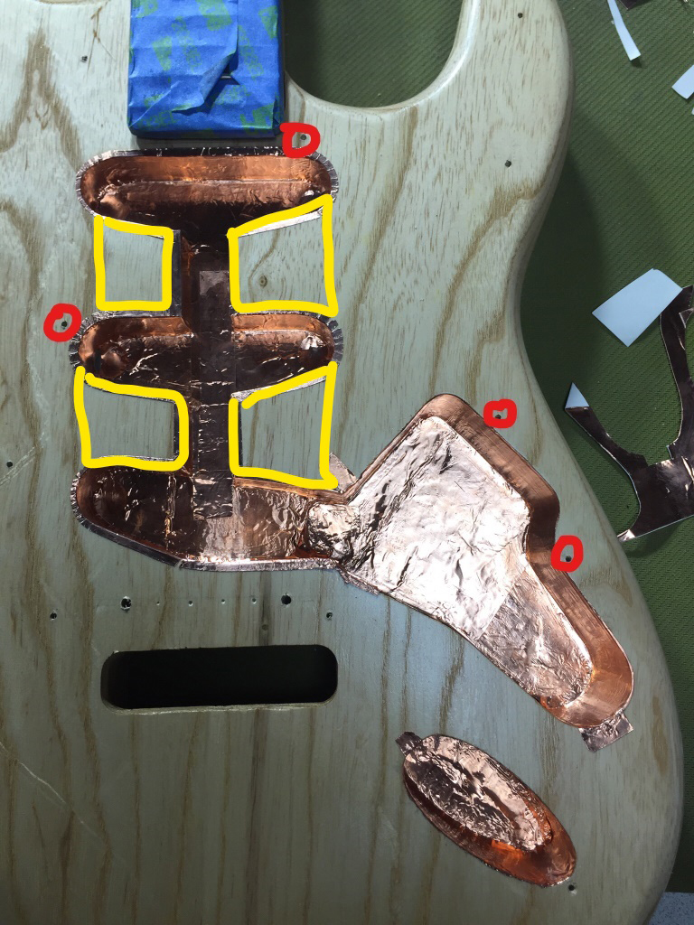

I may have gone OTT on the cavity shielding.[emoji15]https://uploads.tapatalk-cdn.com/201...13d8acabd4.jpg
Hope nothing shorts out
Not OTT at all. I normally leave a lot more foil on the top to make contact with the foil on the pickguard, and run the foil around several screw holes to maximise contact area. You'll never know exactly how well/flat the pickguard sits on top of the body, and so how much of the tape is in contact.
Attachment 26764
I normally run the foil to the holes marked in red, and fill in the yellow areas with foil as well. It doesn't look as neat with the pickguard off, but it's not going to be seen.
Tin foil hat too perhaps?
You can never be too careful.
In the words of the song....
“Just because you’re paranoid, don’t mean they’re not after you...”
Thanks for the tips Simon, I’ve enough shielding left to do some bridging on those points.
