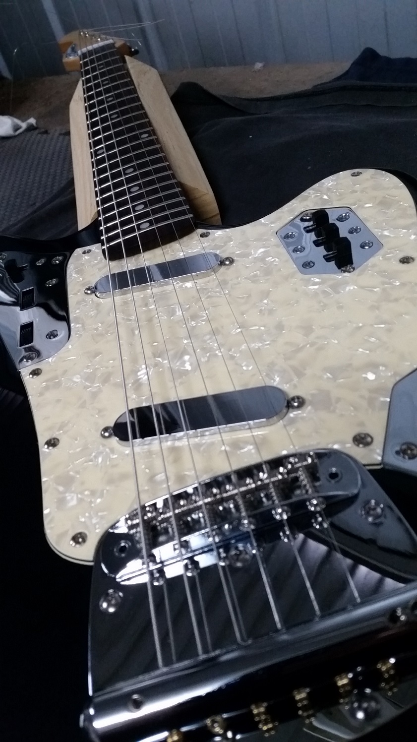

Cut overall shape for the pickguard and the cutouts for the pickups and the switch plate with a scroll saw.
Attachment 31354
Then used my improvised router table to tidy the edges and used a 30 degree chamfer bit to put the angle on the edges.
Now I can see why the usual is 45 degrees, it gives a better separation of the pickguard layers on the edge , but this will do for now.
Attachment 31355

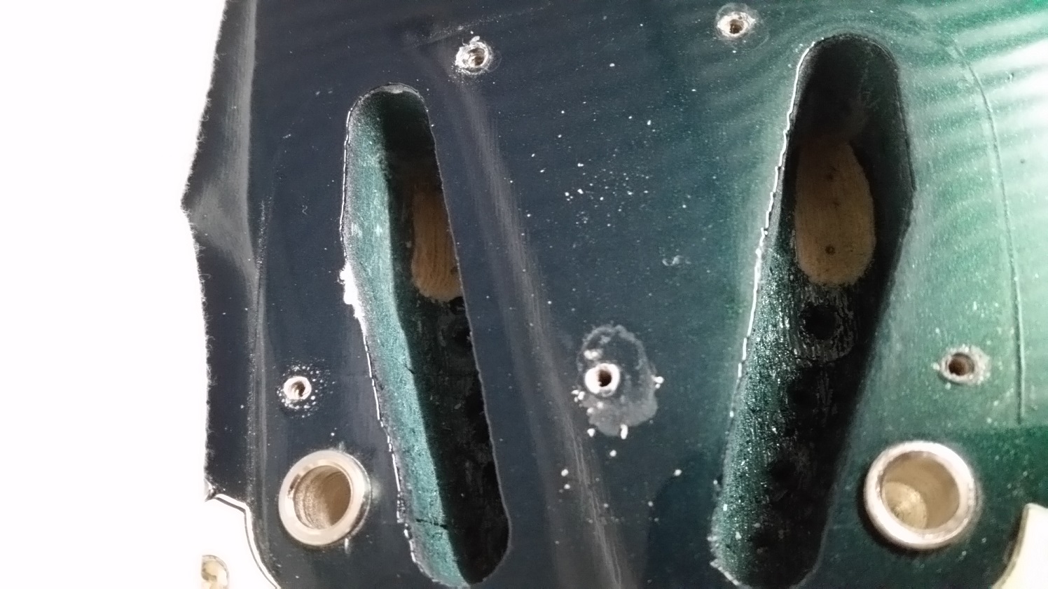

The finish has settled enough that the trem cavity repair/fill on the back of the body is easy to see with the naked eye, having a hard time getting a pic to show it, if look in the right spot you can see the bottom edge in this one

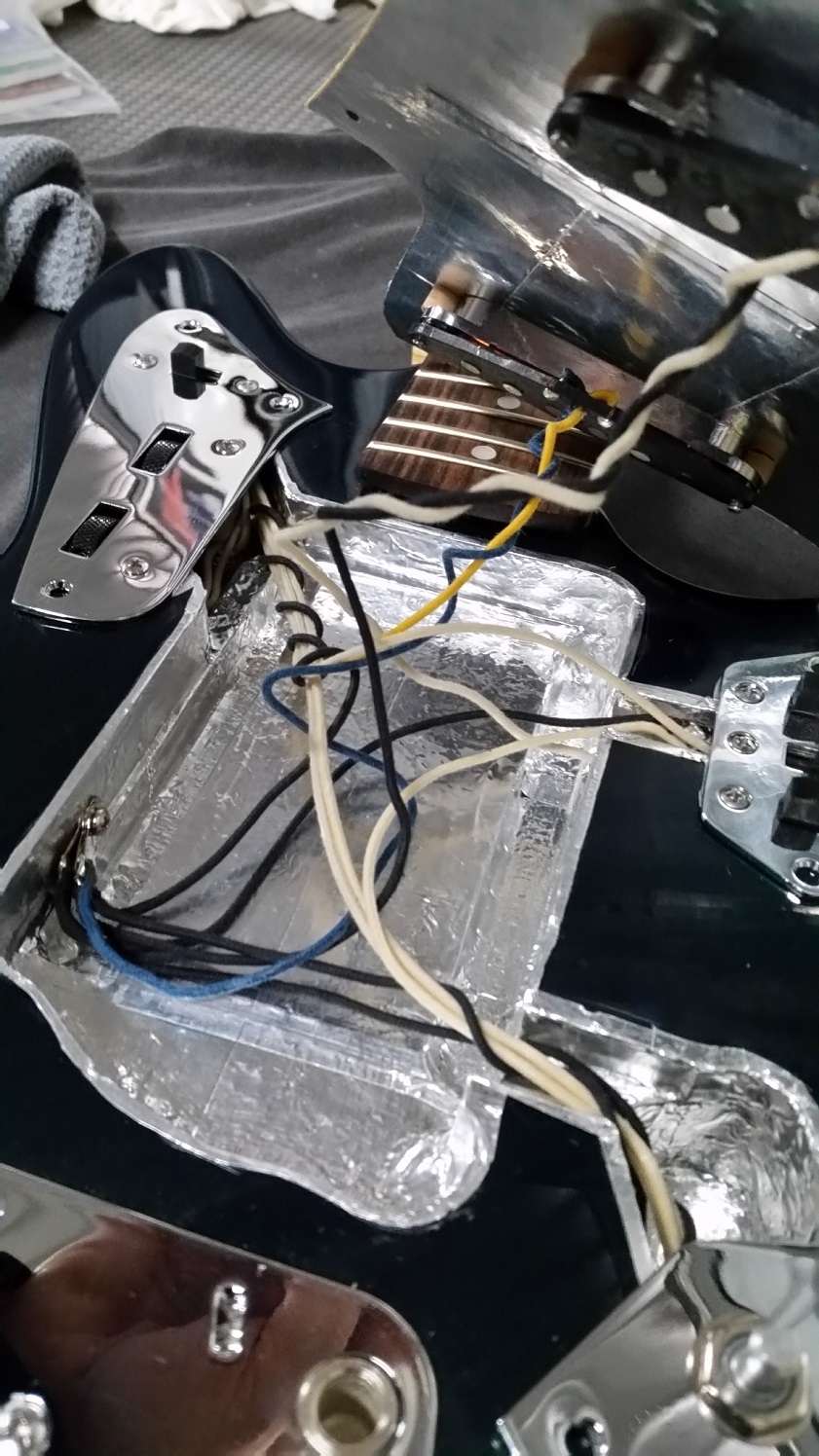

Thanks for the comments gents. Have made some progress, the wiring has been done and passed the tap test.
Attachment 34525
Over the warmer months the clear settled more and had to redo fine sanding and polishing. In that process the shielding tape got knocked away from the edges so that got taken out and redone.
Attachment 34526
Found some spots between the cavities that weren't as conductive as they should be. Stripped the plastic insulation off of some of the kit wire and used that under the foil tape where needed to get everything connected as should be.
Attachment 34527

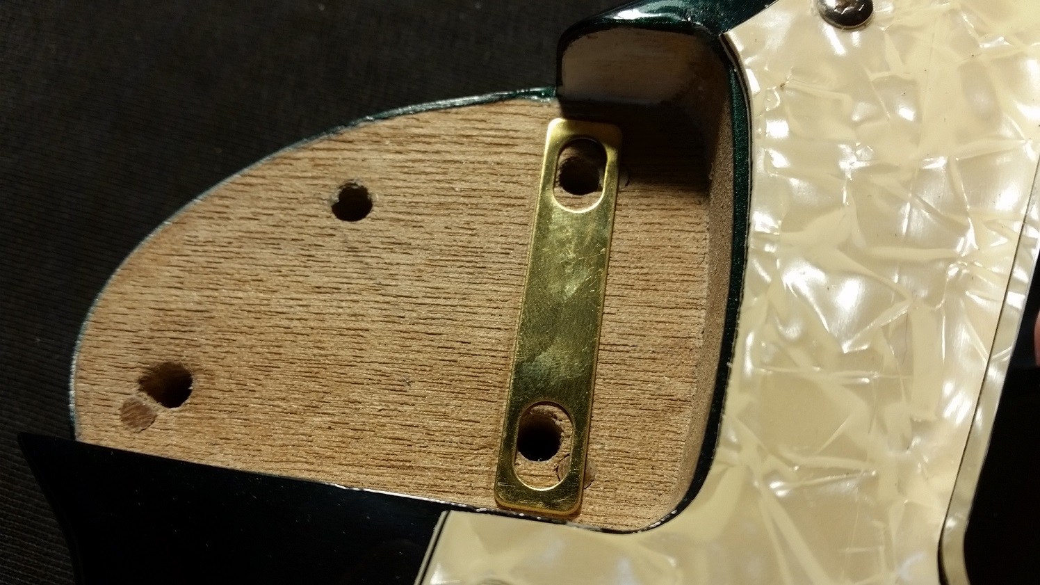

Have also used a 0.2mm brass shim in the neck pocket because I think the bridge needs to come up a bit so it can pivot with the trem properly, if it's not needed is easy enough to take out.
Attachment 34528

Don't know how this can be done neatly but this is what the wiring looks like installed.
Attachment 34529

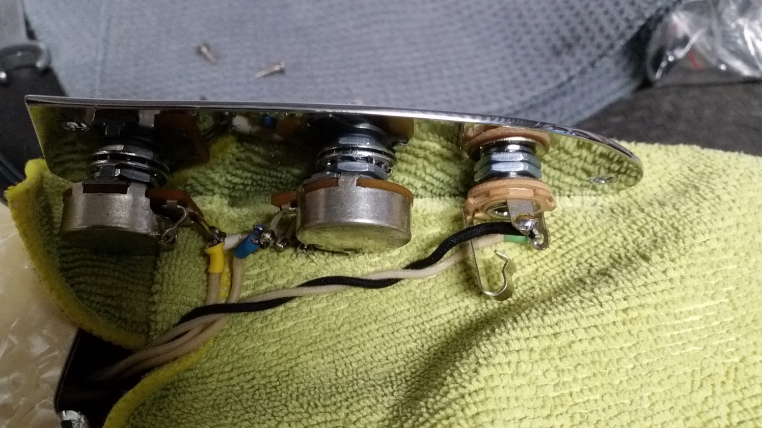

Had to rotate the jack on its control plate because when I plugged it in to test there was a whole lot of silence, something was earthing a bit too well.
Attachment 34530

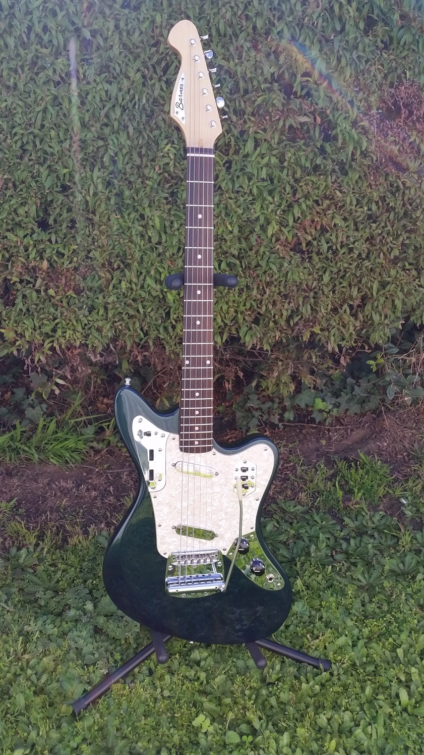

Over the time (years) it's taken this one to get done, the fretboard has dried a little bit. This is just the first wipe on of DrDucks, up to three and am sure it will need more.
Attachment 34531
Just had to throw a set of strings on.
Attachment 34532

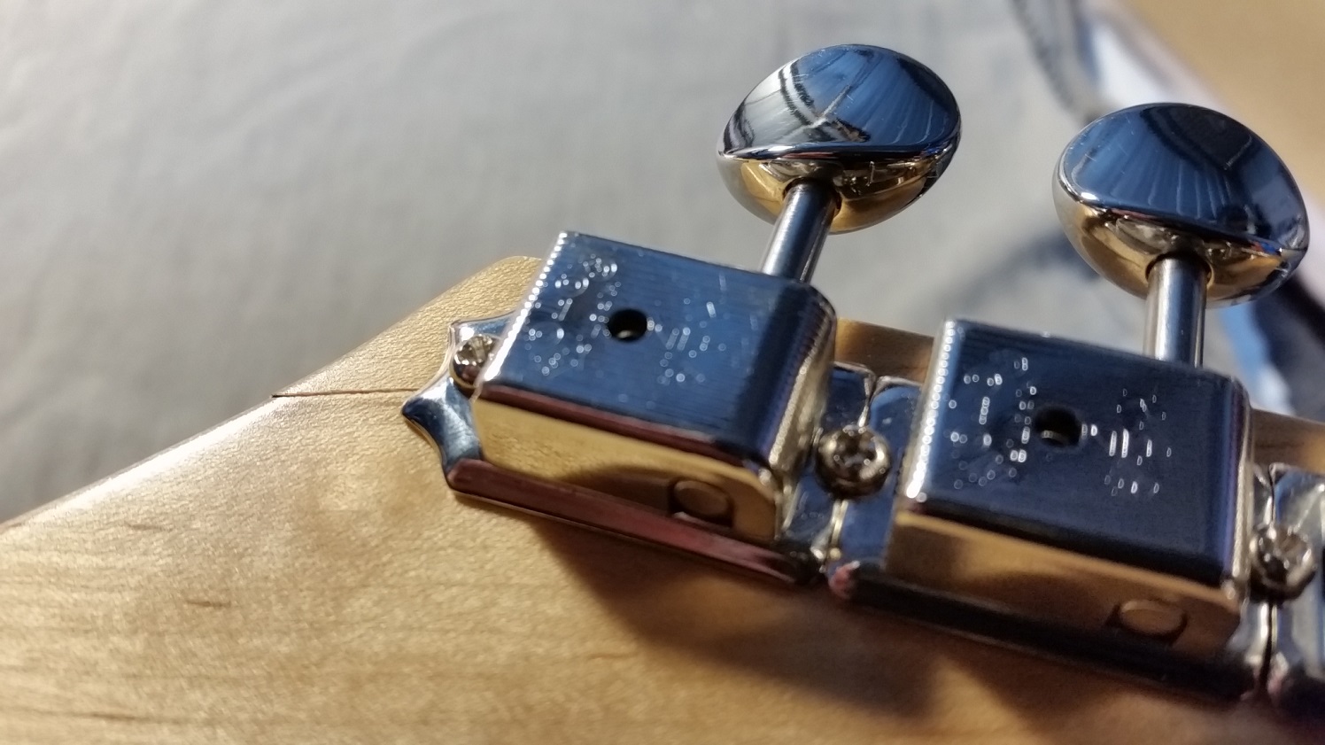

As luck would have it the mounting screw for one of the tuners ended up in a grain line which didn't appreciate it and opened up. Took the tuner off and carefully put some CA glue in and now seems OK.
Attachment 36774

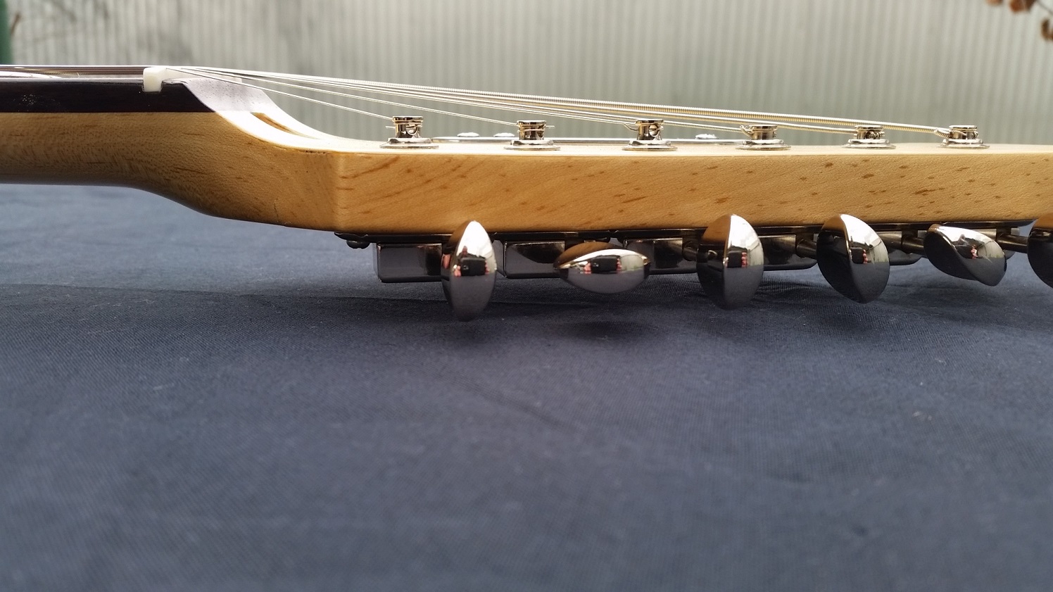

Using Gotoh HAP (Height Adjustable Post) tuners and kept breaking high e strings when tuning up to pitch, this side shot shows why, someone forgot to adjust the post height and B as well.
Attachment 36776

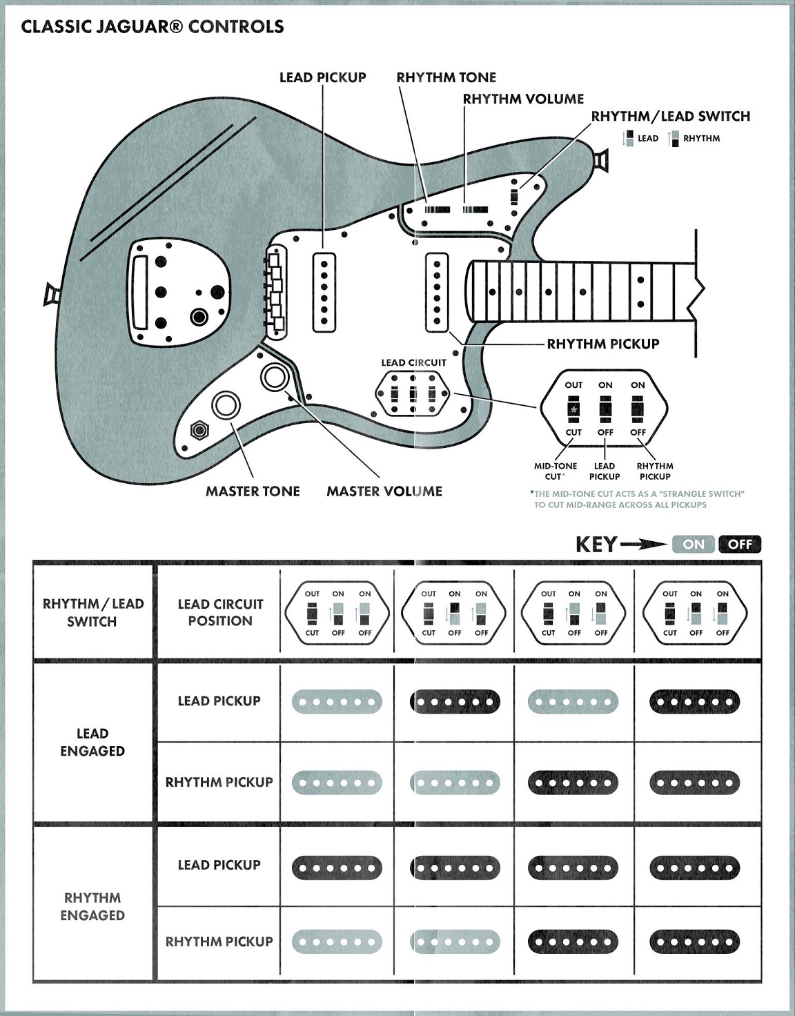

Had to print this chart out for the switching to be sure all was working as it should, wasn't.
Attachment 36777

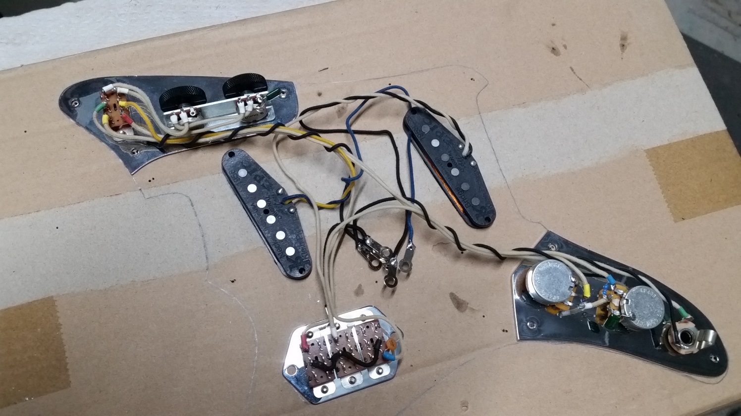

On lead circuit, switching works as it should with no hum until the neck pickup is brought in. When switched to rhythm circuit it hums no matter what you do. Also does not respond to any switching, pickup is just on, and the master vol and tone don't have any effect, the rhythm vol and tone do.
Will have to take apart to work it out and hoping I've just got the neck pup wires backwards.
I'm bound to damage it in some way so here are a couple of pics before I do that
Attachment 36778Attachment 36779

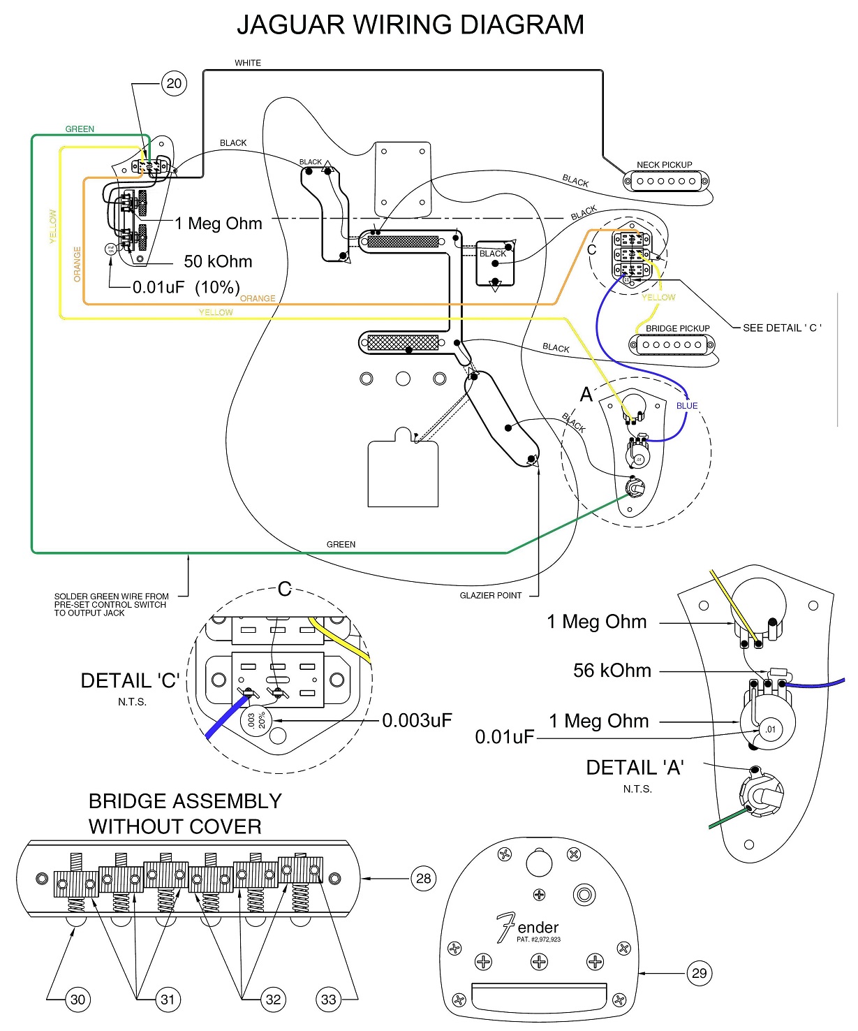

This is the wiring diagram I followed
Attachment 36780Attachment 36781
and a repost of my wiring if anyone can see a connection that's been missed. Note that the actual pickup wire colours are swapped to the diagram (neck to bridge). The Kleins clearly have neck and bridge cast into the base plate so I went by that and not wire colour.
