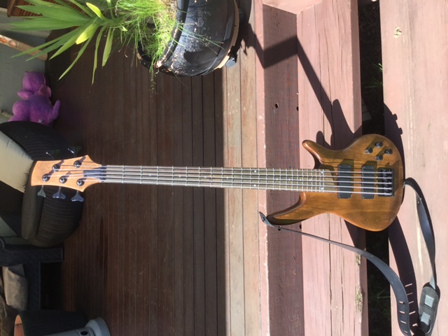

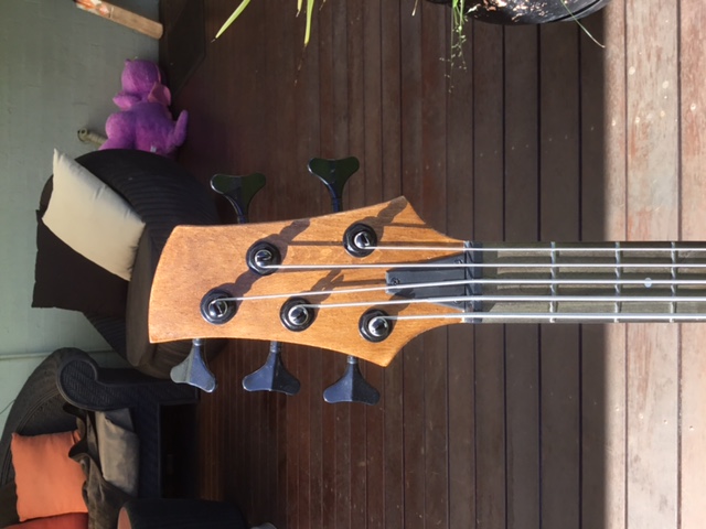

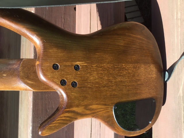

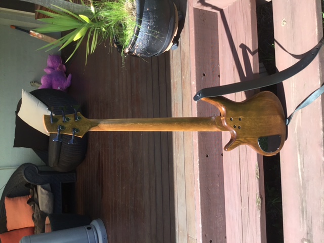

IB-5. First attempt at a build. Oak stain with Satin poly finish. Sheared a few screw heads on cover plate, which was annoying.
Attachment 22283
Attachment 22284
Attachment 22285
Attachment 22286
looks great Mally, I love my IB-5 I converted to fretless

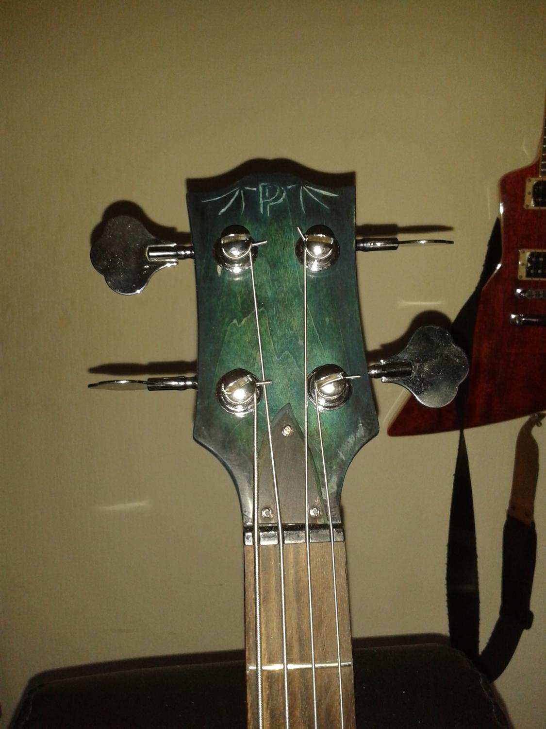

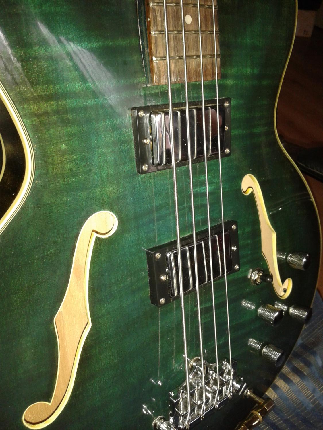

gday all..
here's my entry for the Rocktober GOTM
finally a day bright enough to take the final pics though it's been ready for about a week now.. i am going to swap out the pickups and pots at some point.. but that may take a while so for now i'm calling it good.. been playing it quite a lot lately.. she does sound good to me.
Attachment 22321 Attachment 22322 Attachment 22323
Attachment 22324 Attachment 22325
taking pics is not my forte.. but i do like the way the colour changes with the lighting
for more info on my build http://www.buildyourownguitar.com.au...ead.php?t=7702
You must be stoked, love the green gloss. Really nice
Nice entry Peter looks very tasty

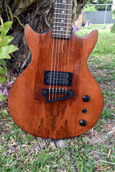

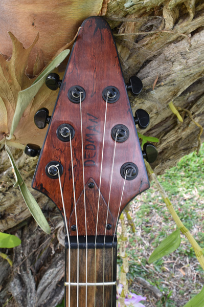

Finished the DM-1S today.
Body and neck are stained with wood dyes then about 30 thin coats of Tru Oil. The top wasn't sanded or grain filled at all, there was a few small glue spots and a line up the center between the pick up and the neck. I camouflaged that with some matching paint and a tiny brush which I painted some extra "spalt" on. The back is "cedar" mixed with a little black and red, the top is cedar, red and orange mixed. fretboard is finished in Ren Wax.
The kit comes with a P90 but I had always intended to use a humbucker so I had to open up the cavity a tiny pit with the dremel. The pick up is a Kent Armstrong Motherbucker which is actually 2 humbuckers side by side, so I added a 3 way switch to choose plus spit them both with push pull pots so there is quite a range of sounds from what looks like 1 pick up. bridge is a Hipshot Baby Grand, tuners are Grovers, knobs are ebony and the truss rod cover is a veneer offcut stained with the same mix as the back.

I love it Dedman! There's another one on the kit list!
[emoji1598]
There goes my hopes of winning!
Nice to see some clearer pics of it Dedman. Top one in particular is pretty cool.
I still think you are in with a chance teamjeffo, yours has a definite x-factor.
very nice entries Jeffo and Dedman, both great looking axes
na, your Starcaster is fantastic Jeffo and your garden is lusher !

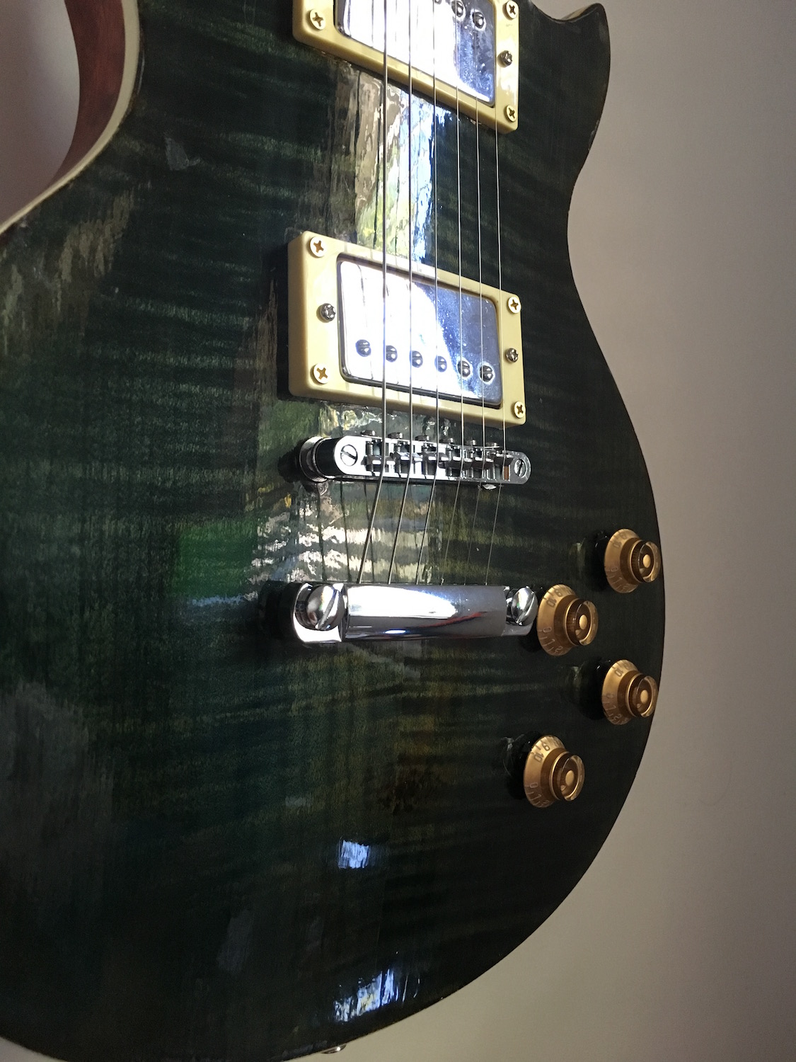

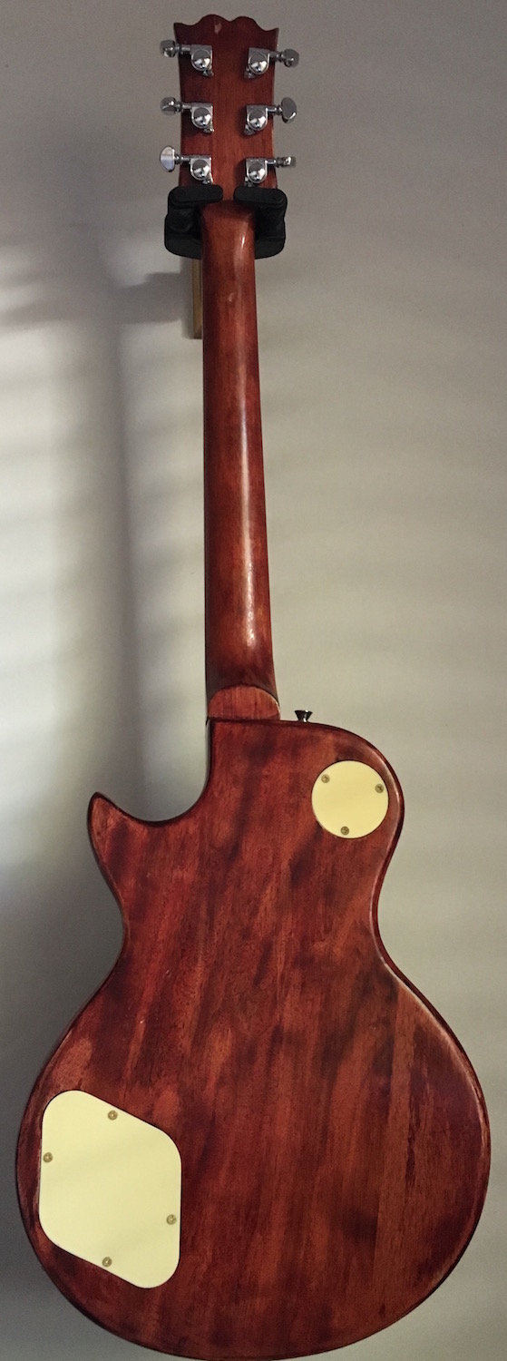

Hey Everyone,
I had just finished my first build which was a Les Paul style kit. I'm quite happy the way it turned out - being my first kit.
The only changes from the kit are:
Added: Grover mini locking tuners
Knob pointers
Apart from that everything else is stock.
I stained the top with Transtint Black and Blue and the back with a mahogany wood stain by Feast Watson.
The guitar was finished with tru oil, with a gloss finish on the front and a matte finish on the back and neck.
Enjoy!

Really nice job U1F, I love that deep swampy green!
agreed.. great colour..
of course i'm biased.. mine's near the same colour.. also a bit green.. done with blue stain/dye

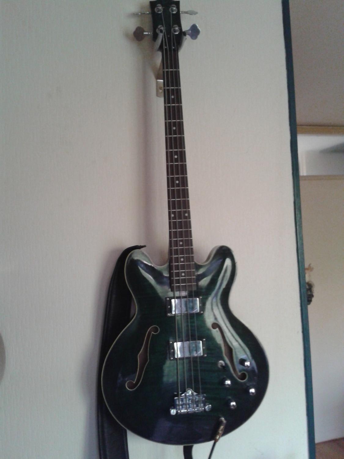

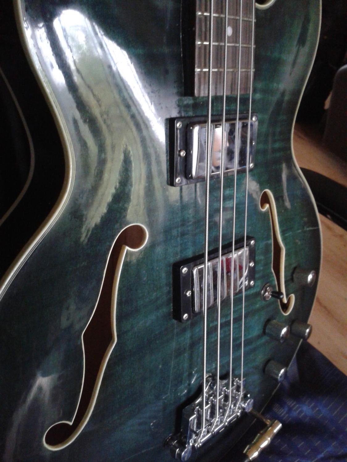

Marcel ES-1TL
Green/Blue are notoriously difficult stain colours, but you have managed a really even and consistent finish.
Unique colour finish. Love the headstock shape. Lots of useful quality upgrades too.
Marcel's got GAS worse than me! The Youbeaut stains have worked well and a shellac finish (and scraping that binding) is a labour of love. I am drawn to the aftermarket parts, the roller bridge, the grovers and I KNOW how sweet those Tonerider AC2's sound. Pat on the back yet again Marcel.
It's not the sort of colour that normally appeals to me, but I quite like it on this build. The top looks excellent and works well with the grain, but the back appears to have be more of a challenge to get an even colour. Great upgrades all round and nice headstock shape. Looks like a real 'grab it and play'. Very nice.

Mally's IB-5
Great job all round.
Beautiful! oak stain with black hardware and finished with satin poly. What a great ensemble Mally. I'm glad you got through the wiring problems and great come back from shearing those screws...been there before! You should be proud of this one.
Dark brown seems to be most popular colour for this kit and looks good plus nailed same shade on neck & headstock too which is not easy matching Maple to Ash.
IB-5's always look great, and this is no exception. It's just a sexy bass. The colour looks good on it, although it appears there are some glue marks the were reluctant to take stain. Clean, functional and groovy. The fretboard appears a little dry and I think it would enhance the overall look with a bit oil lubing and darkening it. Well done.

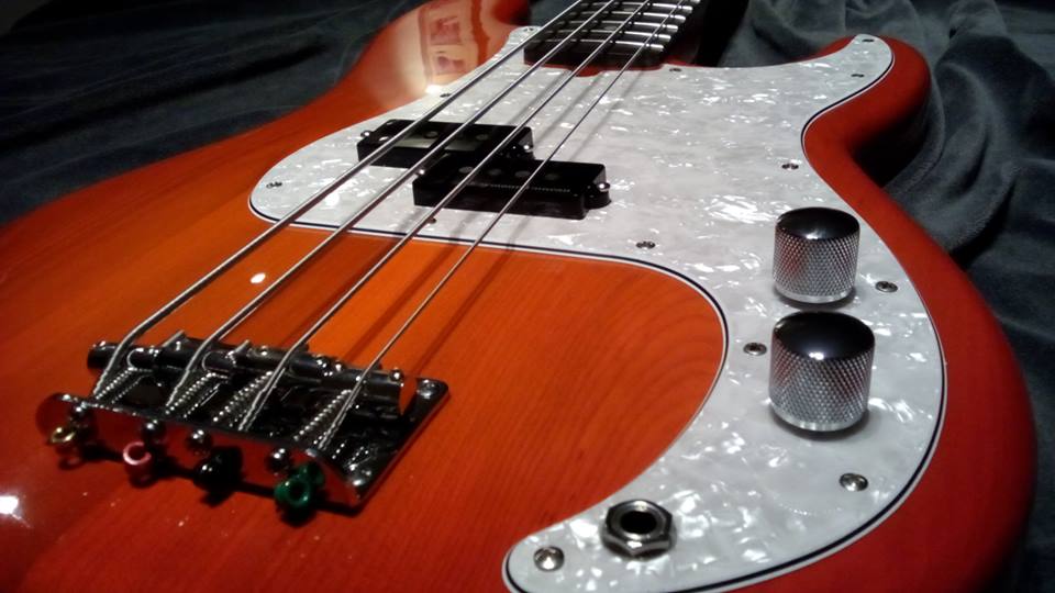

Andy Burd ESB-4
Love the colour. To me it is a classic finish that suits this bass perfectly.
Stunning Red burst finish. Tend to expect set necks to have same finish as the body though as stark natural Maple has an abrupt look. Interesting bridge modification.
Great build AndyBurd. The gloss on this baby is first class man. I only wished the red stain popped a little more and the gloss didn't get in the cavities. Interesting saddles! Over all, great job Andy!
A beautiful dark burst with some impressive gloss. An innovative solution with the custom saddles to correct the action, although the kink on the higher strings worries me a little. I hope the saddle slots are deep enough to keep them in place. A great shape for a bass and nicely finished. I love the contrast been the headstock face and back of the neck. Great result.
