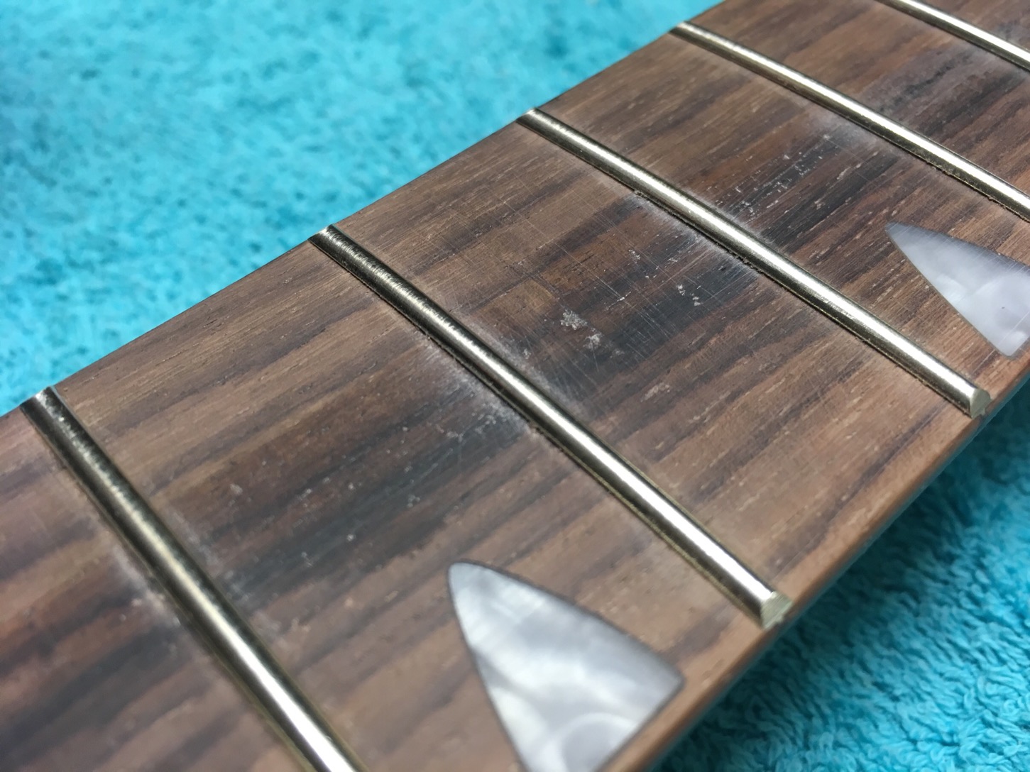

Not much of an update at the moment. Just another dry fit while I wait for my stain kit. The pickups didn't quite fit as the tabs seemed a bit too long. I was going to get a Dremel and widen the pickup pocket but I grabbed a name brand pickup and it fit in just fine, so I filed the tabs down a little til thy fit. Job's a gooden.
Attachment 20461
There are a few pits in the fretboard that I'm unsure what to do with. Reckon they need filling or just oil it up as is.
Attachment 20462
It's a bit tough to see in the pics but you can feel the pits. My gut feeling is they'll be fine but interested in others thoughts.
If the colour comes out as Waz suggested above as a faded denim I think it will actually work pretty well with the look I'm going for.
Robbo
Hey Robbo does the fingerboard feel like it's dropping in height a bit between frets ? What I do is get a rubber/eraser and wrap 180 or 240 grit sandpaper around it and rub the fingerboard. Be worth trying to get it flatter. The rubber will allow the sandpaper to be similar radius to the fingerboard.
Mock build looks good
Hey man, no the fretboard seems pretty flat to these tired old eyes. There's just a bit of funky stuff going on around the 7th and 8th fret. I'll give it a light sanding as you suggest, I'm just trying to sand with the grain to avoid any issues.
Robbo.
Dingo Wax will sort things out on that fretboard once you have done the light sanding.

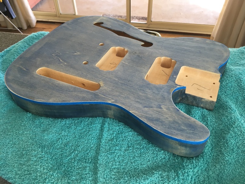

Bondi blue dingotone came today...
I know what I'll be doing tomorrow arvo :)
Robbo
Reminds me of an old Skyhooks song.....Everybody's wearin' blue jeans / Everybody's got their own scenes / Everybody's lost in daydreams / But everybody's wearin' blue jeans.....
Have fun and I bet you will now be humming along to this tune as you do.

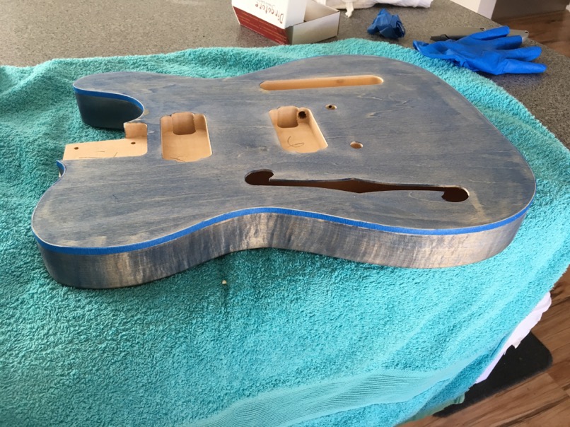

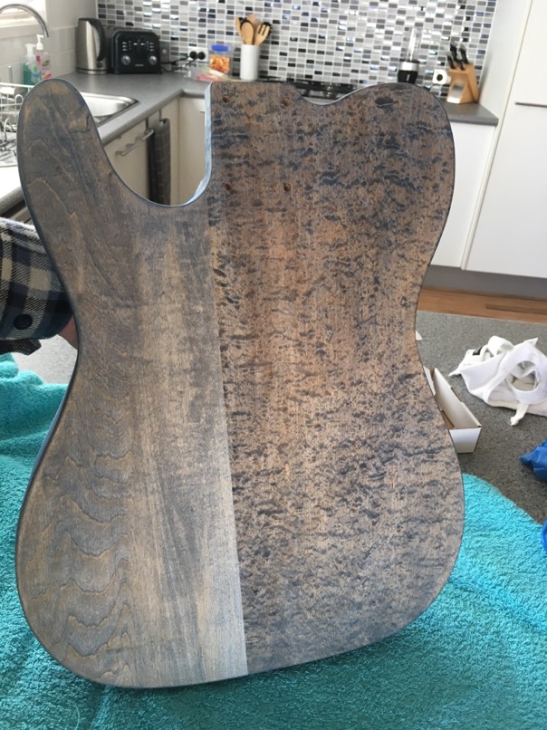

Hmm...
Attachment 20807
Attachment 20808
Attachment 20809
Thought I did everything right. Wet it down looking for glue spots, the whole bottom of the front is a giant glue smear.
The dye will not penetrate some areas around the outside and the grain on the back just looks wet and dirty.
I'll give it a few days to dry, sand and paint.
Robbo.
Bummer about the glue but all is not lost
Be careful sanding that cap, I'd be be tempted to do a solid colour in acrylic paint on back & sides and work it in on the top as a burst.
Spraygun or rattle can for the back & sides and airbrush on the top.
There are plenty of vids on YT showing how to do it, just have a practice on some scrap timber first to get the technique right
A narrow burst might solve the fronts problem. It's a shame the back isn't all one grain type or the other as they both look good but not 1/2 and 1/2. I 'd solid paint the back and sides and burst the front.
I'm not too worried about it as I wasn't 100% convinced on the colour before I started. I'm only $30 and a couple of hours in the hole. As you say I'll paint it in enamel as the dingo tone is oil/wax based so just need to spend some time and cabbage at my local repco or SCA. I don't have a red or white guitar so they're the front runners ATM.

I know your pain there Robbo.... I had a partscaster Tele build do pretty much the same thing to me. A DRparts sealed Alder body doesn't take stain well at all...It actually came out looking so much like faded denim that I decided to turn it into a real denim covered Tele. Still working on the process of combining the denim and the binding into something that looks and feels decent, but the intent is certainly there...
Keep at it, and you will win eventually....
Hi Robbo, bummer about how that turned out.
Fairly typical result when using DT on Basswood and if you sanded past 120 there would have been very few open pores left for any stain to soak into. It can be salvaged if you are prepared to strip back with 80 and sand up again to a smooth finish with 120. Even so, I am yet to see a good example of Bondi Blue as it looks too washed out on most builds.
Tend to agree with Dedman about the mismatched grain on the back. Not such a big deal as it won't be the side most folks would be looking at but if it bugs you then a darker or solid colour would hide that.
Strange that the front did not suffer the same mismatched grain. Doesn't look like a veneer and only glue seepage would have been near the binding. Still reckon it is Basswood just doing its thing.
Blue or green stains are also less forgiving unfortunately. You could try an gentle wire brushing of the glue smear on the front then try restaining.
