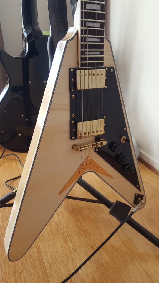

1 Attachment(s)
thanks again guys for all your help with the build i definately couldnt of done it without you legends helping out. i just tested it and im extremely happy as one it works haha and 2 it actually sounds pretty good. maybe later I'll upgrade the pickups but for now im very happy.
Attachment 20171
bravo brokin, you gotta be happy with that!
good stuff Brokin looks great. If there is some nice flame maple under the pickguard between the 2 pups I would trim the pickguard. That's what I did on mine
thanks guys. it came up well very happy with my first build. definately have the bug for it now. i have to save me dollars so i can get another one. alot of fun.
