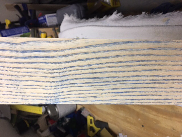

Hmm am now having another thought. Does anyone happen to know how a white grain filler with blue dye added might turn out on ash? Would the blue be evident or is it likely to just achieve a similar result as that of a dark grain filler?

Hey Sergeant looking good.. the blue dyed grain filler will likely give you a very similar effect as the ebony timbermate. Take a look at my pbh-4 build I did ebony timbermate and stained over it. The flamed maple will not take much if any grain filler because it is a very tight grained veneer, so you won't get the same effect on it. Plus you would have to be very careful sanding back the filler because the veneer is so thin. If you did the dark grain filler I would lightly stain the top with black and rub out with fine sanding pad then put the blue over that. The flames will pick up the blue and between the flames will pick up the dark and make them pop.. watch videos on YouTube from BigDguitars he has lots of good finishing videos with flames and quilted maple tops, but remember he is not using thin veneer so you will need to modify to fit your situation.
I was thinking more for the back/sides having the natural ash colour showing through a blue grain fill (white or natural timber mate with blue stain added). Just not sure if the blue would actually stand out at all.
Does anyone know where to obtain minwax stains on Brisbane by any chance?
Oh I see ... I think if the blue was a dark blue it would for sure pop the grain with a natural finish.. you can see a few pics on my build that was the ebony grain filler then wiped down with naptha to let you see what it would look like with clear over it. I have a scrap piece of ash I think and some natural timbermate. If you post a pic of the color blue you want I will mix up some filler and show you what it would look like..

Thanks Drummerdude, that would be very greatly appreciated. I think I'd describe what I'm after to be an "unnatural finish" :) For a test run I'd be happy to see if the blue stands out at all, anywhere along this gradient really but I guess somewhere slightly right of middle https://goo.gl/images/cejzdL
If I had a piece of scrap I'd try out a range of options. My concern would be with the blue stain on the filler effecting the non-grain areas.

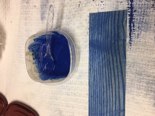

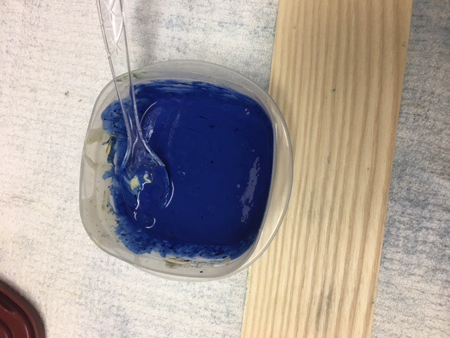

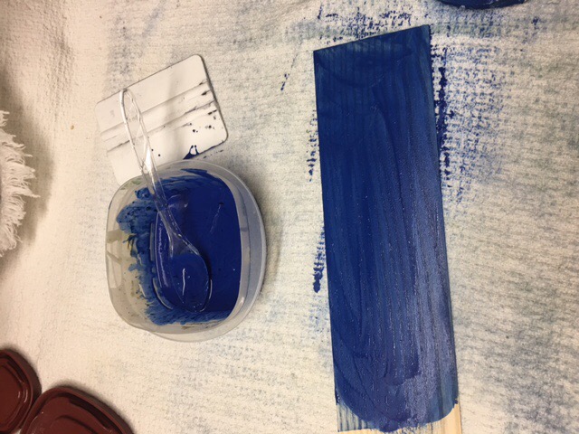

Here you go Sergeant,
Here is what it would look like to grain fill with blue timbermate and sand back to only leave grain accented.
You can see the mixed color, applied and rubbed in grain, scrape off excess, and then sanded back.
Hope it helps

Legend. Thanks Drummerdude :) I love it, I think it'd make for an interesting looking guitar. My wife is scrunching up her face at it. Out of curiosity, what type of stain did you use?
I used transfast water soluble dyes. You just mix them with warm water and you can make the color as light or dark as you like. I hope it helps..
