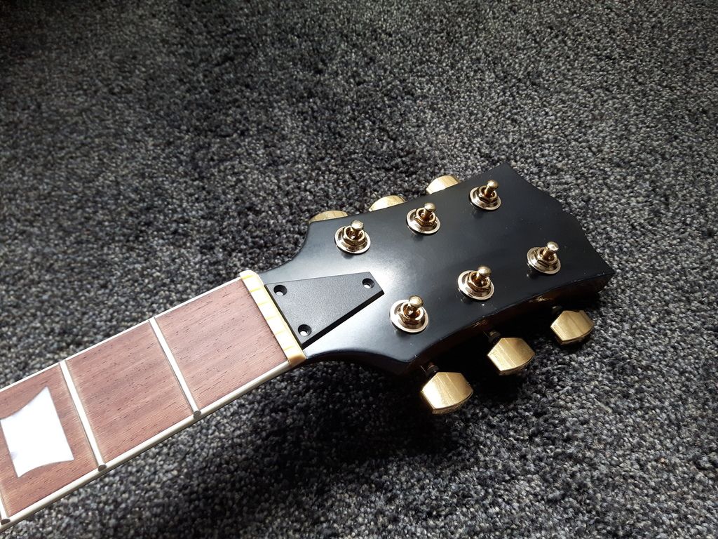

And the finished headstock, with the tuners/machineheads quickly installed for a complete picture.:cool:

This LP is going to be a dead sexy effort. Love your work Thijs!
If you can, toss the truss-rod cover and get something with some sexy curves. Those straight edge rhomboid things just don't suit LPs. It doesn't have to be a traditional Gibson "bell" shaped one, just something without the straight lines.
Standard TRC must go, I whole heartedly agree. It's a good place for a subtle custom, personalised touch.
Nice headstock but I agree with the others; get a nice looking TRC instead of the stock one...
Yep I agree looks av compared to the finish
Thank you guys!! I appreciate the feedback!:)
I had the same thoughts about the trussrod cover, that's why it's not bolted on yet. I'm thinking of shaping it to my liking or else banning it to the garbage-bin.
Anyone an idea where to find some nice ones online, or should I visit the local guitarstore?
Just Google for 'Les Paul trusrod cover' and you'll find plenty shops who sell's them online.
