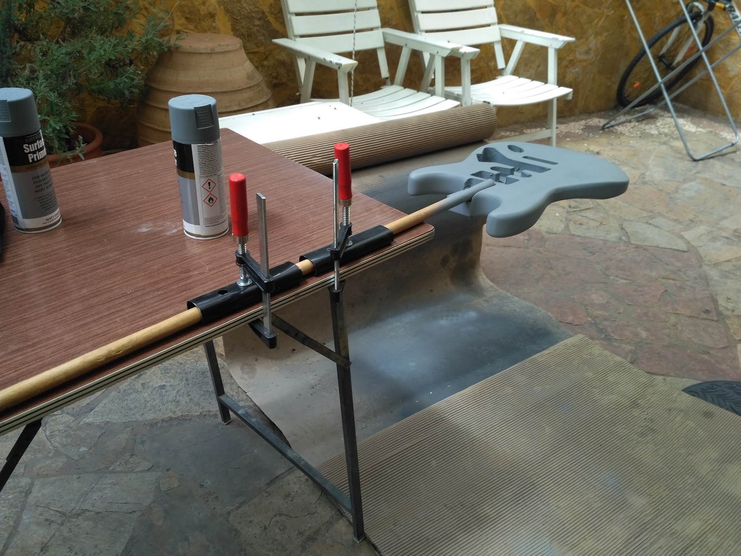

At last a good shiny day in Greece!
So i came up with a working bench for the guitar painting.
Attachment 19258
And i did the primer. 5 coats pf it just to be in the safe side.
I'll let it dry over night and tomorrow i'll do the sanding!

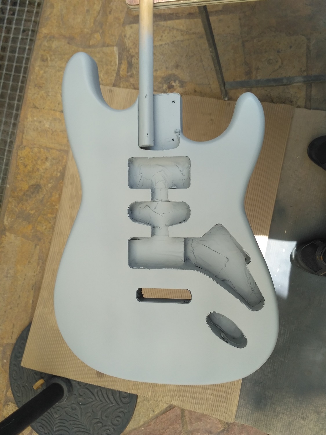

Attachment 19259
George, it looks like you've masked off the neck and control cavities. However it's important that the paint extends into those areas by a few mm, rather than stops right at the edge. If you don;t continue the paint over the edge by a short distance, the paint won't stick to the sharp edge properly and you'll get it peeling or chipping off. I'd move the masking tape down a little bit and make sure you get some primer and then the colour and clear coat so that it goes over the edge.

This is what can happen if you don't take the paint over the edge a bit. http://www.buildyourownguitar.com.au...l=1#post122369
Will do Simon. I've left only a little gap. I'll make it bigger. Thanks!
