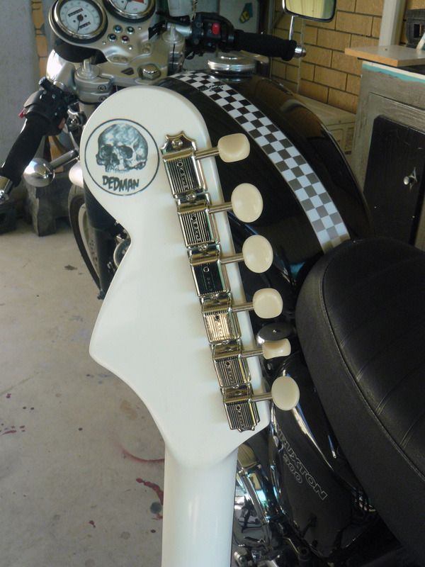

Back of the head stock

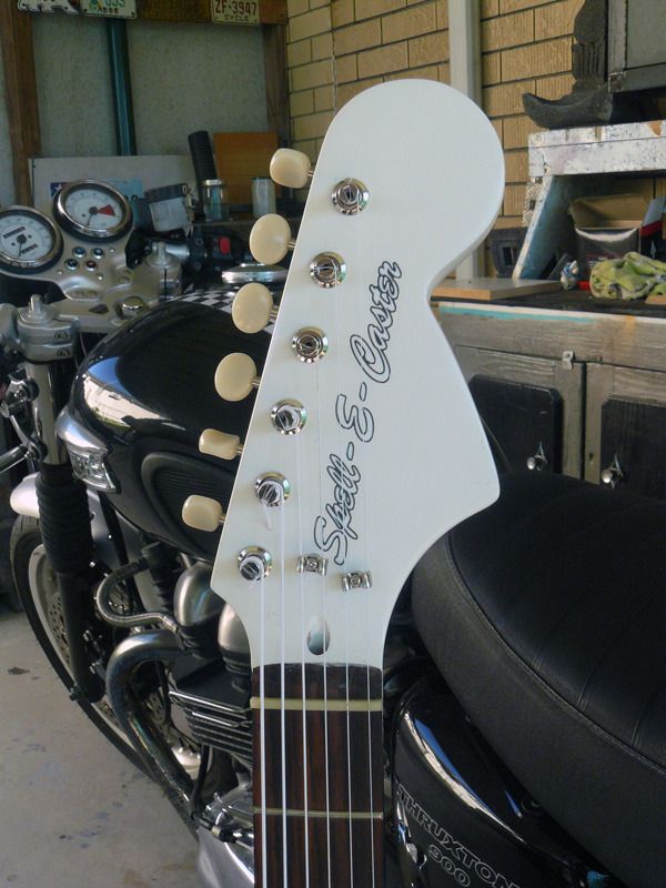

http://img.photobucket.com/albums/v2...psqhdlzlpk.jpg
Front.I should have remembered I still had the string guides to go on when I applied the decal...lesson learned

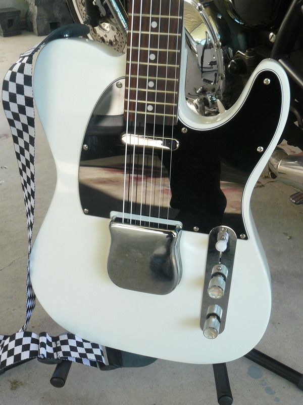

http://img.photobucket.com/albums/v2...psq3vure7o.jpg
body front , a few little flaws that again...lessons learned

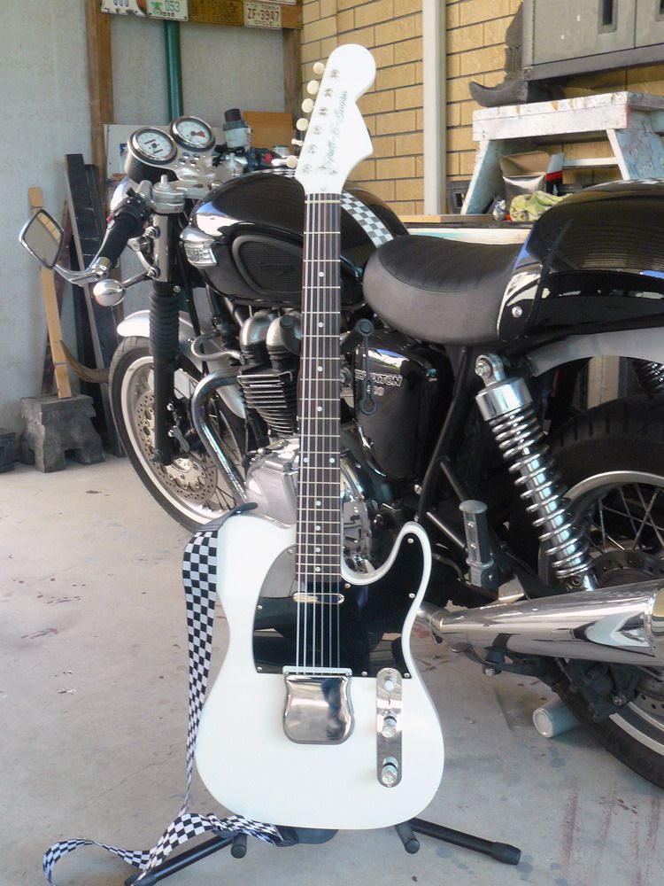

Full shot
http://img.photobucket.com/albums/v2...pspsnv2t9b.jpg
