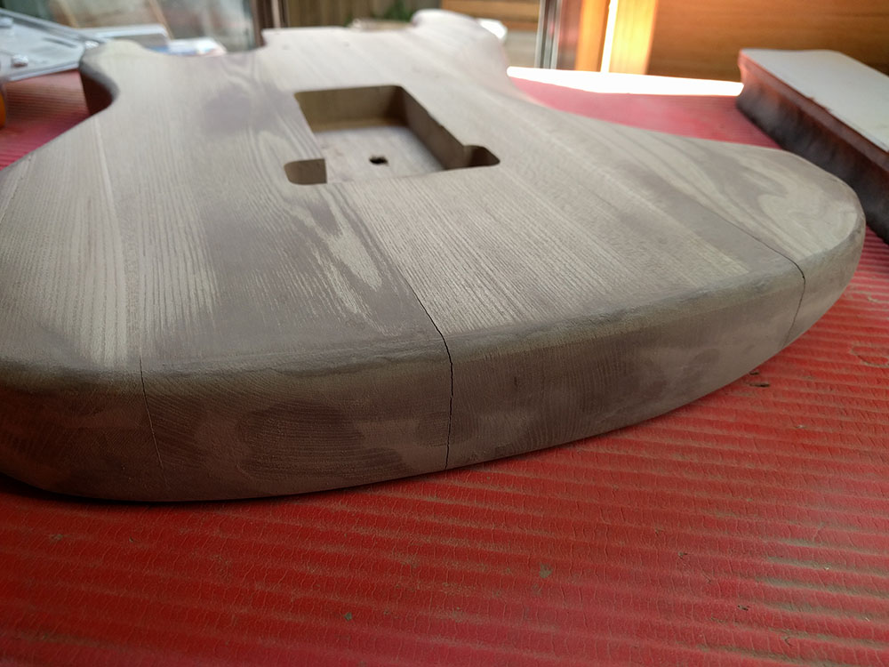

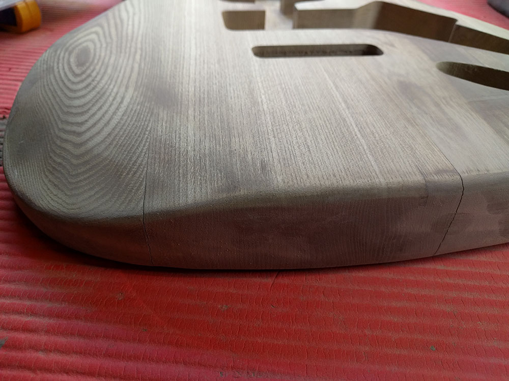

So I'm getting there on the sanding, but the cracks on the joins seem to be getting worse:
Attachment 8345Attachment 8346
It could be because it's been left in the hot shed but I'm not sure
Do I have a go at applying some more timbermate slurry into the cracks or is there something else I should try?
Hi Maddog, those cracks do look worse, in a hot shed the wood will expand and compress and cause this.
I'd get some thin superglue with one of the thin nozzles and get as much glue in the cracks, let it dry, then get as much timebermate in as you can
It looks like there's no glue at those parts of the joints. The heat may be taking the moisture out of the timber, causing it to shrink back like that.
Would getting some moisture into the cracks close them up, maybe? But you'd have to get some glue in there to slowly dry once it's expanded... just thinking out loud for you...
I do have some titebond, need to work out a way to get it in the gap though
PVA glue can watered down a bit. The theory I've heard is that slower drying wood glues create a stronger bond because they have longer to penetrate the fibres further. Perhaps moistening the crack, and applying PVA will make the timber swell as the glue dries. DB probably has experience in these things!
I've never tried Titebond, so I don't know how to use it... I have to get to that large blue shop and get some before they go belly up!
titebond has about the same workability as pva so sawnny's suggestion should work fine

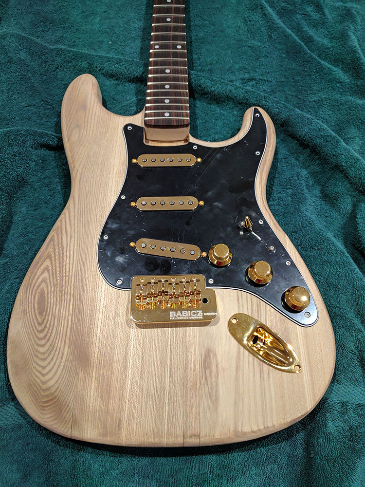

here's where it currently stands:
Attachment 17206
Need to clean out the neck pocket (carefully) so the neck fits
Also need to adjust the height on the tone pots and the input jack
plan is to do full mock build from there before moving on to Dingotone

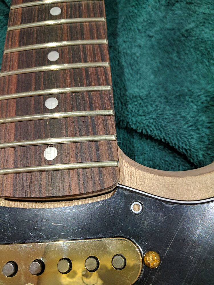

Got the neck to fit:
Attachment 17217
Need to shave the pickguard now. The problems with upgrading everything.
Looking good to me. And at least you can solve your pickguard problem by removing material. A lot harder when the gap's too big!
