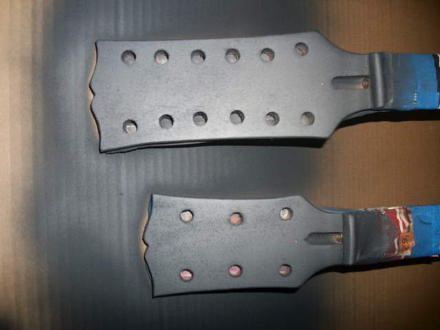

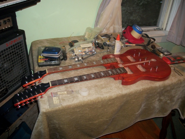

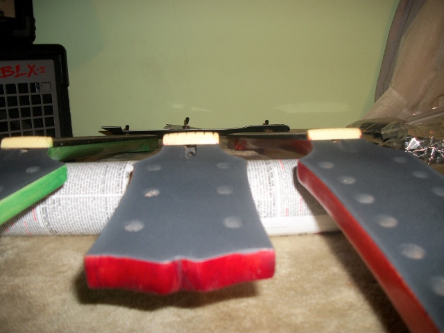

Hey guy's, I've made a bit of progress on my build and thought I might put some more pics up. So, here she is ready for spraying the headstock.
Attachment 4575
Attachment 4576
And now for some flat black.
Attachment 4577
Attachment 4578
More to come. Cheers!
Here are a few more.
Attachment 4579
I gave that a good rub with 4-0000 steel wool between coats, and eventually did 6 coats of flat black. Here are some more.
Attachment 4580
Attachment 4581
Attachment 4582
Now to mask again for clear coat. Stay tuned.
Masked and ready for clear coat.
Attachment 4583
After 3 coats of clear with a light rub with steel wool between coats.
Attachment 4584
After 5.
Attachment 4585
After 8 coats of clear and since I'm not going to push my luck with a headstock logo, ready for the tuners.Attachment 4586
More to come.

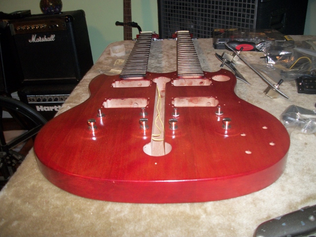

Here we go.
Attachment 4587
Attachment 4588
That was the easy part. lol! Those little screws were a bugger to screw in with those precision screw drivers. I got blisters on my fingers and haven't even played her yet! Then my son handed me a good screw driver. Much easier. Doh!
Attachment 4589
Next, the saddle pins.
As promised.
Attachment 4590
Another angle.
Attachment 4591
Attachment 4592
One more.
Attachment 4593
Next will be the wiring. Wish me luck guy's. From what I've been hearing, I'm gonna need it.
Cheers!

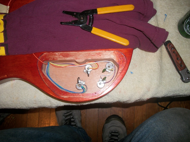

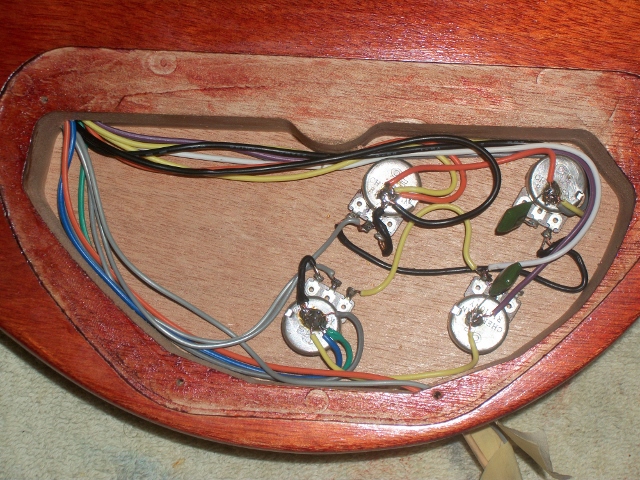

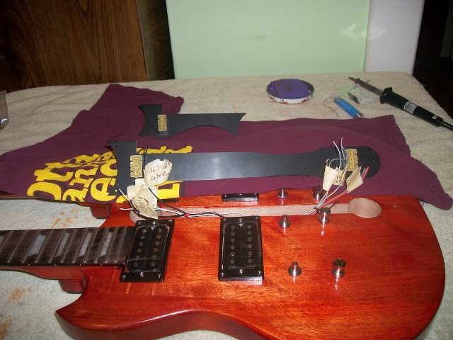

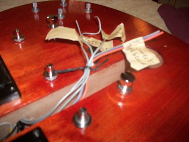

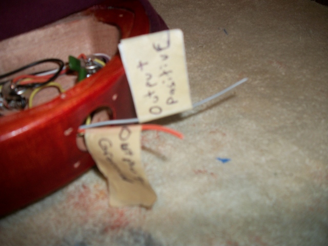

OK, so a bit more progress on the build. The wiring has begun. Some pics:
Attachment 4706
Attachment 4707
Attachment 4708
And another.
Attachment 4709
More pics to come. Cheers!

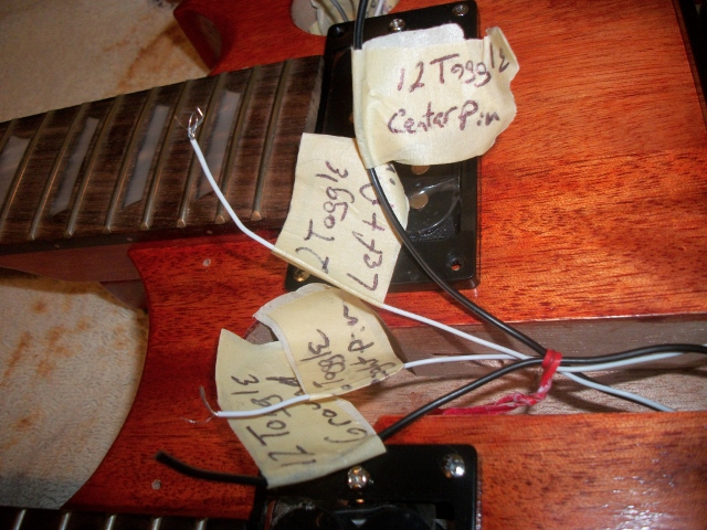

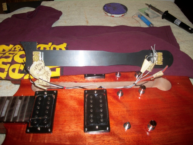

Here is the front.
Attachment 4710
Attachment 4711
Attachment 4712
Attachment 4713
Now to button up the toggles, test the circuits, and string her up. Stay tuned for more fun and adventure!

Should be good Pablo, I used the PBG wiring diagram. Thanks.
looks excellent Steve, I love the way you labelled the wires, avoids confusion.
I need to rewire mine so will use your approach.
Very tidy job indeed. Are you going to copper shield the cavities ? could lower the hum and interference.
Also glad I saw a Heineken stubbie on the workbench.
Thank you Woks. Yeah, labeling the wires was the way to go for sure. I thought about shielding the cavities but since I'm so far out in the boonies I'm hoping it wasn't needed. If she has a hum, I suppose I can always pop her apart and try again. And yes, I have a bit of a sweet tooth when it comes to those Heinies. LOL! Cheers!
mine took about 2.5 PBG copper shielding kits to shield there's so many cavities in that body !
But with all that shielding it only takes one stray bare wire to make contact with the shielding and earth the signal.
I see you have a heap of wires going back to the main control cavity for earthing
Uh huh. On the PBG wiring diagram it said that the purple wires weren't needed if the cavities were shielded and the pots came into contact with the shielding, so I took a chance and decided not to shield. I'll let ya know how that works out. Lol!
Better to be safe than sorry. I ground the back of pots as well as shield. In my house (old wiring, tons of fluoro lights), shielding is a necessity.
If problems arise, I have ample time to shield as I've been retired since 1998. This is my 1st build so I'm still learning. Thanks for the tip though Pablo.
So after completing the wiring, only the 6 string neck worked. I ended up pulling it all back out and shielding everything as was suggested. I also used the GEAR4MUSIC wiring diagram instead of the PBG diagram but did use a bridge ground and now she is working great. Still need to do some fine tuning and adjust intonation but so far looking pretty good. Will post more pics soon.
