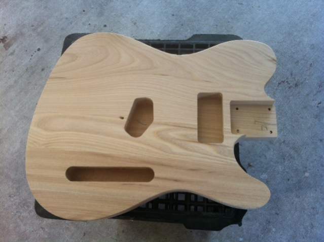

Well time to update the diary. Shaped the headstock and given a couple of coats of true oil, to see what the natural finish looked like, and think it may look alright with the Jarrah stain on the body. Still might change it to an Old Baltic colour. Undecided.
The body itself has had a few subtle alterations, mainly on the lower horn and a slight cut on the upper heal of the body to make the body less square. A slight arm cut is also planned for this area. Not traditional I know, but like the way it is shaped. Only sanded to 60 grit at the moment, sander died.

Good stuff mate. I like the angled body - reminds me of how ESP do their SG models.
Nice idea with the strat stock too - I love it when people mash fenders up!
looks awesome Jeff, well done, nice mash up of strat and tele as Nicko says.
Old baltic could work very well could be worth trying some in the area under the pickguard.
I'm sure the grain will pop whatever you do
Great mods, really clever. Loving the look of this.
Love the body shape Jeff! Interested to see how she looks with some colour.
nice work Jeff. Good to see something different
Looking like it's going to come up beautifully Jeff like the others I love the grain.
My only comment would be that if you are going to do tummy or arm relief make sure it is faired in rather than the angular cuts that are found on nearly all kits with the cuts. ( maybe this avoids expensive legal action )
I have sanded these right out on my PBH-4 and STA so that the transitions are smooth and flow.
No criticism of kits here they are what they are and we make them our unique creation with the little ( or large ) mods that we make to them
