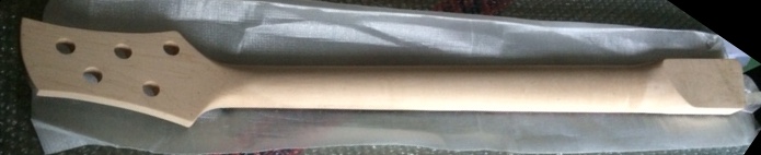

The Dingotone Colourless Neck Finish kit arrived in the mail today.
I'd already sanded the neck before I started on the body as the predrilling decisions had all been made.
So this:
Attachment 2792
has become this:
Attachment 2793
The colourless as the name suggests doesn't change the colour of the wood so much as it deepens the contrasts.
I like how it looks.
Now to let it hang for a week. In the meantime I'll find where I hid my waterslide paper and design and print a headstock logo.

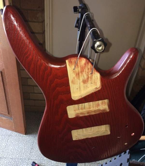

Applied the first intensifying coat yesterday.
Attachment 2830
Still a little "wet" in the picture, but if it keeps any of that red tone I'm going to be pretty happy with it.
Give it a few more days and it'll get the second coat.
Very nice indeed
Got to be happy with that Tindrrel. Got to love dingotone on ash!
