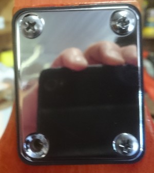

Today when we were making the second attempt it was going great until I was tightening the screws and one of them broke. Now I have 3 screws in nicely and one screw snapped in half with one half in the neck and no chance of removing it! See image:

Any suggestions on what if anything I could do?

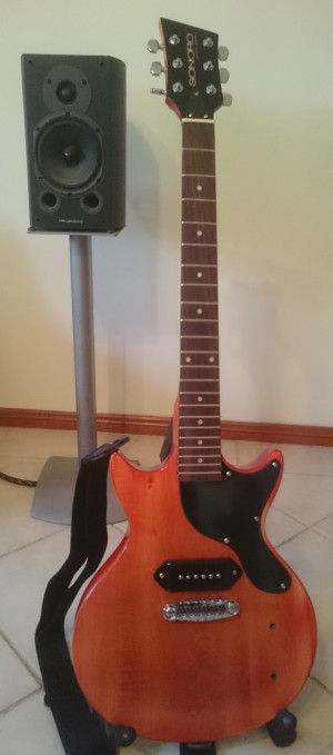

I have assembled the guitar with all its accessories, the wiring harness goes in next and then the strings, if I can overcome this problem with the neck screw.

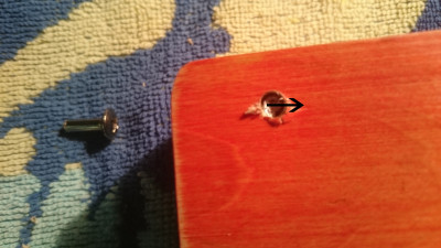

I removed the neck and it came off cleanly. In the image you can see that the screw has snapped at the end of the thread and the remaining part is embedded in the neck.

Oh., tricky one. Screw looks wide - maybe wide enough for one of those screw extractor tools? Last time this happened to me (as a last resort) I had to cut around the screw then drill hole/plug with dowel but the screw was tiny -too small for said tool.
