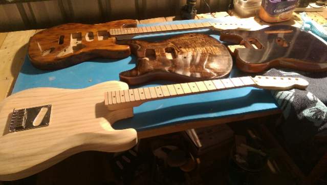

1 Attachment(s)
Getting there!
Attachment 88
OK I'll bite. Carved top tele. Wicked.
Thanks guys. Now to get some of these finished!
nice collection Andrew ! coming along well
Aaaaaaaand I uploaded the wrong pics.
This is easily the best one of these kits I have seen.
