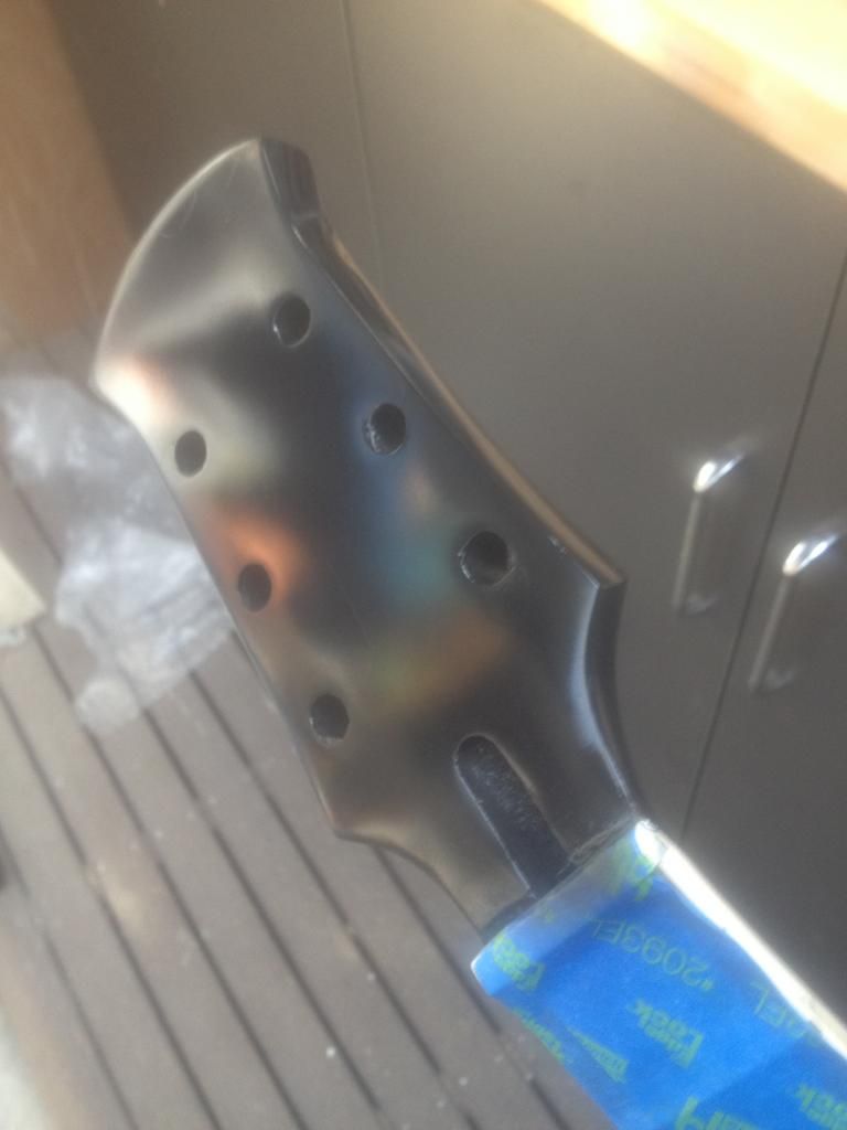

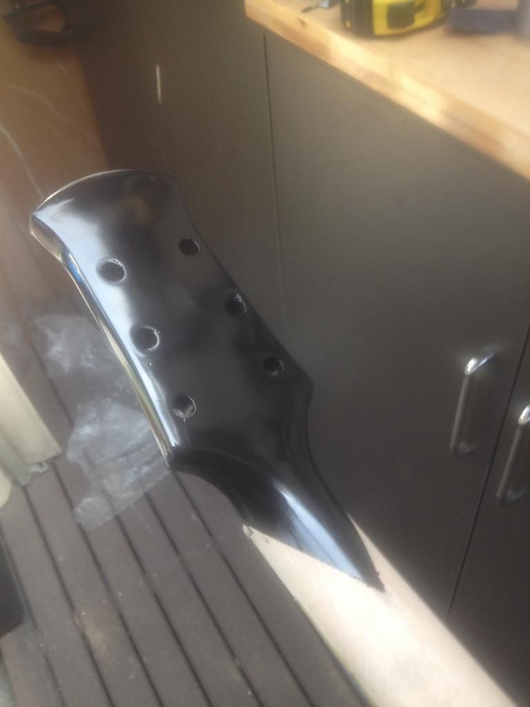

I'd be trying the "steady as she goes" method. Just slight back and forth wiggling, whilst pushing back in. It may even have to come out a bit further before going back in to it's proper spot. The biggest issue's gonna be keeping it there once you get it back in the right position.
I think it's just excited to have some colour on it.
How much tension is on the rod at the moment? Have you made any tweaks to it, like doing a fret level or anything, recently? If you hold the neck vertically with the headstock up and the tension off, a few gentle taps upwards on the butt of the heel with a mallet could coax it back into place.
yeah Stan just tap it in slowly, even tap the top of the headstock lightly to give the whole rod bit of a jolt, I've had this happen and luckily the rod tapped in pretty easily. Don't use too much force. Think once you get it in place it should stay there.
Looks like from that photo the truss rod got excited, must have seen another nioce axe nearby hahah
Stan
the rod on my Black junior did that. It'll be sloppy up until you do a string relief on it. On mine it pushed back easily.
PK
thanks guys, it tapped back in without too much hassle

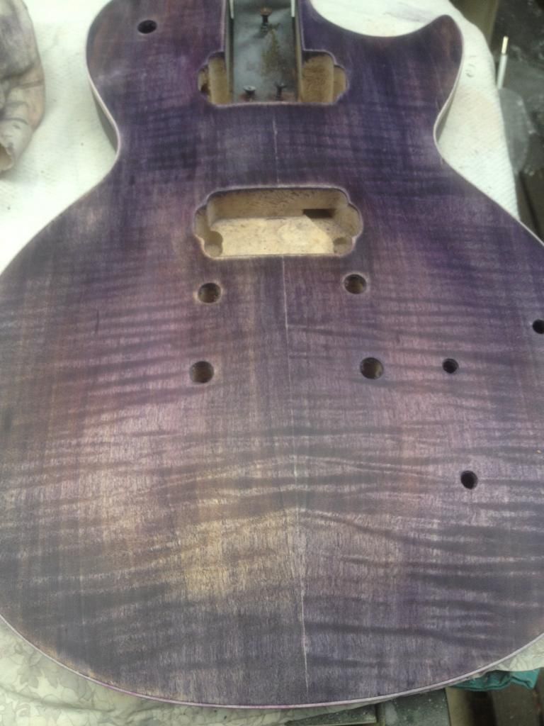

Sanded back the coffee stain, but just to knock down the grain, most of the colour stayed on. Then with a mix of red and blue printer ink, the purple stain is made:
http://i271.photobucket.com/albums/j...20LP/001-2.jpg
http://i271.photobucket.com/albums/j...20LP/002-1.jpg
first layer of stain:
http://i271.photobucket.com/albums/j...1e12a6d71a.jpg

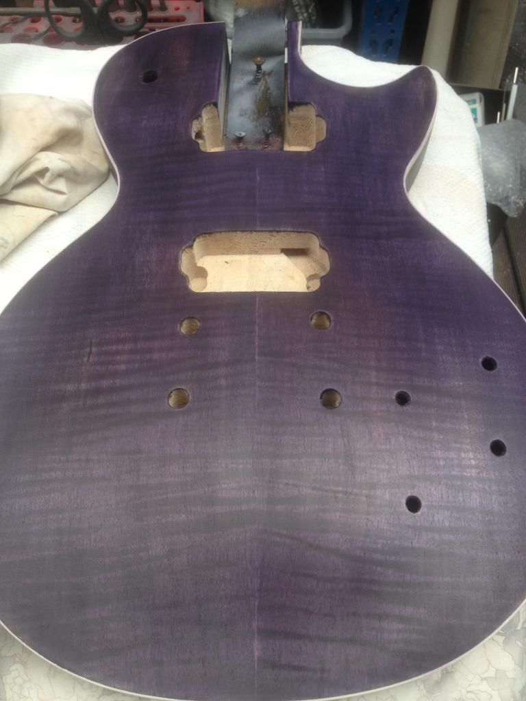

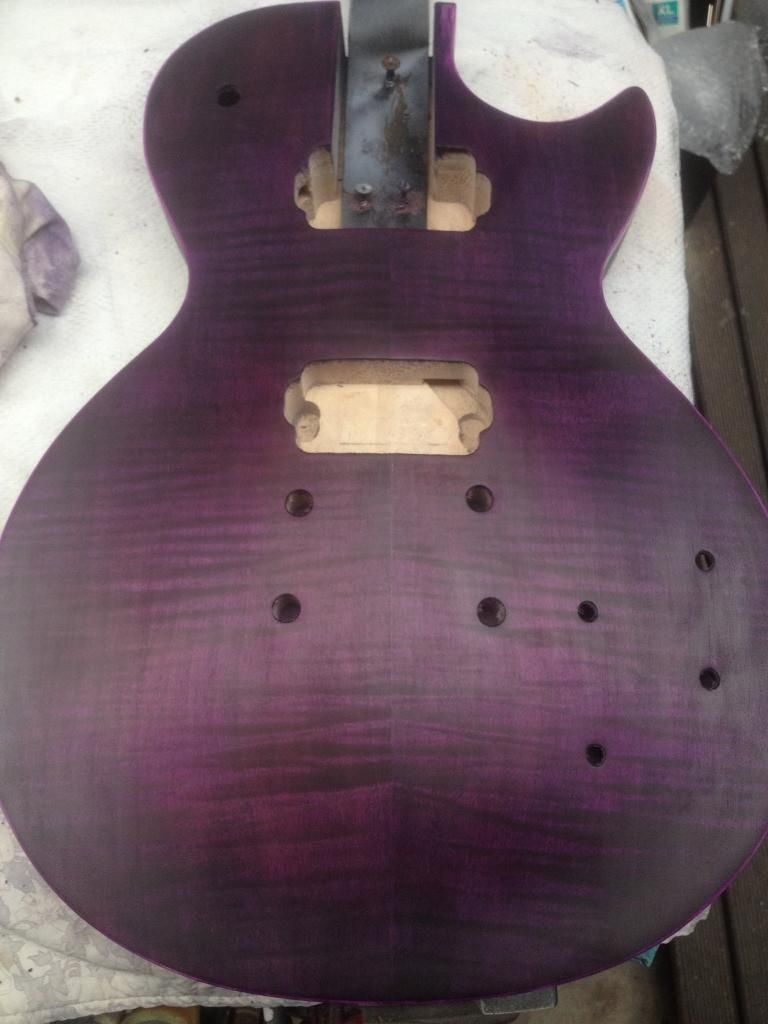

The body with the first treatment, not enough ink and a bit patchy:
http://i271.photobucket.com/albums/j...20LP/008-1.jpg
Crappy iphone pics , sorry.
Rub back, used 220 grit, and it came up very smooth, hoping it would give some bite for the ink:
http://i271.photobucket.com/albums/j...l%20LP/009.jpg

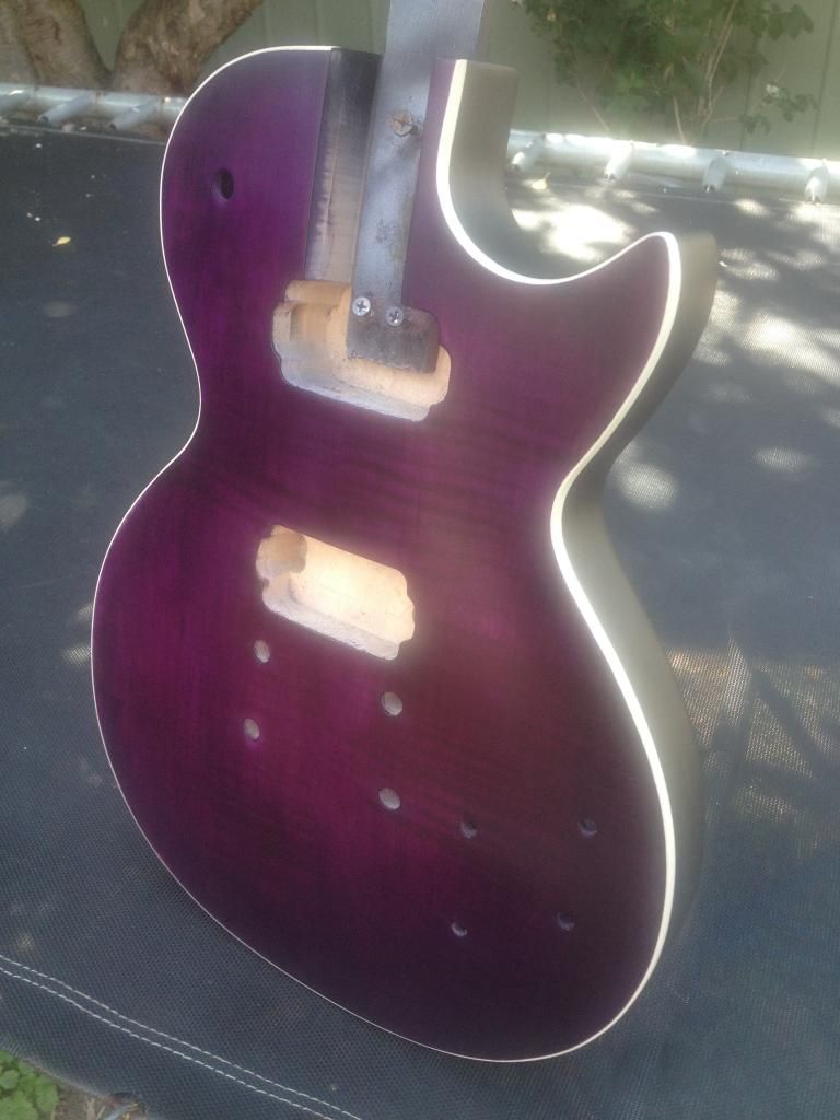

The new ink over the top, much more even and the colour was exactly what I wanted. Used a mixture of onto a pad, and drops directly onto the body. You don't need a lot. Very similar to the colour I mixed originally, covered well and no reactions.
http://i271.photobucket.com/albums/j...l%20LP/010.jpg
So it will look something like this but glossy:
http://i271.photobucket.com/albums/j...20LP/011-1.jpg
It will dry for a day or so and I'll see if it needs any touch ups.
Interestingly it soaked into the outside edges a bit more, giving a very subtle burst effect...
wow Stan I love the colour and the depth you got. This will be an awesome looking axe.
You given me ideas to try this ink out !
Interested to see what other colours are available. That dark blue on the outside of the quilted top looks superb - took me 5 mins to find the guitar haha
Wow, that colour is lush! This is shaping up to be a cracker.
Thanks Wokka, the middle pic is pretty close in colour to what I got.

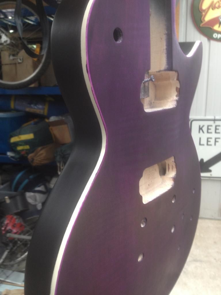

more pics time. binding cleaned up
I cant believe how crappy my iphone pics come up on the forum, oh well...
http://i271.photobucket.com/albums/j...20LP/004-1.jpg
http://i271.photobucket.com/albums/j...l%20LP/006.jpg
http://i271.photobucket.com/albums/j...l%20LP/005.jpg

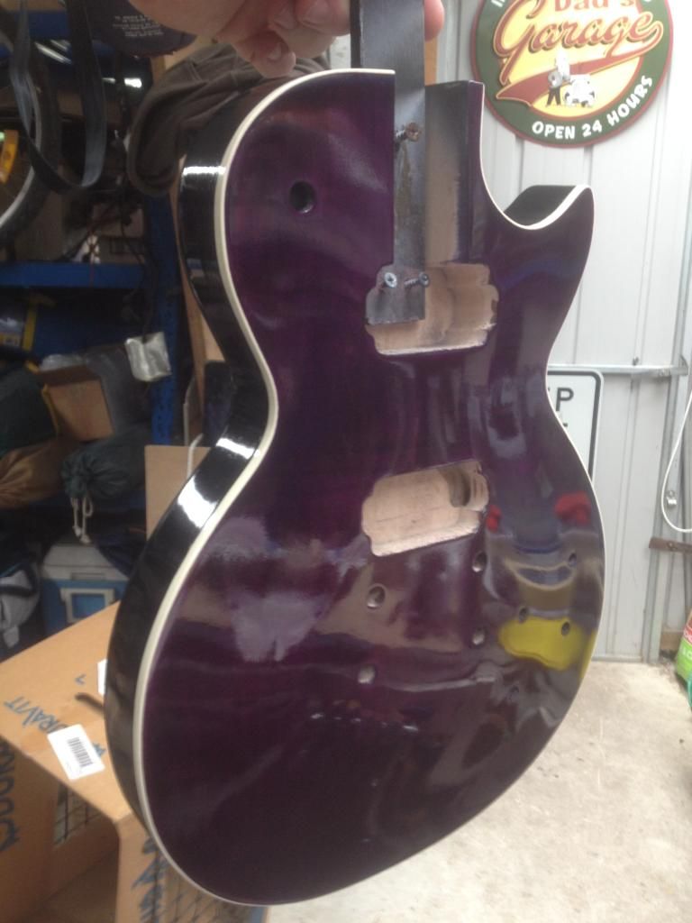

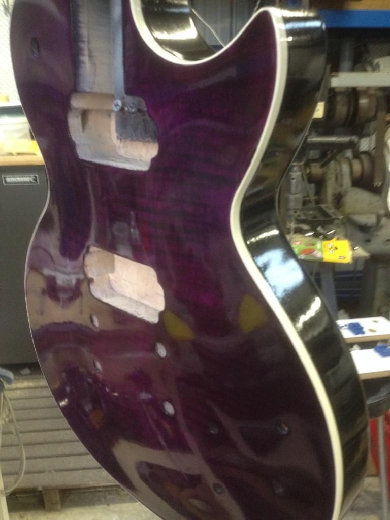

About 4 coats of minwax wipe on poly:
http://i271.photobucket.com/albums/j...20LP/002_1.jpg
http://i271.photobucket.com/albums/j...20LP/005_1.jpg
My god that looks amazing. Is that still wet or dry? So shiny.
thanks Niko - a bit wet/partly dry , but looks similar dry, very shiny
