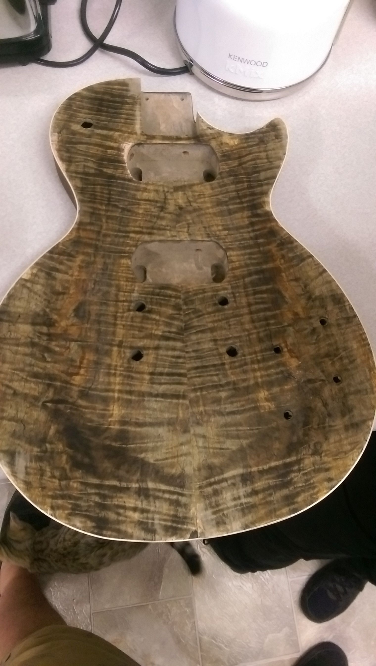

Clear acrylic coat to seal her up, practicing bursts with the new air brush. About to lay the first pass of the burst on the guitar. Nervous now.

I wouldn't even do a burst man. That top is just so so gorgeous. I wish I could work with spalted maple but I've got a compromised immune system. Risk/reward isn't worth it for me.
That sucks man. Even with a respirator and long clothing will you still have issues?
And it's too late haha. Burst is done. Paint is still a bit damp hence the shiny spots.

Besides, kind of needed that solid edge to mask the veneer chip bogged with black timber mate.

looks good the burst Andrew, you might need a bit more black paint to hide the filled chip area. Nice use of the PBG box to do a dummy burst run !
Haha yeah. The many uses for the pbg box. My wife used the other half for something as well. Going to fill the gap with some super glue when the black dries. I'll shoot another pass over the area to level the colour out then I'll clear this one and the candycaster tomorrow.
