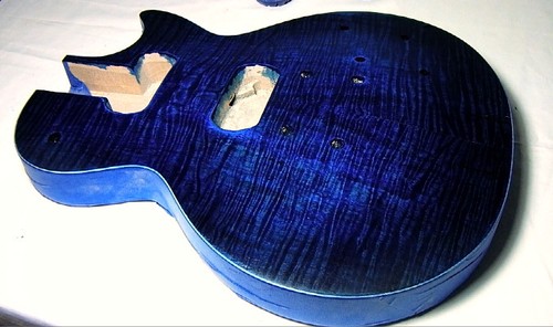

First go around with the ink. I was going to thin it out with some water, but that never got me a colour I was happy with. So, straight ink.
http://i.imgur.com/8Tf4gWn.jpg
This was the last of the sunlight for the day, so it's the best pic. Promising.
It was a still a tad too light, so after a couple of hours, I hit it with another round but only on the outside and then feathered it into the middle for a subtle burst.
http://i.imgur.com/y3jxETG.jpg
http://i.imgur.com/h9yS1T9.jpg
Crappy pics under a flouro light so the colour is not too accurate, but it's darker and I'm quite pleased with the result. I'll see if I can get a better pic in daylight this afternoon.
A nasty surprise confronted me when I pulled up the tape though.
http://i.imgur.com/kvlDijx.jpg
Ouch. I'm using 3m painters tape, but it might be getting a bit old. Must be more careful from now on. But, this pic has the best representation of the actual colour.
Tonight I will scrape the binding and possibly put one coat of tru oil on to seal it before masking again and fixing the damage. :)

Made some good progress last night. Cleaned up the binding.
http://i.imgur.com/MXecDSO.jpg
Masked off the front and hit the back and sides with more ink.
http://i.imgur.com/mgIDJyy.jpg
Some of it ended up a little green, nothing off-putting though. The back has come out a bit darker than the front, unintentionally, but works really well. Happy little accident.
Masked off the face of the headstock and coloured that too.
http://i.imgur.com/UX0qKhz.jpg

Looking schweet! The ink even takes to Rock Maple nicely, which can often be a problem with other stains.

How many coats of ink did you put on the front and back/sides ?

@Wokka. One and a half on the front and one on the back. The wood just sort of stops taking any more ink when everything is covered evenly, the excess just rubs off. It's a bit odd, but it makes it dead easy to come back 10 minutes later and fix spots you missed first time around. My 'subtle' burst has faded to almost nonexistent.

Pab might sound like a dumb arse question but does the ink dry to the point of rubbing and no ink comes off.
Not a dumb question at all Jarrod, because as I found out this afternoon, no. After scraping the binding, I had a slight blue tinge to my hand. No smudges though, I guess by it's nature it's supposed to stay a bit damp. I was a bit worried that the tru oil would make the colour run, but seems to have worked well.
Looking absolutely stunning Pabs. Interested to see how the blue stands up under the Tru-oil. I did a Turquoise top recently and the amber in the Tru-oil turned it basically green. Just something to be aware of. Looking at Fred Yen's build though it didn't seem to happen to him.
All good so far, Gav. I think ash has a tendency to green a bit under blue and there are greenish patches but nothing I can't live with. Question: when you wet sanded your Florentine, did you use water or more tru oil?
