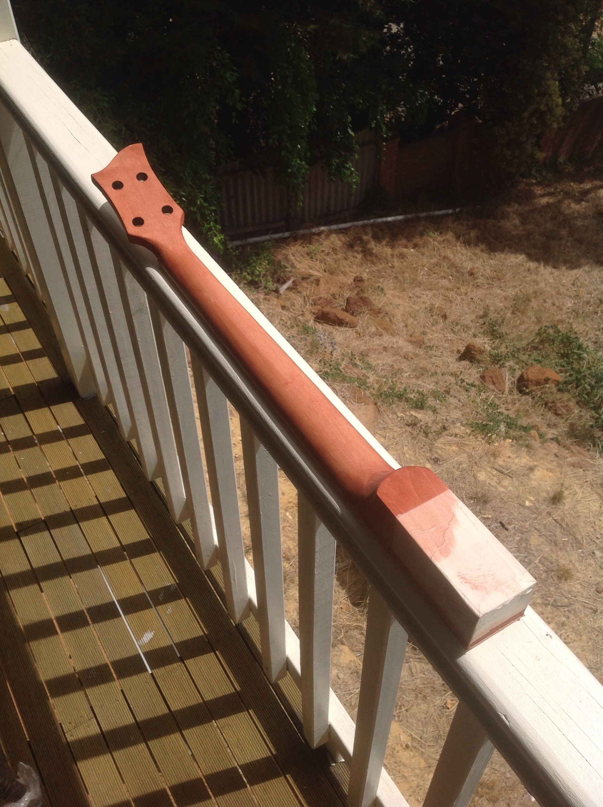

First coat of Burning Sun Base coat. Once this is dry, the bursting will commence.
Editors note- spot the not-so-deliberate mistakes.

Ouch - that's hot mate - looking great!
Man BG that flame top is looking amazing!
