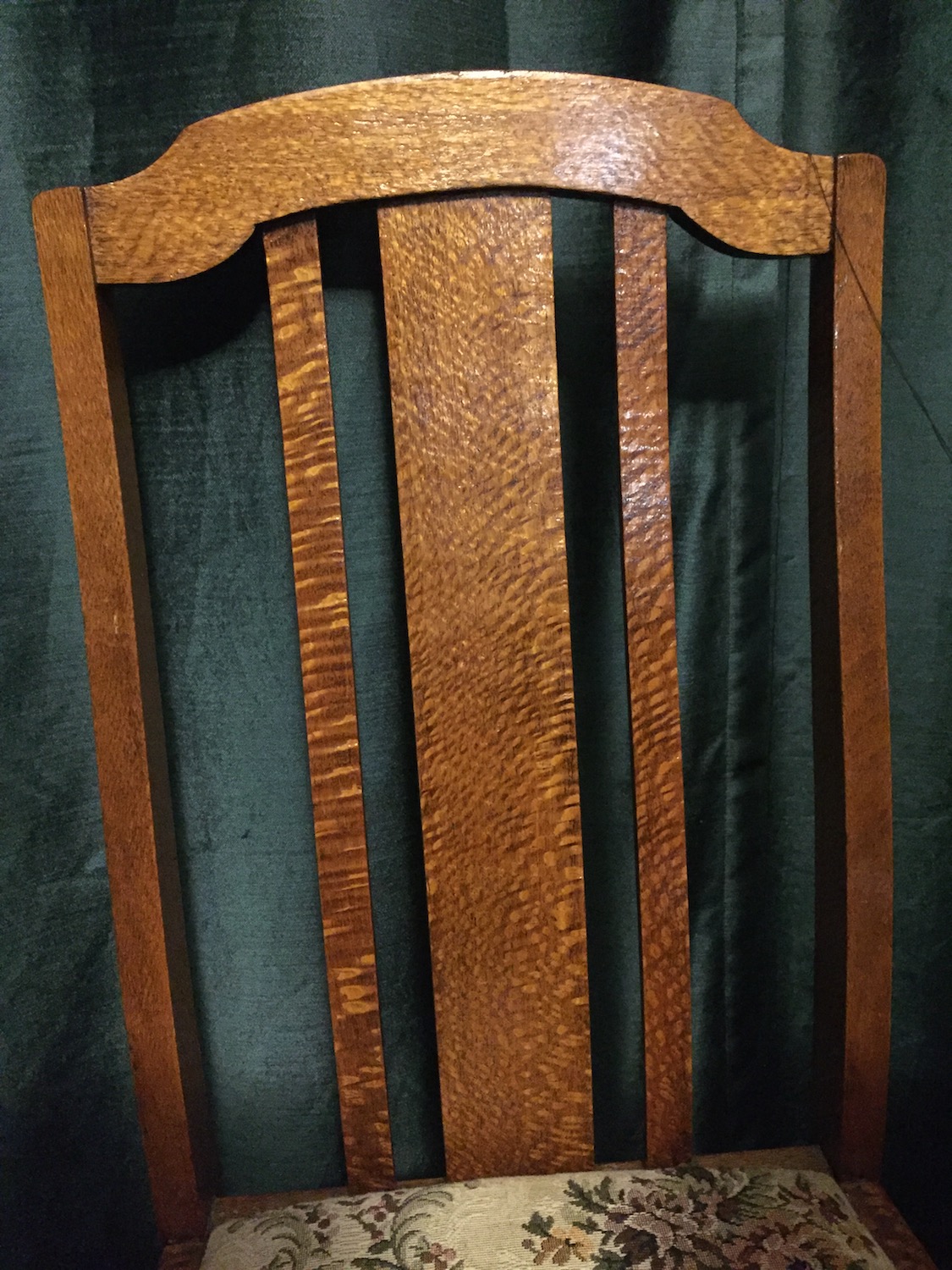

Having said that, I still prefer 1 and 3. I think you need to sand 1, to see the difference between it and 3, and to get rid of the distracting chalk, etc. I'd hazard a guess, and say 1 is a good indication of how the finish will end up - I love silky oak (typically found in Northern NSW, and Queensland. I have a dining setting made from it, and the pattern is kind of similar, but with much smaller markings, so maybe this is indeed She-Oak (which I've never seen in slab form).
Here's a chair, which has varieties of different cuts giving different aspects to the figure.
Attachment 40269
