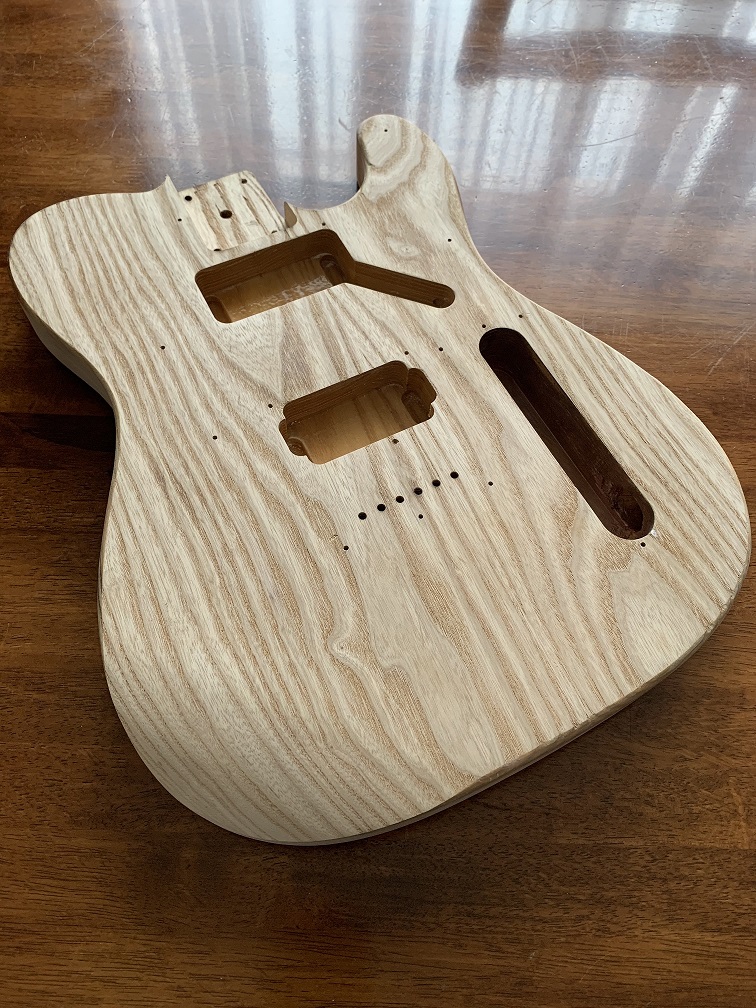

28 coats of Tru-Oil in, it's now waiting a week before final wet sanding.
To get to 28, I wet sanded with TO and 360grit for the 10th coat, and with TO and 800grit for the 15th. Then a regular wet sand with 800grit after 21 coats.
https://i.imgur.com/YvonS5b.jpg
https://i.imgur.com/y74efgE.jpg
https://i.imgur.com/jDydJwW.jpg
I'd do some things a little differently next time, but happy with how it's turning out.
Nice! I like that much better than the original. Good job.
Personally, I would have skipped all the wet sanding in the middle and just done it all at the end, but you got a good result and that's what matters.
If you were wet sanding with Tru Oil as a way of grain filling (aka the slurry method) I would have done that very early on rather halfway through as the idea is to allow wood dust to mix into the oil (or commonly shellac) and create a "slurry" that is worked into the grain depressions. Then sanded flat, repeat, sand etc until a flat smooth surface is achieved.
That method can (should?) be done before applying stain/dye because you sand off all the t-oil/shellac from the flat areas between the grain exposing raw timber for stain absorption.
Anyway, well done! Look forward to seeing it reassembled and getting played!
Yeah, the slurry idea I realised wasn't going to work, because I wouldn't be getting wood dust in the mix. So if anything, it was a Tru-Oil slurry, which I think didn't do any harm, but introduced some edge sanding risk.
I think there is a place for wet sanding with Tru-Oil maybe later on, like after 15 or 20 coats. However, if I've done all the grain-filling and sanding sealer work earlier on, then it should become a redundant step.
I didn't use sanding sealer in this case, and then the regular wet sand at 21 coats was primarily to tidy up some surface irregularities that I'd no doubt introduced into the finish.

Here we are, wet-sanded up to 2000, micro mesh pads 4000 and 6000, then one Meguiars Ultimate Compound polish.
https://i.imgur.com/3iQzJh6.jpg
There are a few unfortunate sand-throughs, but nothing that the 3-feet view will notice. I may go over it with another polish, but otherwise this ready for reassembling.
Noice! Very glassy look to it. Great work!
Looks great.
That looks amazing!
Nice finish dozy!
Wow that looks awesome!
Just weighed the body before I start reassembling, and somehow it still weighs pretty much what it did at last weigh-in: 2.27kg. This is after staining and 28 coats of Tru-Oil.
All of the previous measures were during a long hot dry spell. Then we had a fairly humid period while it was curing, then dry again when I sanded and polished.
Very curious.
