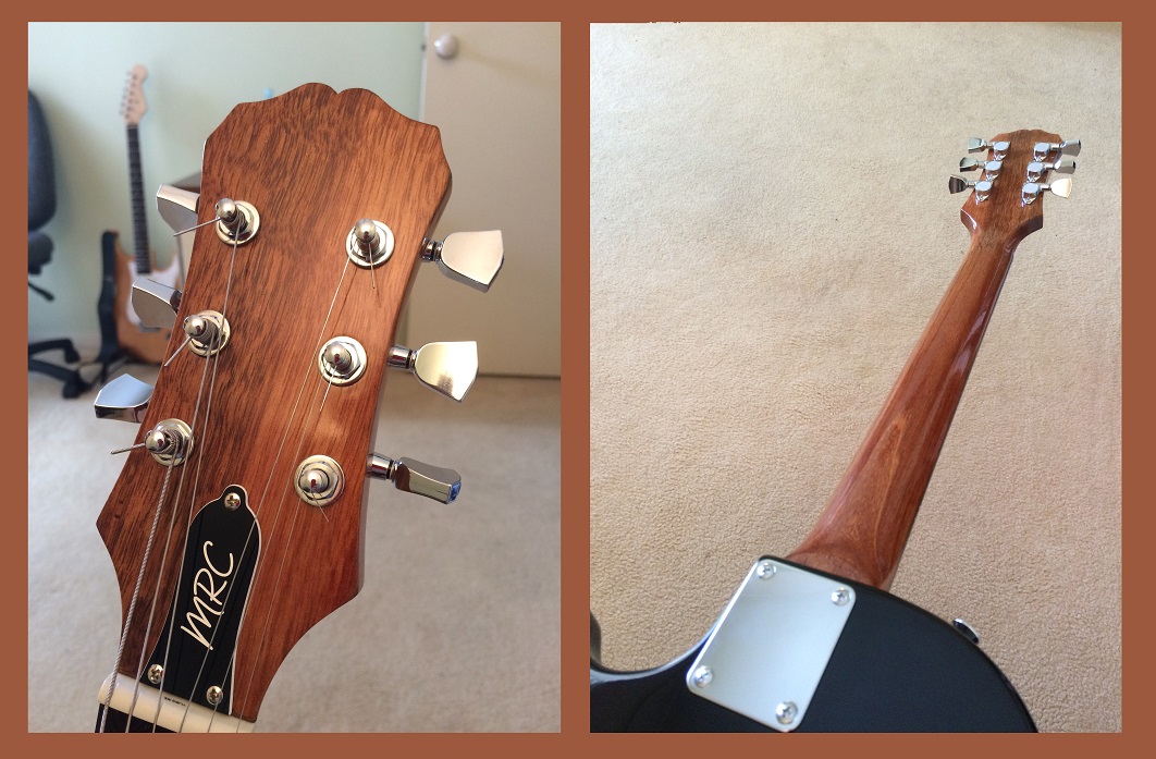

... what are your headstock issues?
The out-of-the-box headstock shape that comes in the kit doesn't give much room to emulate the guitar's inspiration, so it felt a bit half-arsed when I first tried, then tinkered, and then tinkered again. So I've ended up de-pointing it, and hoping it will still look somewhat balanced overall when assembled.
Then, because it also doesn't come with matching veneer, I played around with a non-quilted veneer, and tried to get the stain to emulate the body top. I learnt a lot about applying a headstock veneer, but it really didn't match. So I had the joy of stripping it back.
I've since tried to match it to the back of the body. The colour is not quite there (should have done it at the same time as the body). So I'm either going to persevere, or strip it back again and go with the natural look I probably should have done to start with.
Hey Dozy. Hopefully I'm not piling on to your head-ache-stock, but I just had a look at page 1;post #4 to see the original headstock shape. Have you put the tuners on and checked the string alignment from the nut to the bass E tuner post?
It looks like it will be very left of centre in that photo.
Hmm, good question. I'll have to investigate when I get home tonight.
Body looks fantastic, that's a really nice piece of veneer.
I'd agree with McCreed that it looks like the strings will end up with a slightly splayed out look. It''s a shame they don't provide an undrilled paddle headstock for this kit.
Dammit, that's a fair distance...
https://i.imgur.com/XhGVWmn.jpg
And the top E.
It's just going to look a bit Gibsony.
Yeah, not quite as bad, but a shallower nut groove will make it potentially a problem.
Perhaps lucky I got a graph tech nut...
On Gibson-style nuts, I do one of two things on the D & G strings, depending on whether I'm cutting a completely new nut or work on an existing nut. For a new nut, I cut the slots on an angle the same as the string will follow to the post; for an existing nut, I file a slight flange on the headstock end of the string slot. Either of these methods help with tuning stability by allowing a smoother path for the string to move through.
However, I'd be dubious of angling that low E slot that much to accommodate the tuner post. I think the end of the slot would finish up dangerously close the end of the nut, leaving it susceptible to chipping or breaking.
It may be just fine with straight slots. At least nuts aren't too expensive if you need to try a couple of options.
How does the treble E look IRL? The original photo looks like it will run pretty straight.
Hmm, maaaaybe not as bad as initially thought
https://i.imgur.com/XXqaLyD.jpg
