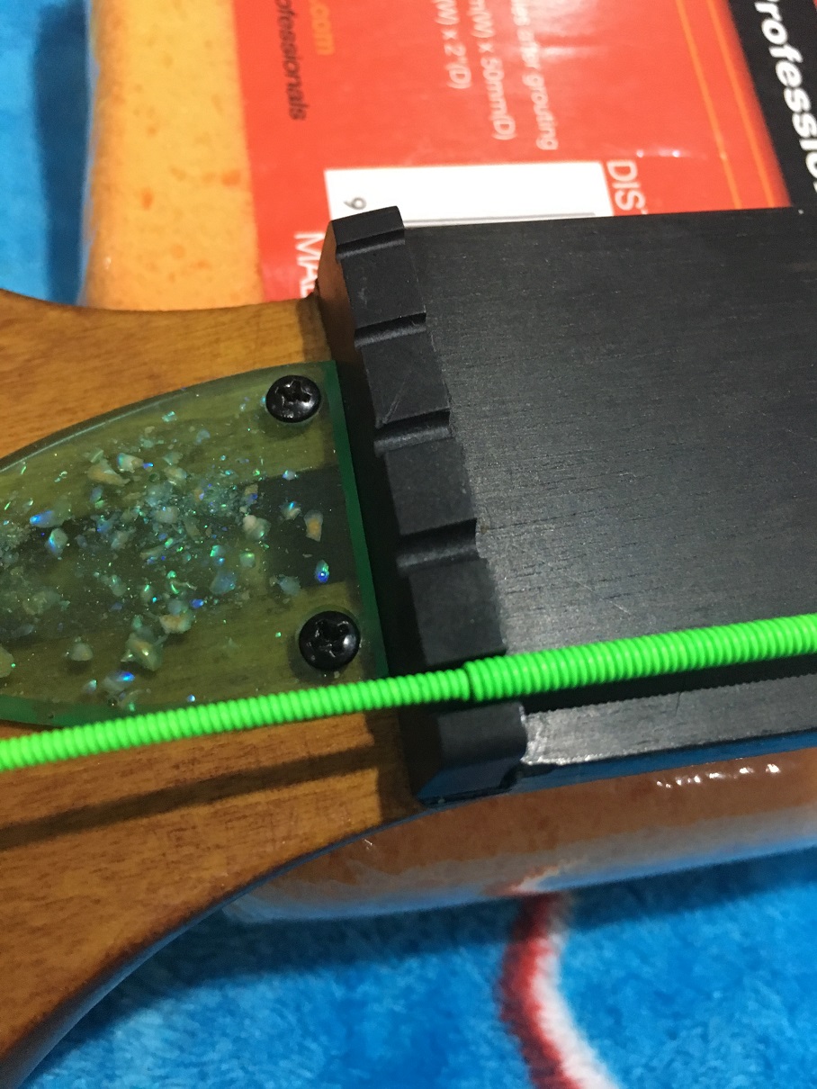

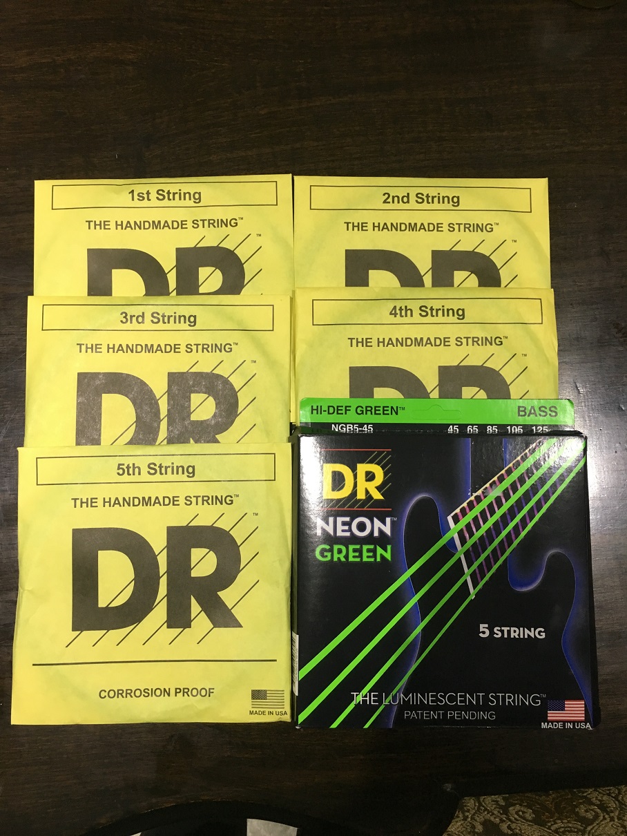

So after much stress and mucking about, these arrived! DR NGB5-45. For those in the same situation as I was in, these were the longest 5 string bass guitar strings I could find ... and they glow under black lights ... yet to test them out!
Attachment 36297
And, although it is a tight squeeze, they fit by the skin-o-their-teeth. It looks strange in the picture, but it does work trust me!
Attachment 36298

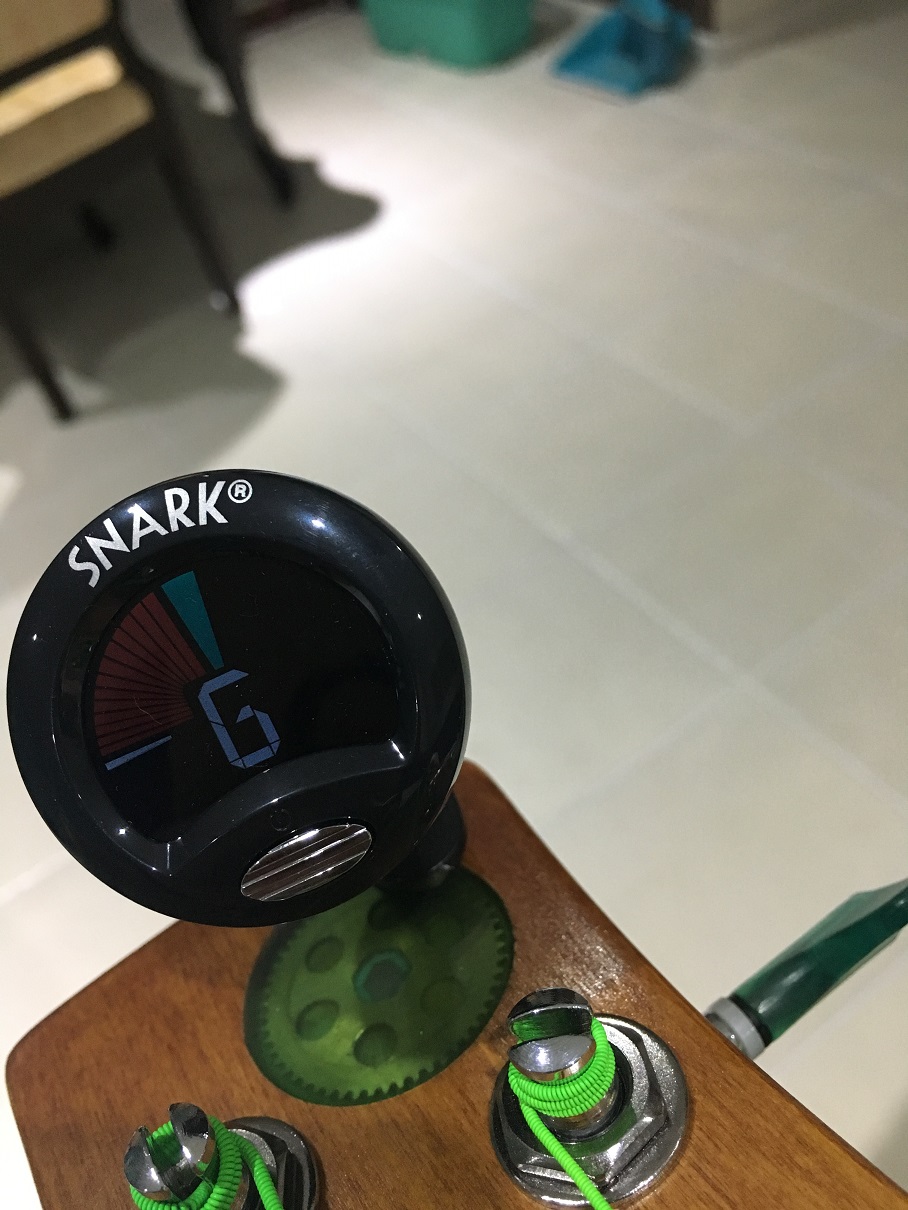

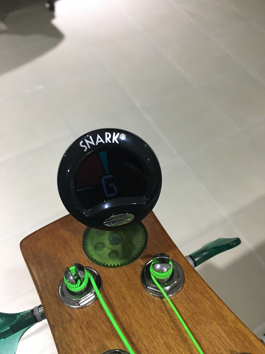

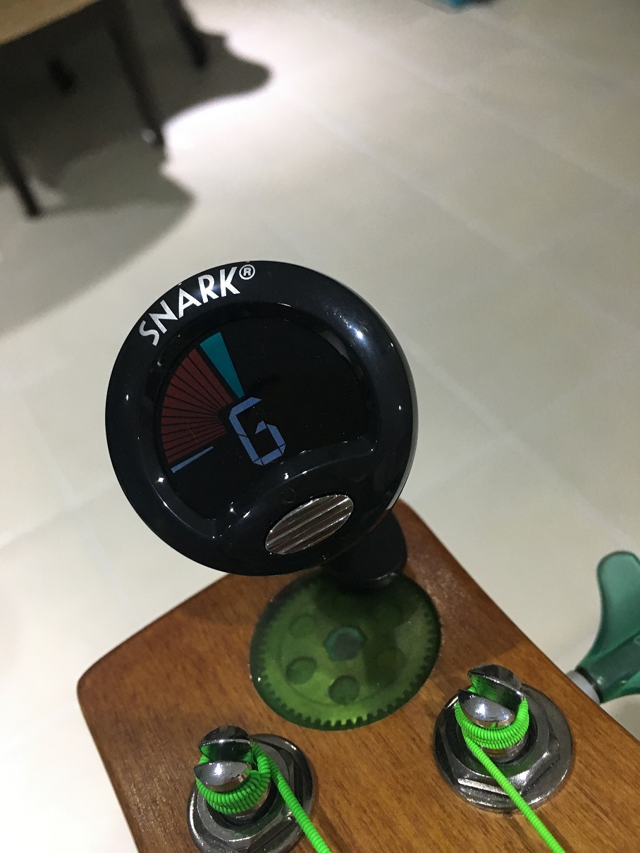

This proved more tricky than I had hoped.
First attempt, the open G versus 12th fret ... was a little sharp
Open G
Attachment 36300
12th Fret G
Attachment 36301

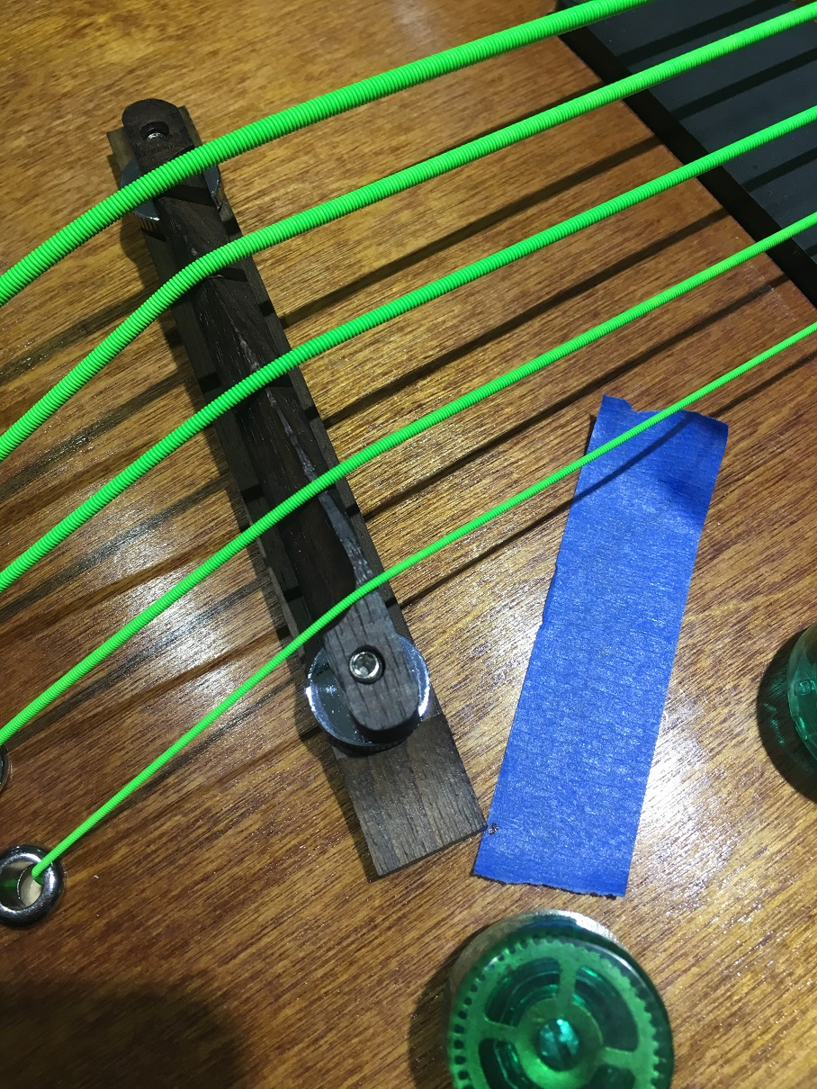

You're going to need the bridge set fairly flat I'd imagine. The saddle already has an angle on it so it shouldn't be too far off. 0.045" string saddle position nearest the neck and the 0.125" string furthest away.

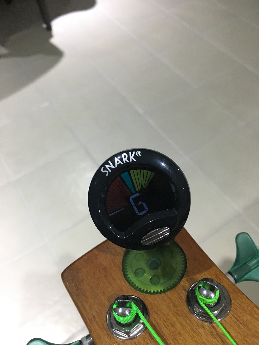

4 Attachment(s)
After adjusting the bridge it is looking better ...
Attachment 36304
Open G
Attachment 36302
12th Fret G
Attachment 36303
Once the G was sorted, I placed tape so that I could remember where it was before adjusting for the E. I only had a 4 string tuner on my phone so focused on this string rather than the low B.
Attachment 36305
This was tricky and after 3-4 hours it finally worked!! That floating bridge is a tricky sucker. I think I might pin it so that it doesn't move.

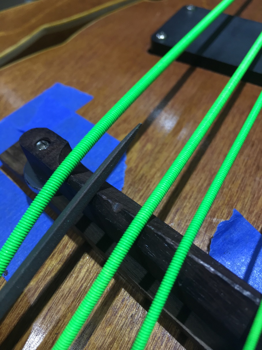

3 Attachment(s)
The pressure from the strings had made slight depression in the timber bridge, but not enough for my liking. I used a blade to mark these lines ...
Attachment 36306
Then used a file to create slight divots in the bridge to hold the strings in place.
Attachment 36307

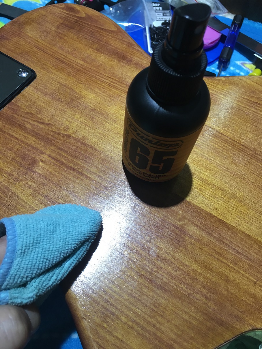

After it was all tuned, it was time to pat myself on the back and give it a good polish.
Attachment 36308

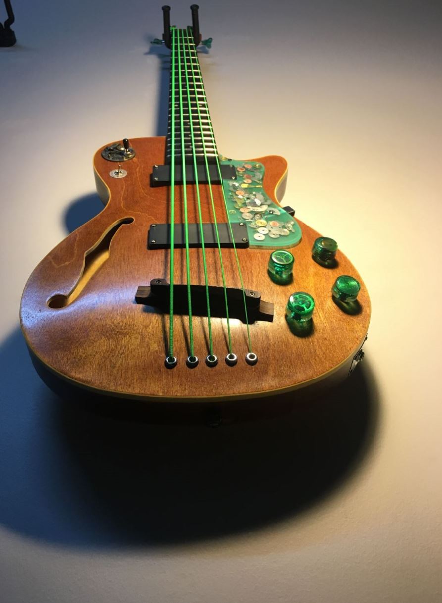

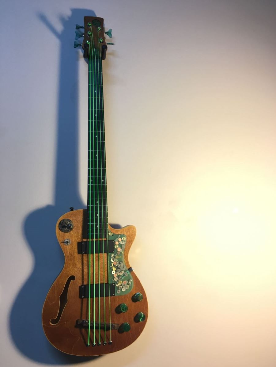

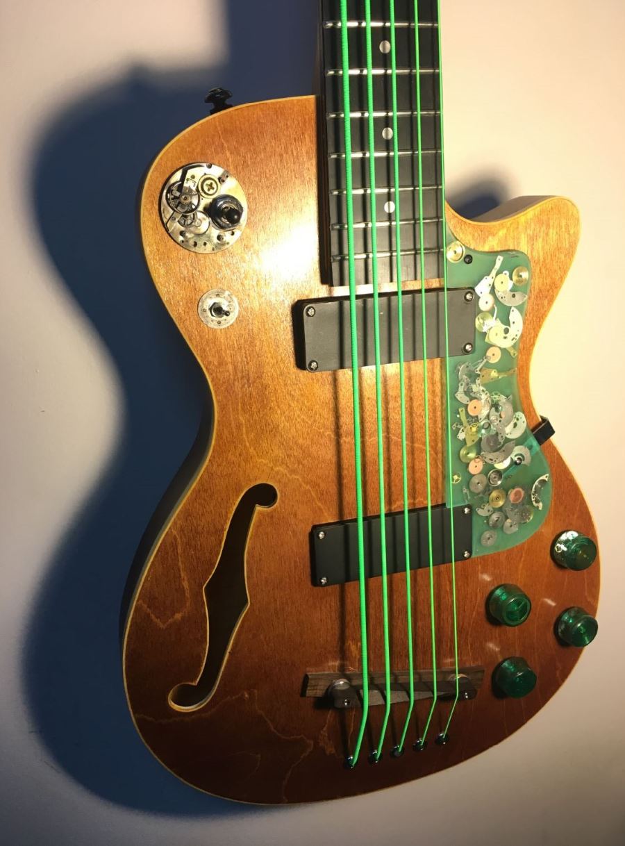

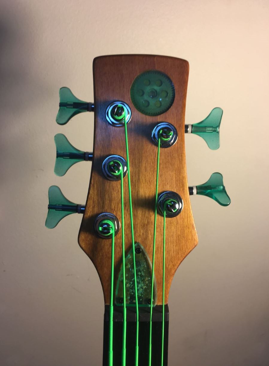

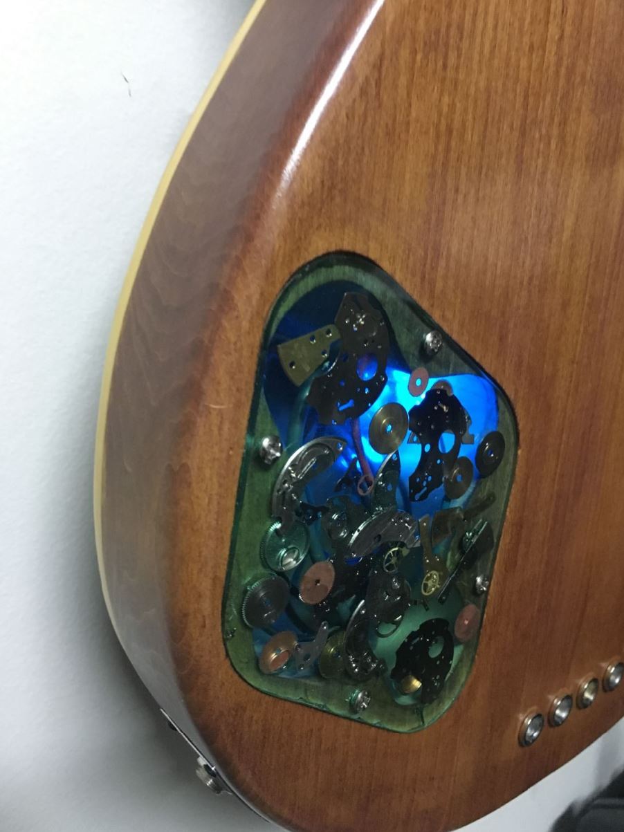

5 Attachment(s)

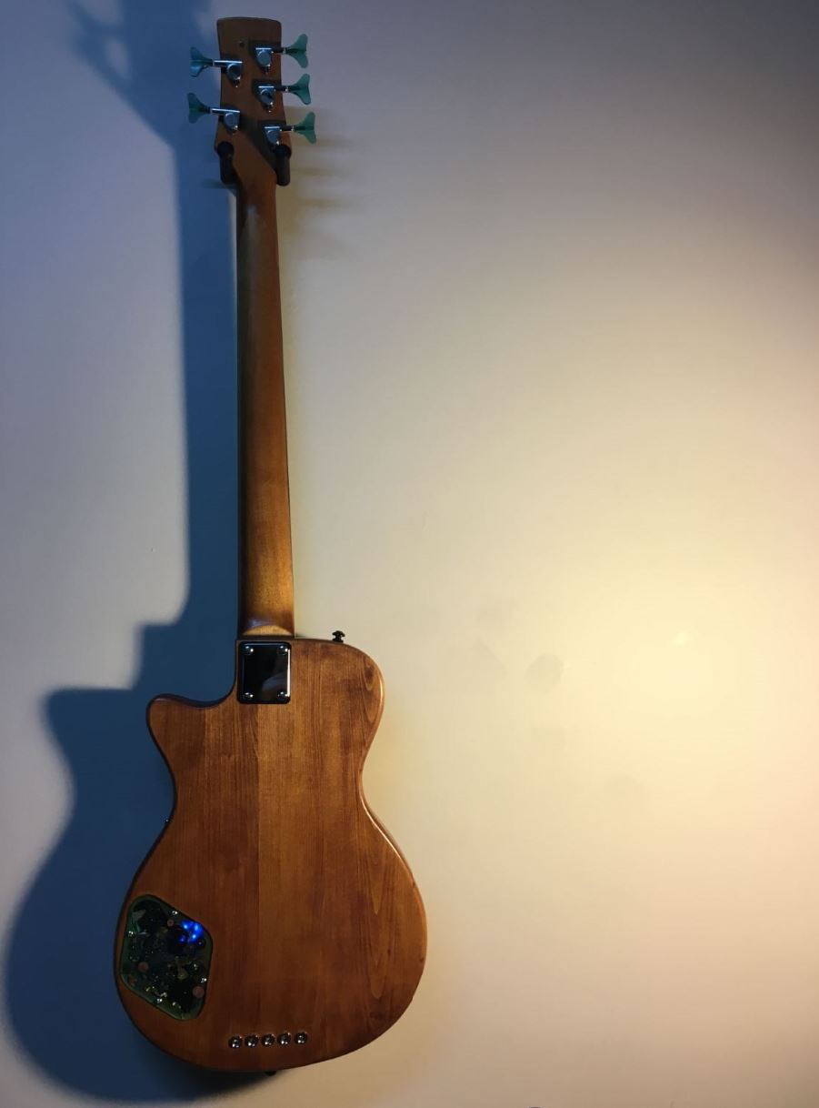

Thanks for coming along for the journey, it has been so nice. Thank you to everyone who has offered support, without your help it would have been much more difficult. Such a wealth of knowledge out there with so many generous humans!!
Here is the finished piece ...
Attachment 36309
Attachment 36310
Attachment 36311
Attachment 36312
Attachment 36313
1 Attachment(s)
One more for luck :)
Attachment 36314

It won't affect the intonation, but you can get too great a break angle on the strings. Especially with a floating bridge, that could make it very unstable. A floating bridge is designed to be mainly pressed down under string pressure. Put too much sideways force on it and its not working how it is designed to work. The kit would be better off with a trapeze tailpiece, but 5-string bass trapeze tailpieces aren't common at all, and certainly there were no cheap Chinese made ones that I could find.
It would be a good candidate for a one-piece bridge/tailpiece. It might mean a small re-jig of the neck angle to get the string height over the body down, and a flattening of the arch top where the bridge would sit, but I'm sure it could be done.
