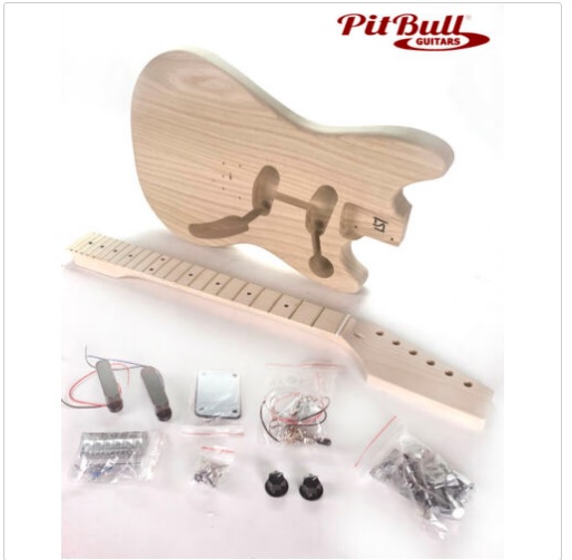

Touch wood, I may be in the Mustang club.
Buy it now on the 'last one' sitting on e-bay.
Attachment 35566
cheers, Mark.
Ha ha[emoji23]
Do it!!
I am quite enamored with it tbh.
It ticks all of my boxes.
Ill be putting it together totally stock first up.
Then later ill be looking for those rAil type humbuckers.
I am even considering mustang switching down the road and then using the current switch hole as a split switch.
However i dont want to get ahead of myself as i really like to play them for a few months so i can become really accustomed to the ergonomics.

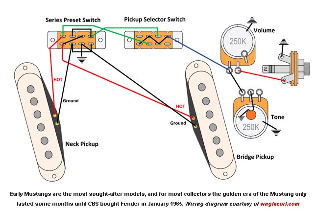

Or something like this......
https://uploads.tapatalk-cdn.com/202...0212015c61.jpg
But with single coil size humbuckers

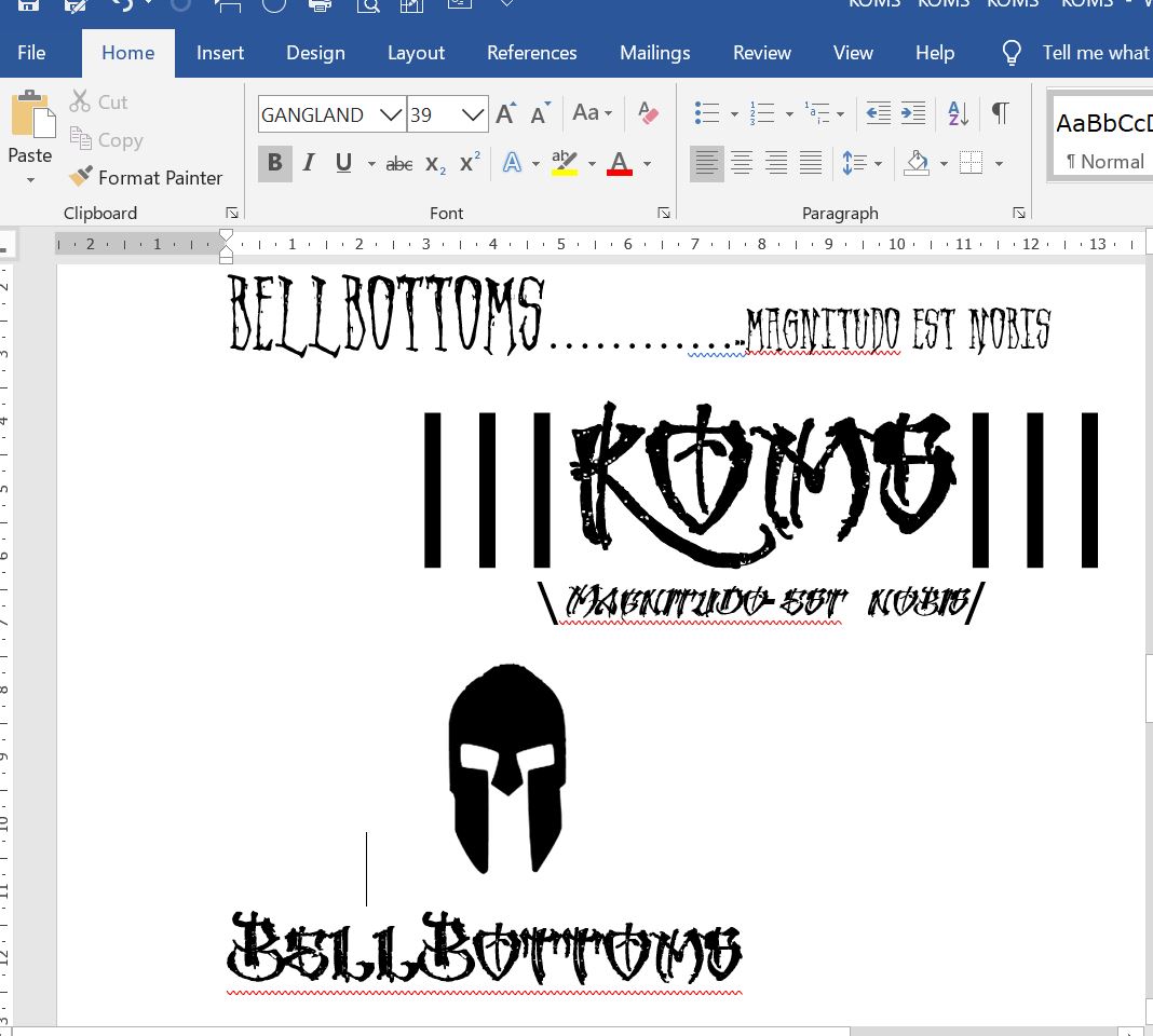

NAMES AND DECALS!
I am going to name this guitar in honour of a special song.
It is called Bellbottoms by the Jon Spencer Blues Explosion.
These guys made a big impression on me when i was younger..and i still love their stuff......when seen live theyre totally bonkers.
a few waterslide ideas..
Attachment 35677
