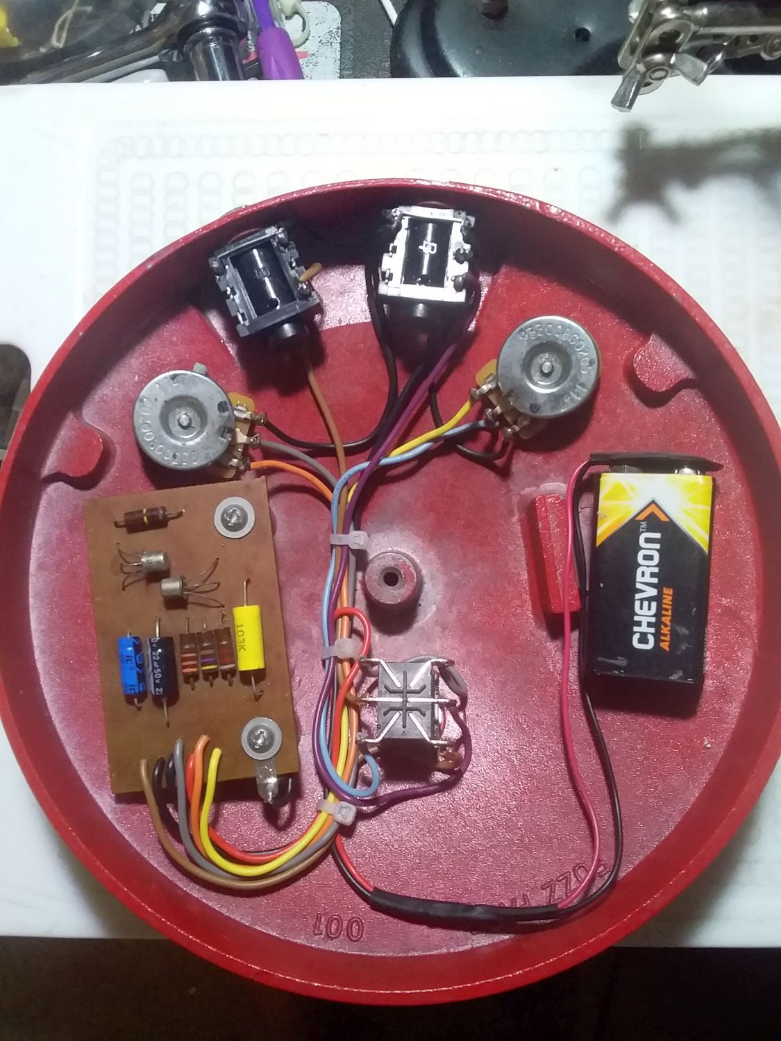

Here's the latest revision of the wiring in my red JD F2 Fuzz Face, the reason why I did the wiring revision is mostly because I found that the wire I had used previously was prone to breaking at the solder-joints due to how thin the inner conductors are, so I decided to replace all the existing wire to improve reliability, here's a pic so you can see how it all turned-out, I used a photo of the insides of a vintage NKT275 Germanium transistor Fuzz Face as a guide:
Attachment 37963
This is pretty close to what you would see if you looked inside a vintage BC108C Silicon transistor Fuzz Face pedal.

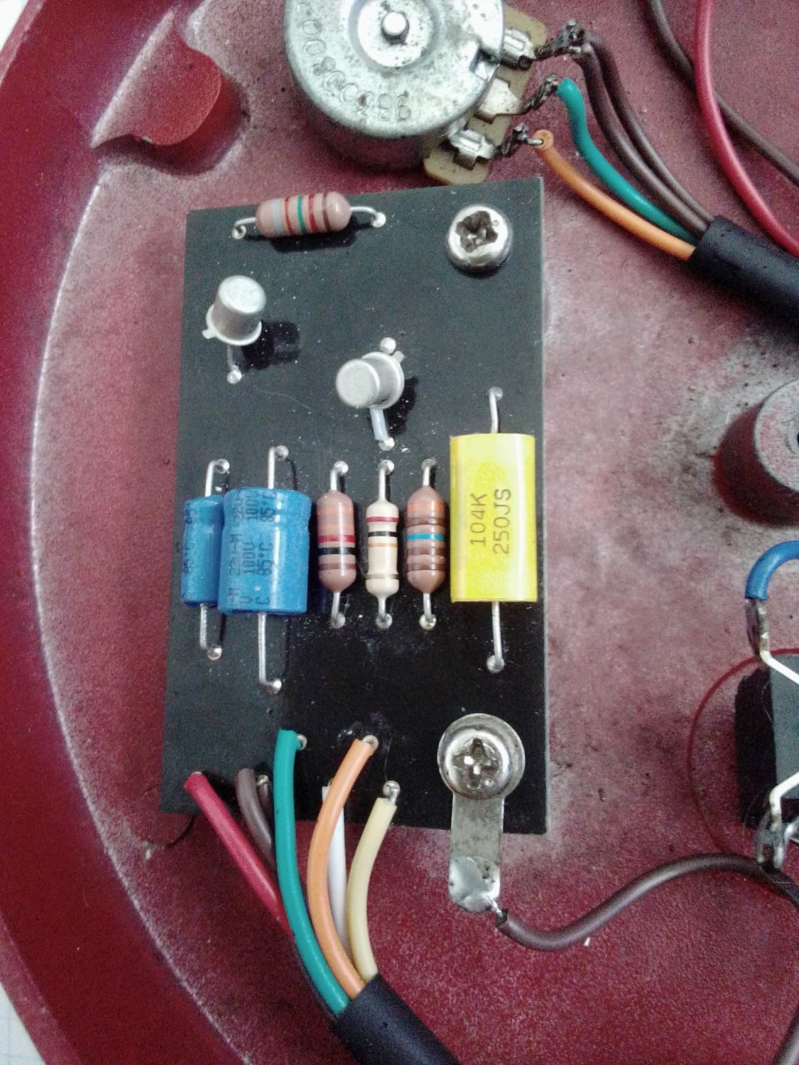

Earlier this year I ordered two new Issue 2 Fuzz Face pcbs online from Pigeon FX in the UK, I used one of them to replace the original Issue 1 Fuzz Face pcb I had in my red JD-F2 Fuzz Face pedal because I noticed that the copper pads on the undersize were starting to lift, last year I bought a set of 8 CDIL BC108C NPN transistors on eBay and I went through them and picked two of them with the highest gain of the lot, one had a gain of 635 which I used for Q1, the other had a gain of 660 which I used for Q2, I paid a visit to my local Jaycar Electronics shop and bought packets of 1W/5% Carbon Film resistors containing two resistors of the following values, 330 Ohms, 470 Ohms, 8k2, 33k, and 100k.
Using a 330 Ohm, 8k2, 33k, and a 100k 1W/5% Carbon resistor, the three capacitors on the old Issue 1 pcb, and the two selected CDIL BC108C transistors, plus an extra 1nF/100V greencap I soldered to the underside of the new Issue 2 pcb in parallel with the 100k resistor, I re-built the Fuzz Face circuit, I used some short pieces of clear heatshrink to insulate the base leads of the two transistors so they wouldn't short-out against the other transistor leads, this was necessary because the solder pads for the transistors on an Issue 2 pcb are configured for BCE transistor lead layouts rather than CBE.
Just recently I ordered a set of two new TRS Cliff Jacks from Evatco, they arrived in the post yesterday and I installed them in my red JD-F2 Fuzz Face pedal.
So, now, my red JD-F2 Fuzz Face is as close as I can possibly get it to a vintage Silicon Transistor Fuzz Face, once my mobile phone has finished charging I'll take a couple of pics of the insides and post them here.....stay tuned....
Here we go....
Attachment 44084
Attachment 44085

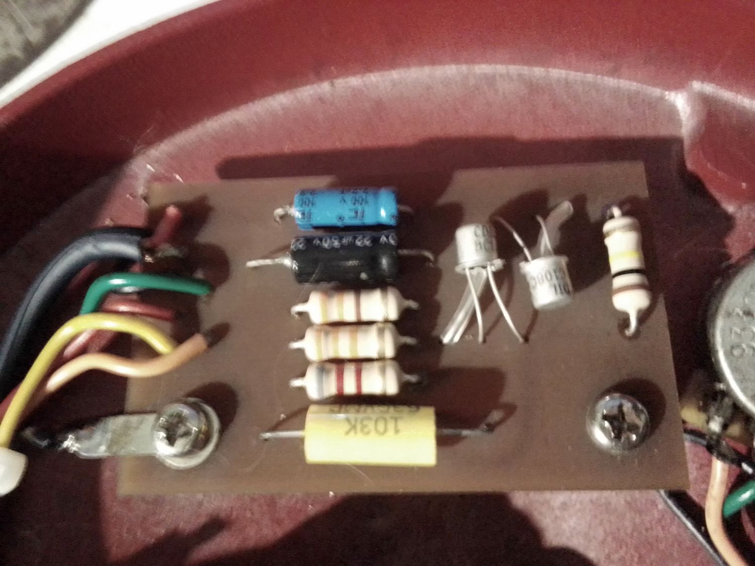

Last year, or maybe the previous year, I managed to buy a second-hand Fuzz Face pcb on eBay, it originally came out of a Jim Dunlop JD-F1 Jimi Hendrix Fuzz Face, the turquoise one, and I installed it in my red Jim Dunlop JD-F2 Fuzz Face, the JD-F1 Fuzz Face pcb uses two BC108B NPN silicon transistors, it also includes a couple of surface mount trimpots, and some other surface mount components on the underside of the board, I'll post a pic of the insides shortly.
Okay, here we go:
Attachment 45066
And, a closeup of the Jimi Hendrix JD-F1 Turquoise Fuzz face pcb I bought on eBay:
Attachment 45067
