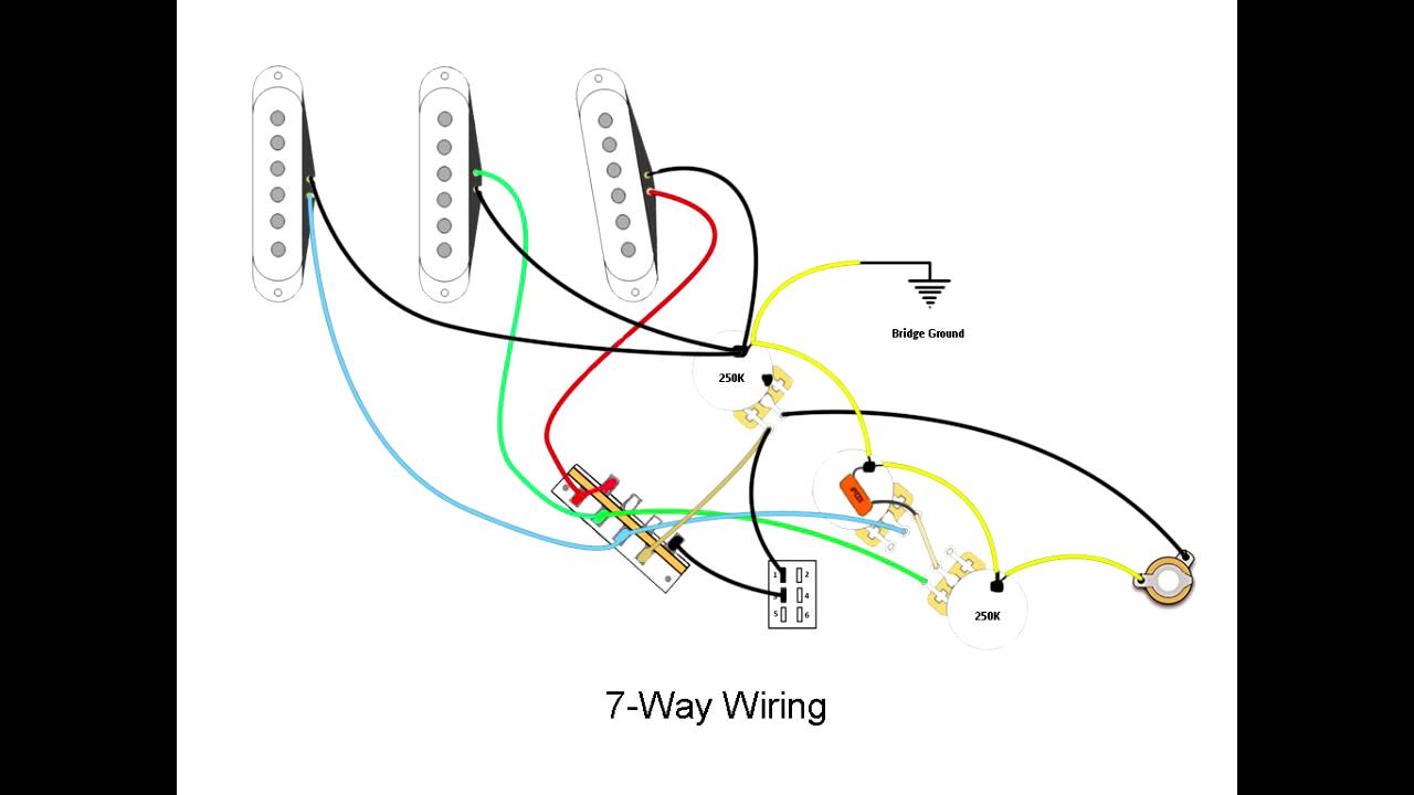

As an alternative, you could get that plus all 3 pickups at once doing the 7 Way Wiring Mod. Pretty easy with the addition of a DPDT micro switch.
Attachment 29760
My ST 12 string has Gibson Explorer III wiring. You need two three way switches instead of the standard 5 way switch, but you can get any pickup combo.
BTW Neck & Bridge is a great sound for a ST, all three pickups at once was kind of underwhelming.
