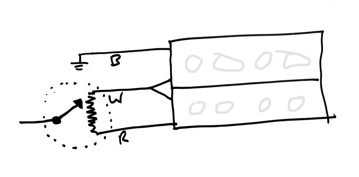

Wiring up GFS MMB pickup to Belcat Pre Amp
Having lots of fun trying to work out best way to wire up on blend pot that comes with the eBay 'Belcat' pre amp.
Kit supplied PUP had 5 wires where one was outer shield and theoretically should have allowed for front coil, rear coil isolation via the blend pot, and when centered it was in series as a humbucker. Played around with that PUP over a few days and could never get that to happen plus the wires were so thin they broke off at solder joints way to easy.
GFS replacement arrived a couple of days ago and this one is 4 wire but technically 3 as the outer shield does not share a signal with the 3 inner Red, Black or White wires. This probably means I can only coil split in one direction. When measuring things the rear coil lines up pretty close to same position as bridge J Bass PUP (10 mm further forward) whilst front coil is about 34 mm further towards neck. At the moment it seems I have wired in series as nothing is happening on either left or right side of center detent. Still sounds quite meaty and happy with that sound but seeking some guidance on which wires to swap around as my patience is almost at an end. At this stage I am leaning towards splitting to front coil as hopefully that should still retain more lower mids and maybe sound a bit like P Bass, and if I want J Bass sound I already have one of those.
Here are a couple of photos and diagrams and happy to wait for some feedback and guidance before heating up the soldering iron again. Last handwritten diagram is where things are at...
Thanking you in advance.
Cheers, Waz
The tap wire is connected to the join between the two coils. You'd normally switch this to ground if you wanted to do a coil tap.
I'd only use one set of balance pot connections, have white and red on the two outer connections and have the wiper connection going to the volume pot. The balance pot then selects a balance between the fully single coil and fully humbucking sounds. You do have the balance pot resistance linking across the second coil, so there may be a very slight drop in volume, but I can't think of any other way to make use of the balance pot.
Attachment 27616
If you find that you want to use the other coil for single coil, then you will have to swap the black and red wires around. This will reverse the phase, but as there is only the one pickup, then it's not an issue.
Just leave the other set of pot tabs unconnected, or just join all its tabs together and connect to ground for completeness.
Obviously the black (or red if swapped) wire and cable shield get connected to the pot back and ground as normal.
Thanks Simon.
The blend pot has been a source of much confusion and frustration. Would work ok for 2 PUP situations but not quite so easy to find the best combination for these MMB PUP's.
Scott (Weirdy) has also put forward another idea and will have a look at both. Yesterday I was that fed up it was just going to remain in series with blend pot not functioning. At least now I have a couple of fresh ideas to explore.
Thanks again.
