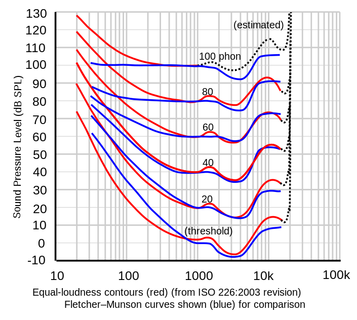

Also, look at the Fletcher-Munson/ISO 226 curves for human hearing responses (it also varies depending on the loudness of the sound):
Attachment 27190
The human ear is most sensitive to sounds in the mid-range, and far less so to bass and treble frequencies. So if you scoop the mids, then you are reducing the frequencies that the ear hears best, so the overall volume has to come way up to compensate, which means the bass and treble are then far too loud.
