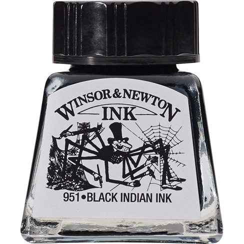

On my J Bass I bought some Black block fret marker stickers which are basically very thin vinyl sections that were stuck over an already Tru Oiled maple board with then a few more diluted TO coats on top to keep them in place. This could be an idea for the glossy 3,5,7,9,12,15,etc markers. For the matte black look underneath, Tony VH2580's idea of a very dark full strength dye or stain done first and then same stuff added to ebony timber mate to fill the grain but this will require some sanding to get a really smooth surface. A Satin Poly over the lot might work to seal things and retain some of the matte look.
