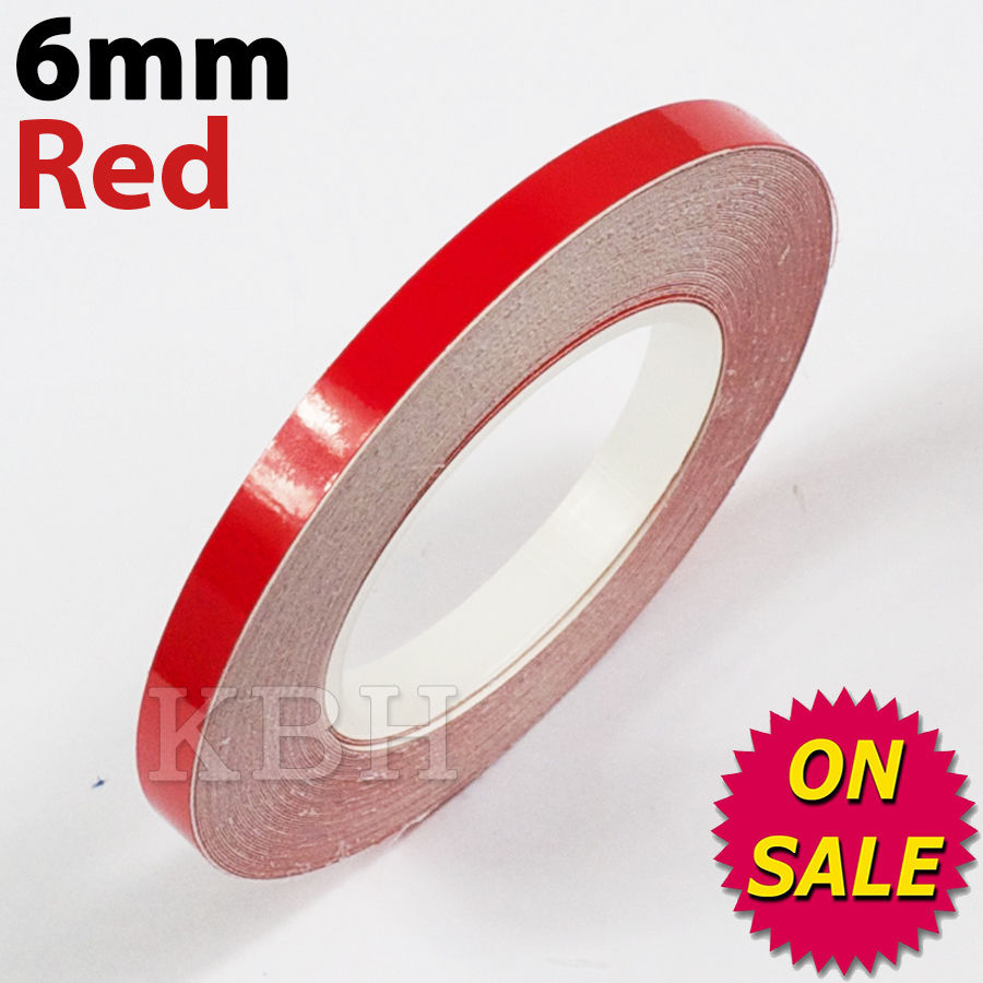

@ Kick, pin striping would be the easiest..... maybe something like this? http://www.ebay.com.au/itm/6mm-x-9-8...3D322197999740
Attachment 17496
Thanks Zandit75! Those bindings looks great but as Waz is saying, it would be a challenge for me as a first time kit builder.
