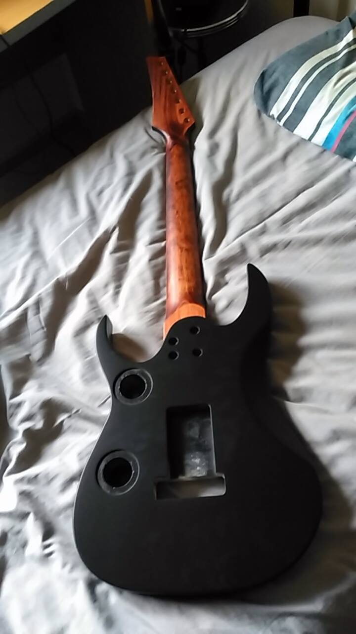

I have finally finished sanding and painting and I have put on my clear coat and I'm ready to assemble. I have a screw on neck but I have also bought some glue. Is gluing and screwing the neck necessary or is that just overkill. If I were to glue also would I screw it before or after gluing.
Attachment 19850
Hi Jack,
I probably would just go the screws. Gluing it will definitely be overkill and it also means if you have to do something to the neck, you'd need to steam the glue joint apart, which will stuff your finish on the body.
The screw joint will be more than sufficient for your kit and gluing will only make life harder down the track.
I like the look you've got going there, what have you used on the neck?
Cheers!
That's all very relieving.
