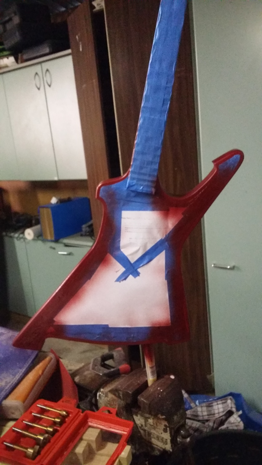

Tuesday arvo I slapped on some Zinssers, let it dry, sanded back, gave it another coat and let it dry overnight.

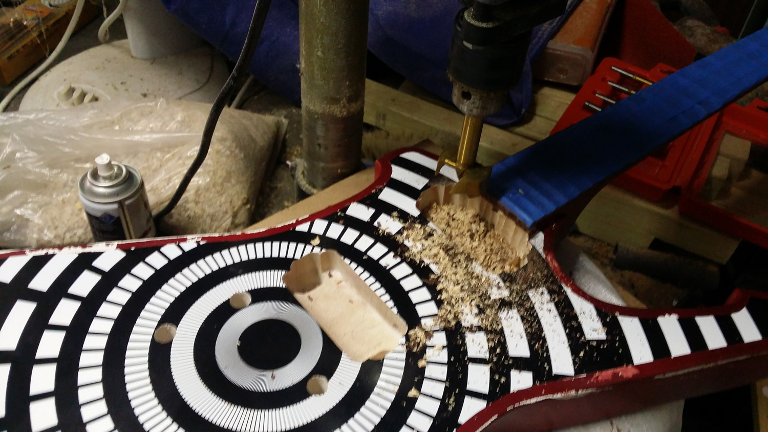

Friday I pick up where I left off. Nearly. My pickup rings arrived in the post on Thursday, and as I'm figuring out which is the neck and which is the bridge, I notice that the fretboard is poking halfway into the pickup cavity (something I was plainly aware of well in advance from reading other EX-1 build diaries, but apparently forgot until after I'd glued the neck.)
So, not wanting to run a router over it without a some sort of jig/guide, and not wanting to invest the time to creating said jig/guide - I grab my forstner bits and drill out a quarter inch worth of fretboard/neck. I used a small one for the initial drilling, and a bigger one like a router bit to smooth off the edge.
