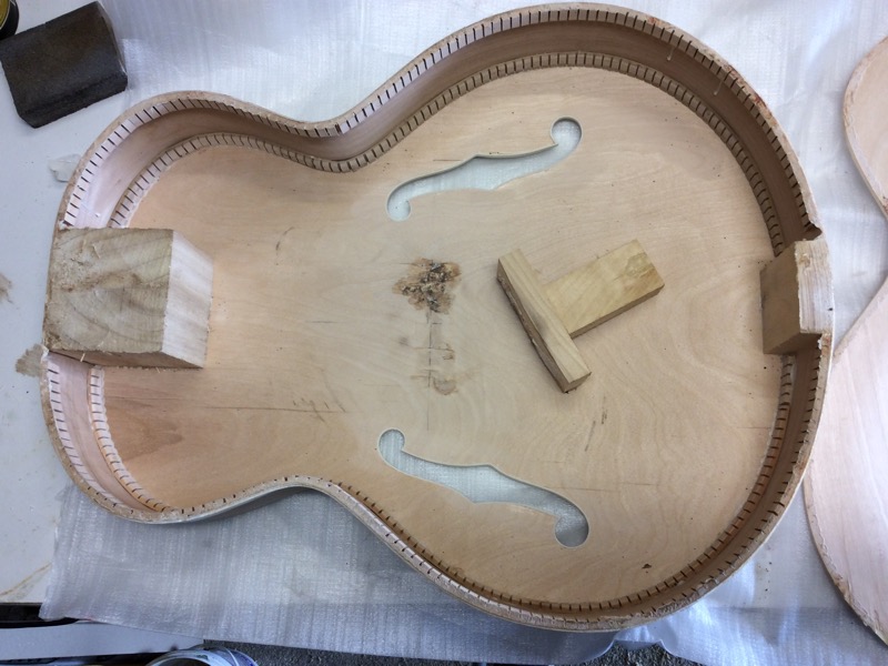

Update pics:
Attachment 16289
The back has come off, it was almost a shame to start by pulling a perfectly good guitar body apart. The inside bridge reinforcement block has come off, and some of the ply with it. It won't be seen, but I've partially filled the hole with sawdust/super glue to stop any further delamination.
Attachment 16290
The back had a few chips that needed re-glueing. The big key to getting it off gently is heat. Sometimes it pays to live somewhere that has 40 plus degree days during summer.

wow Andrew first time I've seen a semi hollow the back come off the body !
Good to see what the inside looks like. Looks like you have it nicely glued/clamped.
Love the foam mini strat, has it been cut out of a block of foam ?
Hi Wokka, I need to replace the support block with sort of brace, similar to an acoustic. The "mini" foam strat has a 60cm scale length.

This prompted me to look for the construction methods used in archtop guitars. I came across this page http://www.acousticfingerstyle.com/ArchtopGuitars.htm which has some interesting facts about the different speeds of sound in wood along the grain vs across the grain, and the reason archtop guitars normally have f-holes at the sides (to decrease sustain), rather than a round sound-hole.
Now a lot of that design philosophy doesn't apply when you are using laminated woods, as you've got plies running at approx. 90° to each other, plus the glue holding the plies together. So I'd assume the result is a guitar with less acoustic projection and a longer sustain.
I presume you are going to go for a Gibson archtop style simple parallel bracing?
