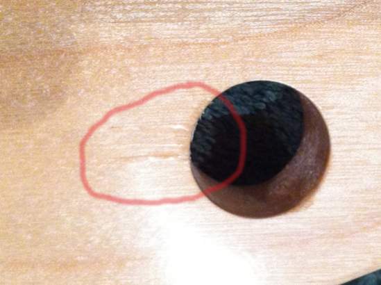

I need some help with paint finish. I've notice there are some cracks in the clear coat around the machine head holes (see image) I’ve got no idea how this happen I notice this after I wet sanded and polish and now it looks like it’s flaking a bit. Should I re gloss the head stock again?Attachment 656
Wet sanding seep perhaps? What clear are you using, how was it applied, how many coats, and how was the surface prepared before and between coats?
