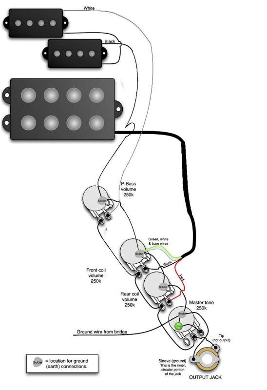

Lots of options with the 4 pots, just depends on what you're looking for:
- 3 volumes and 1 tone.
- 2 volumes, 2 tones (optional push/pull humbucker coil split, optional push/pull humbucker coils series/parallel).
- 2 volumes, 1 coil balance/blend (variable coil balance/split for the humbucker), 1 tone.
- 3 way toggle, 2 volumes, 1 tone.
etc.

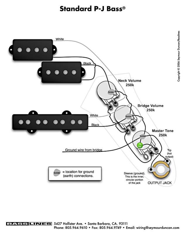

I can find wiring diagrams for P/J basses and similar things, but nothing with 4 x pots....without all the push pull, splits, parallel, series stuff.....or a master tone.
I have found a couple of diagrams that use three pots, they get me close to what I need.

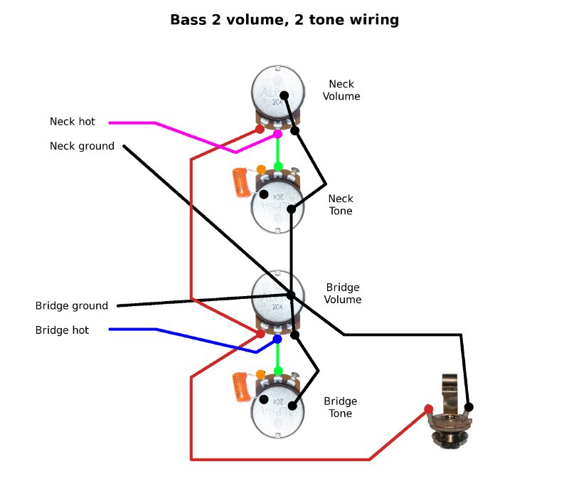

1 Attachment(s)
As promised, I think this should have you covered:
Attachment 424
Just connect the ground wire for the bridge (as opposed to bridge pickup) to the same common ground point on the back of the pot (in this case, back of the bridge volume pot).

Wok and Wierd, you guys rock....thank you so much.....I note the bridge tone pot earth wire is to come....but where would I put the earth wire to go the bridge itself as opposed to the bridge pickup.......from one of the tone pots?
