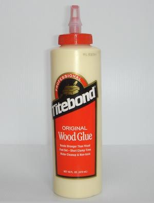

Cheers guys on the glue thing. It's Aquadhere PVA wood glue. Is Titebond a brand of glue? I'll get down to bunnings and look for it. Do I steam the neck off from the back of the guitar?
Hey Dale, don't think Bunnings sell the titebond, yes thats the brand, get the red label like the picture. You might need to call around for a more specialised hardware.

http://www.pitbullguitars.com/wp-con...tebond-500.jpg
Hi Dale
Masters or Carbatech supply the RED labelled "Óriginal" Titebond. You MUST use an Aliphatic glue. I think Gorilla also make an Aliphatic glue.

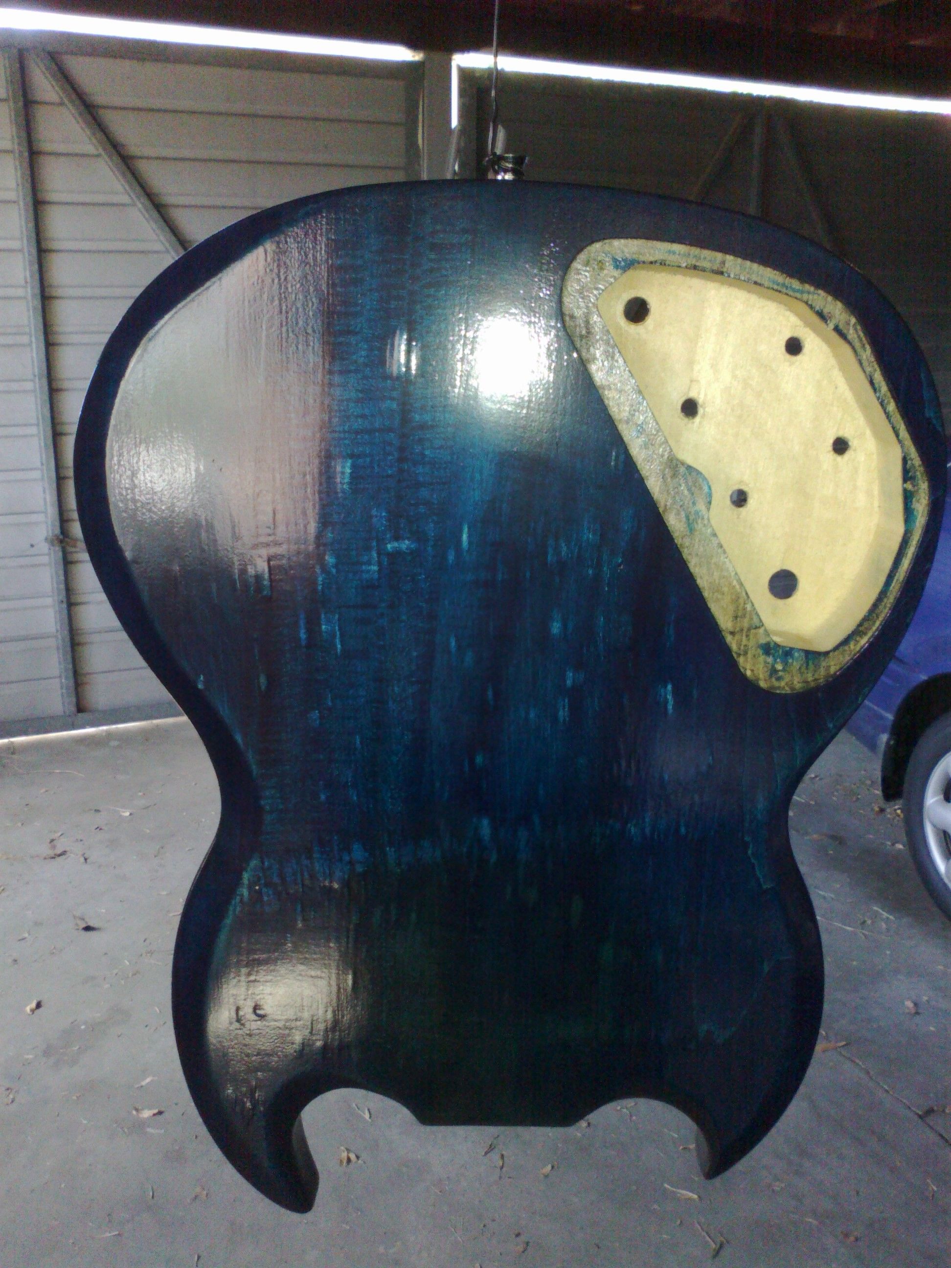

Hi guys, I got the neck off, and while it is off I thought I'd do something with the headstock, I also put a few coats of gloss clear on the body. It was marking too easily, so I'm hoping this will make it more scratch resistant.
Oh I got some Titebond as well.
http://www.pitbullguitars.com/wp-con...9102014168.jpg
http://www.pitbullguitars.com/wp-con...9102014164.jpg
http://www.pitbullguitars.com/wp-con...9102014166.jpg
