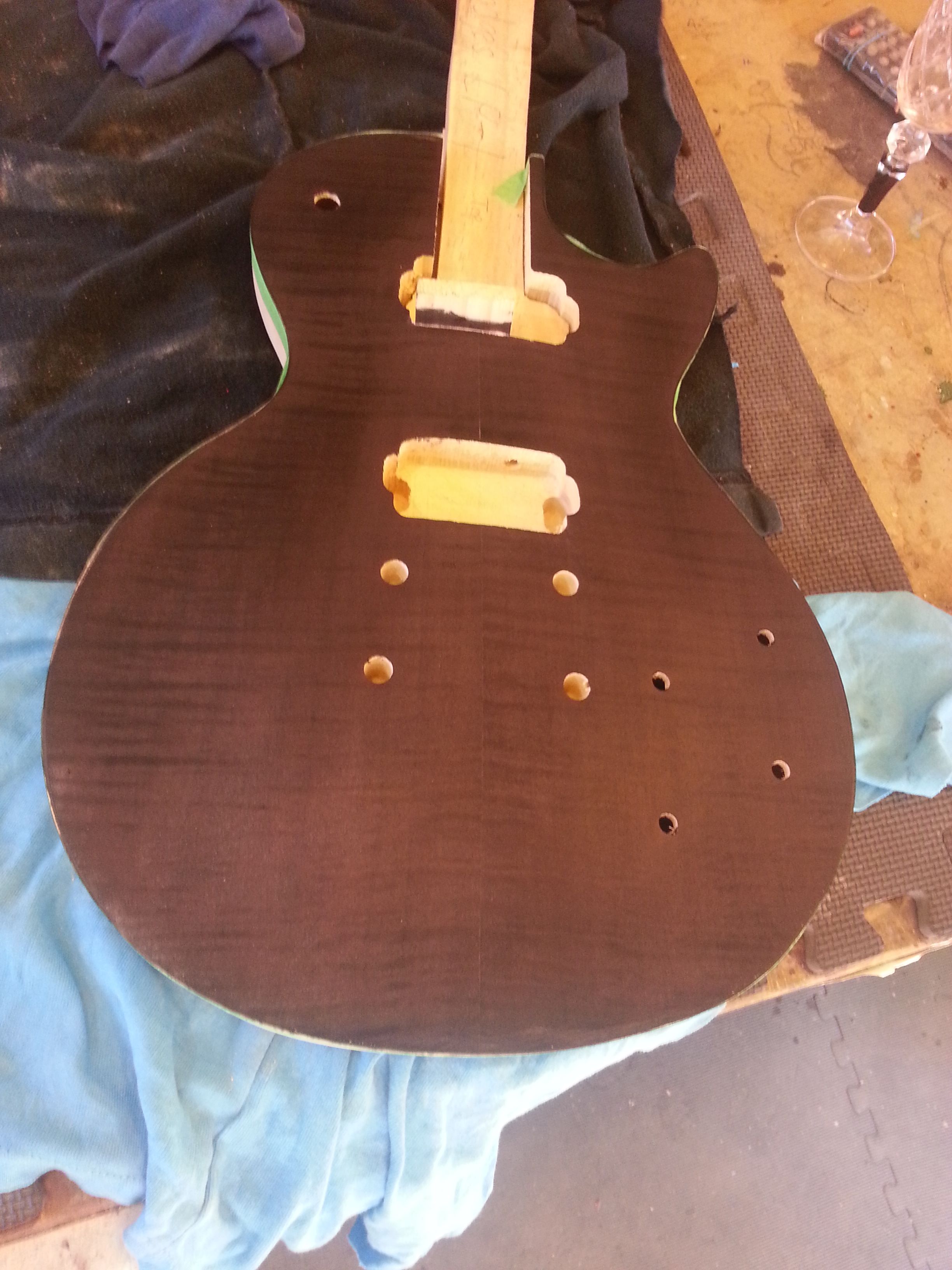

TO me, the neck appears to be lined up on the lower side (short rout), not the longer side of the rout - hence a larger gap along the 1st string to fret board. Also as Gavin said. Maybe bite the bullet Adam and get him to send it back and replace the kit. whilst I'm here.. do any of you guys have a solid tail bridge that has a string spacing of 50mm to a max of 52.. can swap a brand new solid tail bridge that is 54mm string spacing?

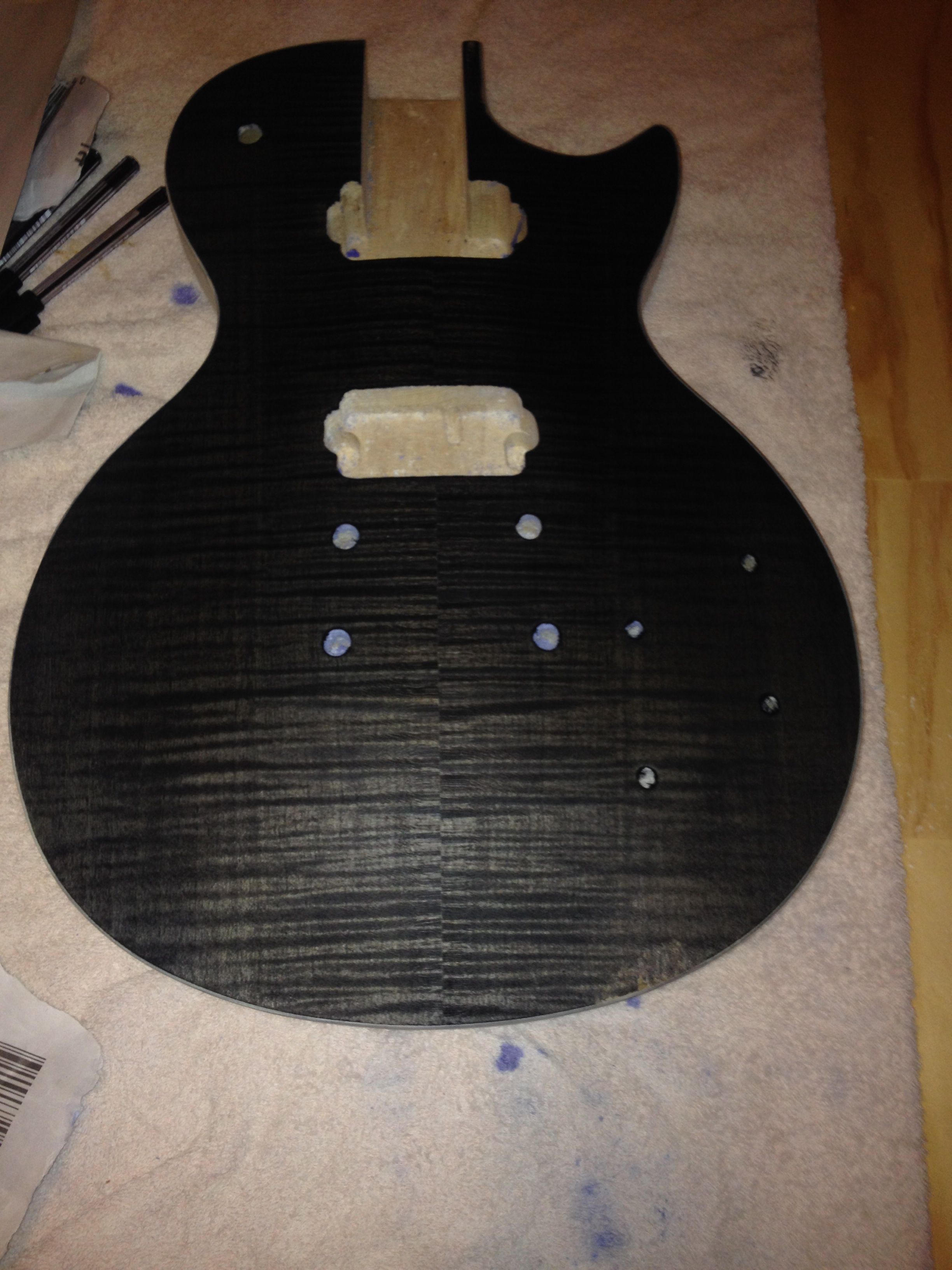

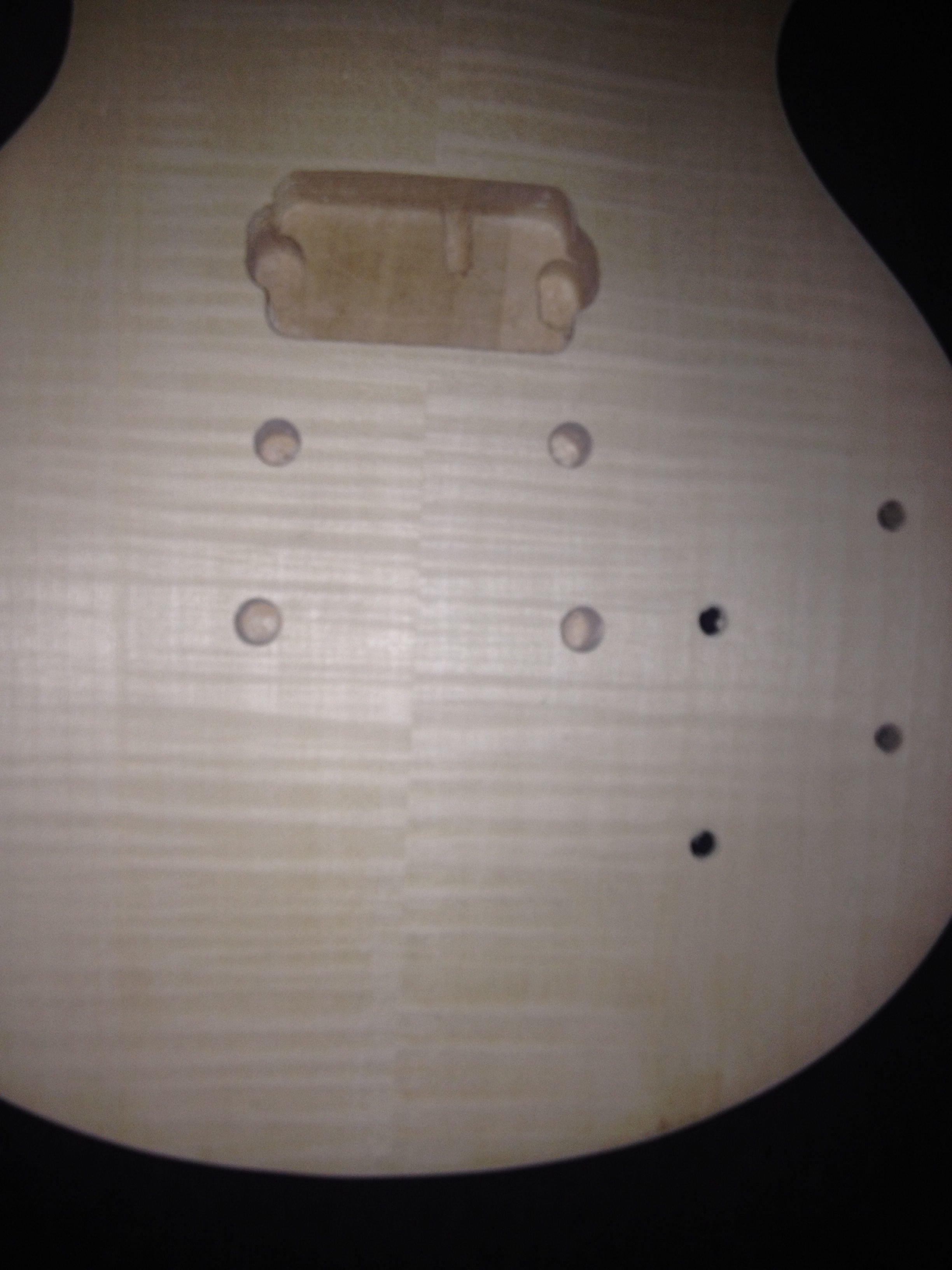

Hi guys here are some preconstruction pics where it is clearly gis able that the holes are not in the correct place for both bridge and tail

that neck rout appears to be off center line to me,also the holes dont appear to centered there either.

I think the neck route looks ok, they are off centre as the fingerboard hangs over the heel on the right side. I can see the bush holes to be in a slightly different position to mine, the bush holes don't appear to be perfectly centred but the bridge pup route may be in the wrong position too to give this effect.
