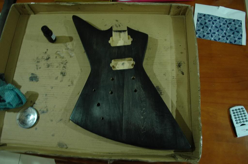

My next mission was to sand the neck and begin applying the Wudtone. After some advice from DB I have started to use the BMW on the neck. I've done the first coat, I'll have to leave it a few days before the next one, I should have enough Wudtone left to do one more Deep colour coat before I apply the Base coat.

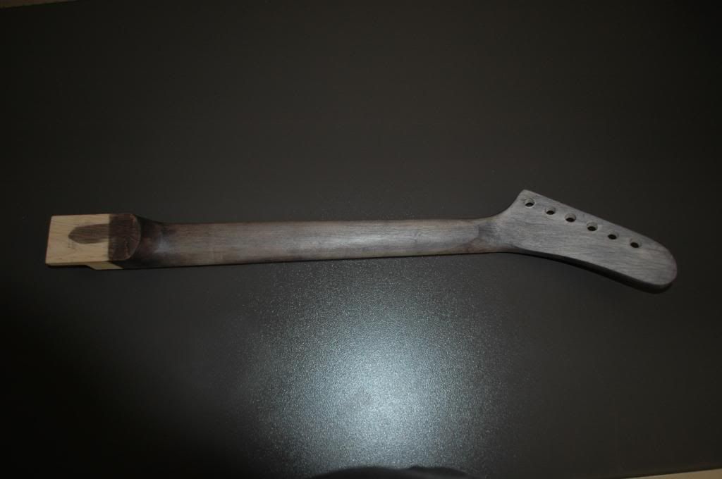

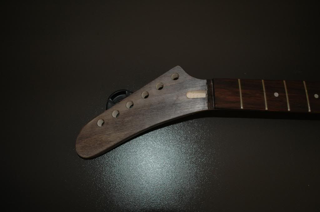

Here is a pic of the headstock with the first coat of Deep colour. It is a bit darker than the photo shows. I'm not a very good photographer :(
http://i1279.photobucket.com/albums/...ps00567993.jpg

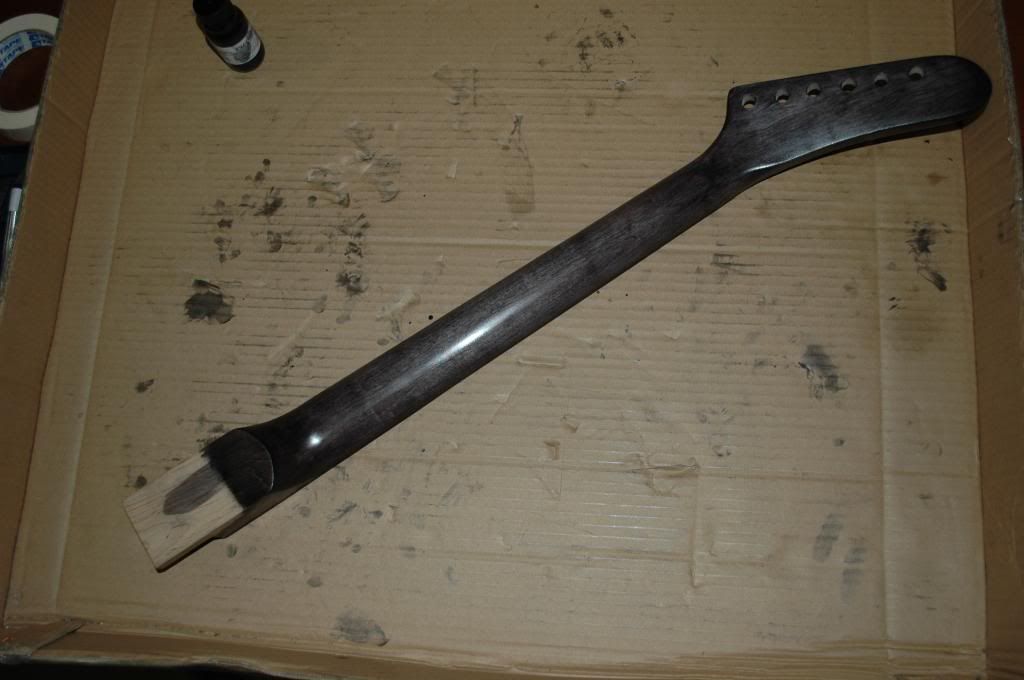

A pic of the back
http://i1279.photobucket.com/albums/...pscb8f5270.jpg
I was thinking that with the neck, I might go for a bit of a burst on the back. It all depends on how dark I can get it. Yet again, time will tell. :)
