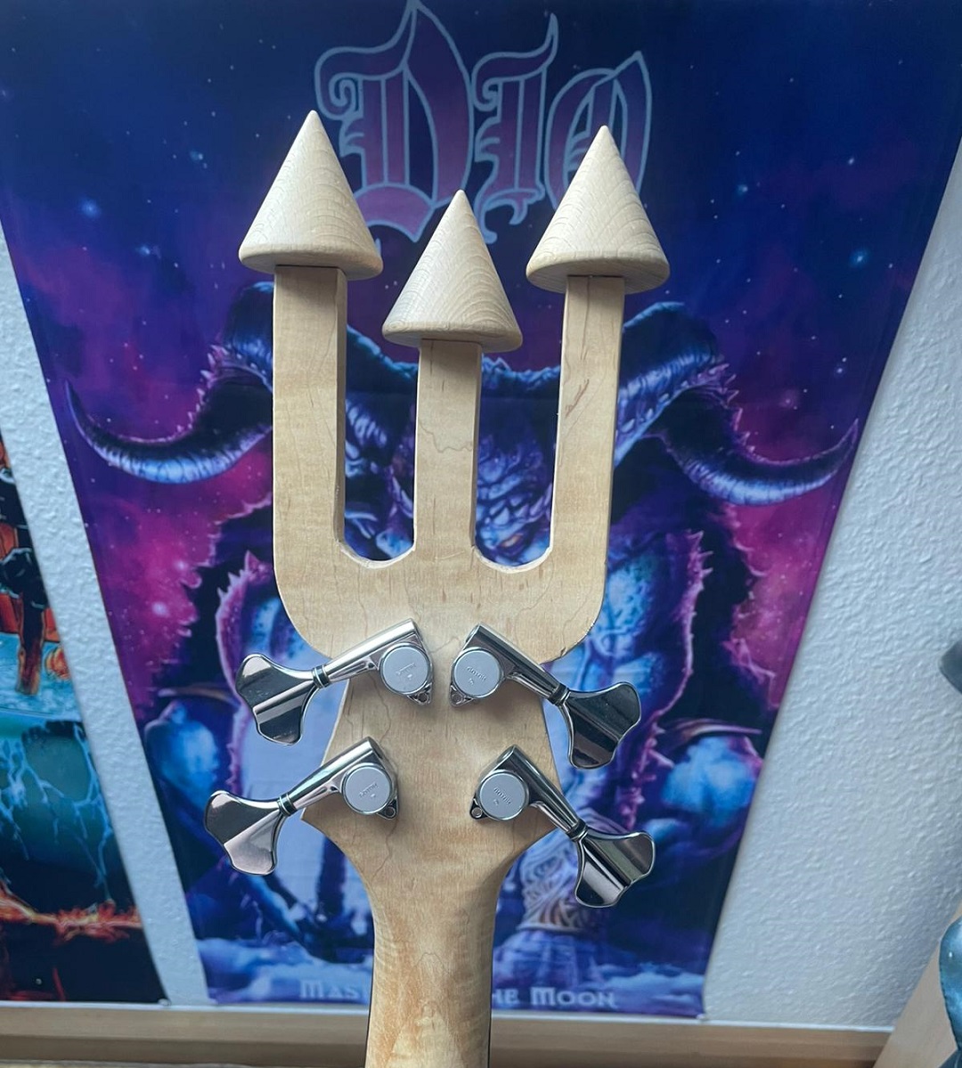

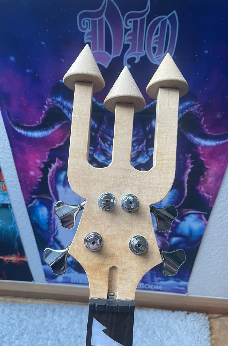

I problem I do see is that in post #6 the two lower tuning pegs are in the wrong way! I'm sure they need to be fitted so that the string tension on the posts pull the post gears towards tuning peg gears (otherwise the gears may pull apart and slip).
