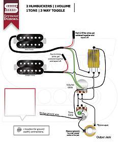

The wiring is also done and wasn't too much of a problem, since some of it was already done. Hardest part was just figuring out what was left to do.
